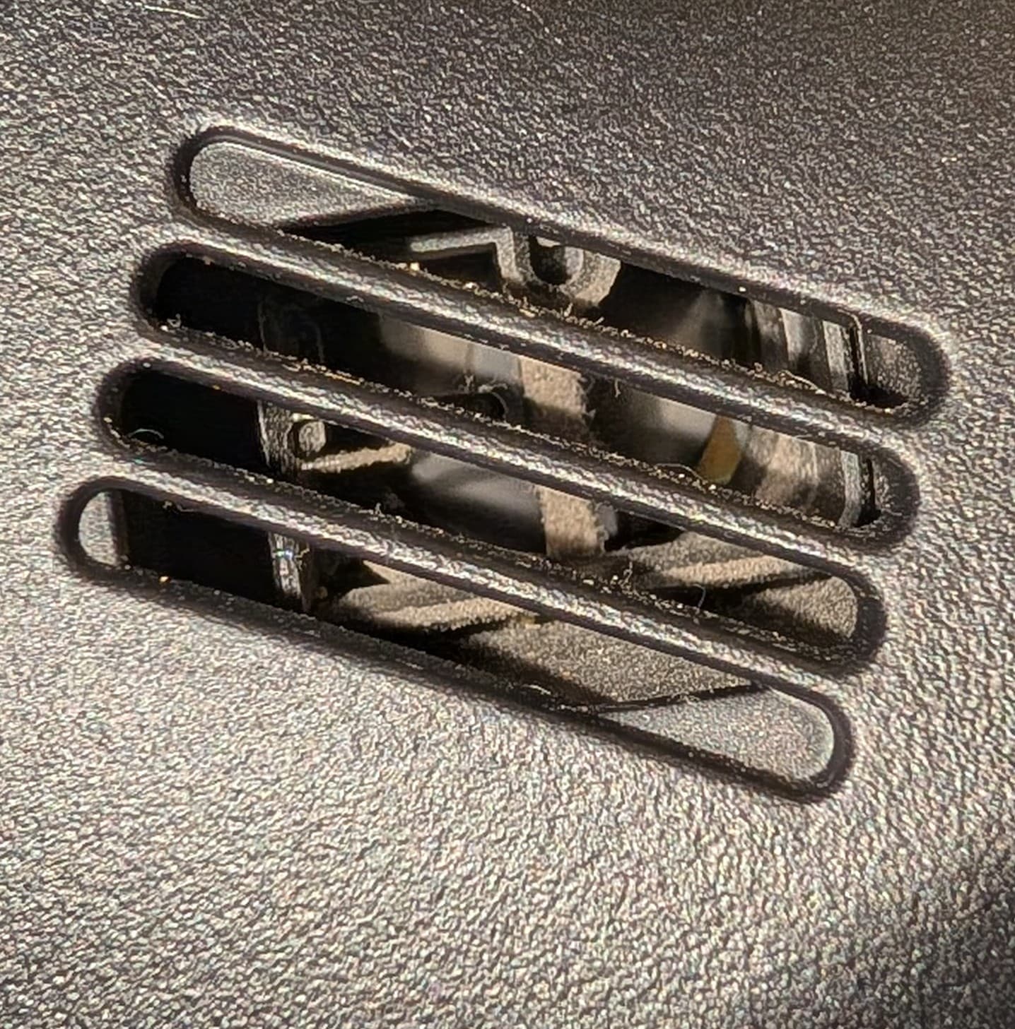

I looked into this some more and you’re right, but this particular XLT had an upgraded package with leather interior and SYNC 3 so it also came with auto climate control. I’ve been looking all over for the location of the cabin temperature sensor but I can’t find anything… Is the temp sensor integrated into the HVAC module itself?
The temp/humidity sensor in behind the little slits on the right of the IPC trim piece. Down by the Key slot or push start button.
Oh okay I see the slits! How do you find this stuff!? I searched all over the internet last night trying to find that, I even key word searched the entire workshop manual and couldn’t find anything. Do you know the actual name of that part? I have a feeling my PIU doesn’t have one so I will have to buy one to work with the auto HVAC but I can’t find that part number or name anywhere

Many thanks :folded_hands:t2: What do you make of this? I can hear what kinda sounds like a fan I think, but I’m not sure if it’s just electric buzzing noises from the ignition being on. Maybe you can tell from the photos
Yup, it’s in there.
Hell yeah! I wonder why they would put that in a manual HVAC system. Not complaining though, that’s great news

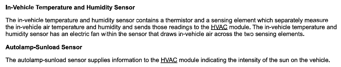

It because of the humidity sensor. It will turn on the AC if it needs it so the windows don’t fog up.

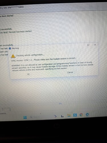

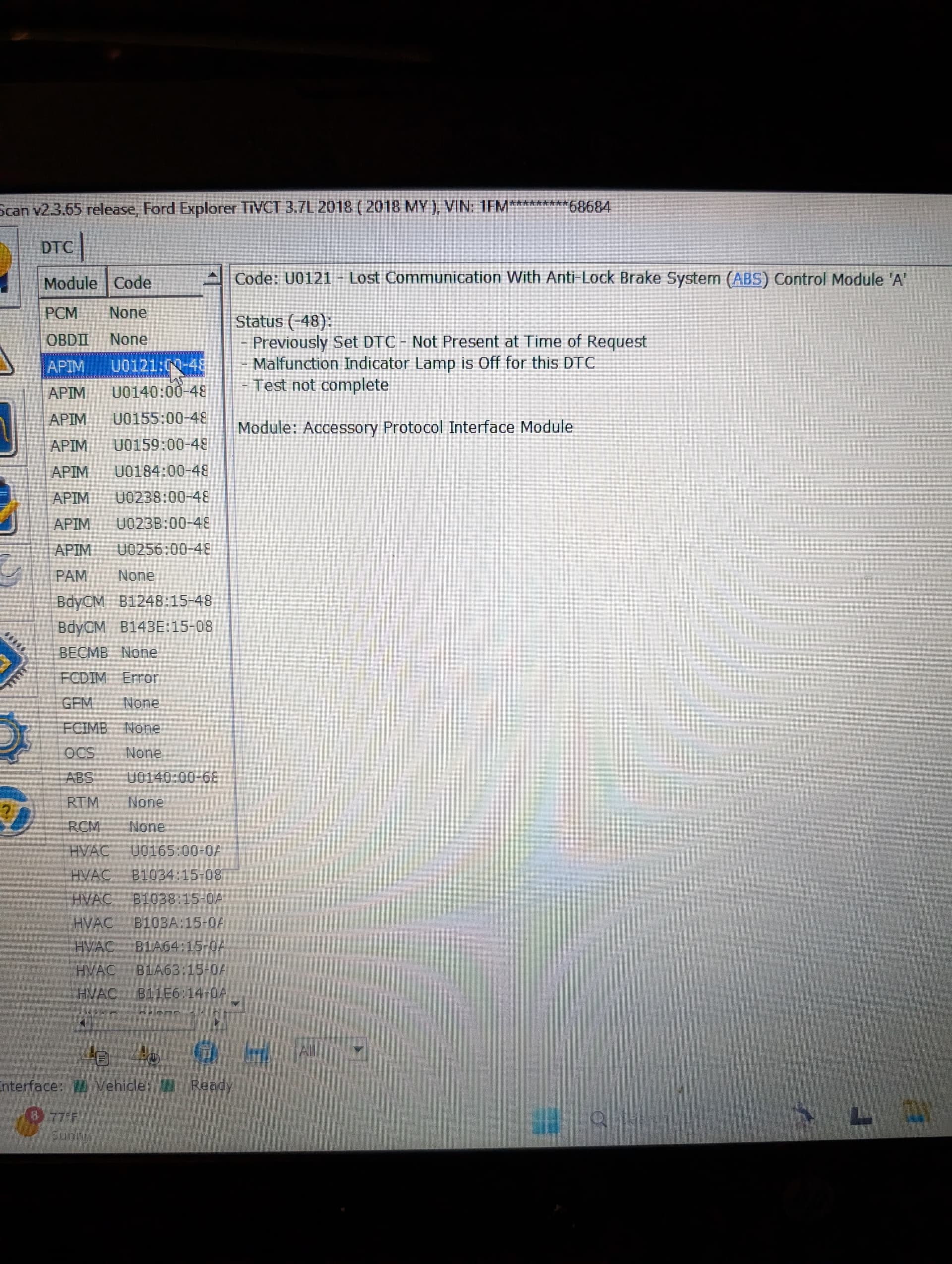

So much for plug and play. Nothing works right and I don’t know how to fix it because FORScan is telling me it will damage my modules. But right now the APIM and HVAC modules aren’t communicating with anything. Please help
Did you create a completely new vehicle profile (and not load an old saved one) like the FORScan dialog said?
