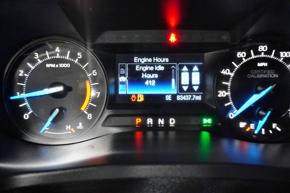

I don’t remember if you have the Type 2 display but if you do, you can get some nav info in the right screen.
Is this the type 2 display? Maybe I need to get rid of the auxiliary button menu on the right side somehow
That is the Type 1 display. There are no nav options for that IPC.
