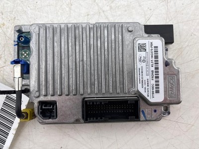

Do you have any insight on the 14G370 being on one side vs 14G371 on the assy number on the other?
This one for example.
That is correct but a non- nav unit.
PBK is non-nav
PCK is nav
Would a PCH also be nav? I’ve seen a couple of those.
Yes. That’s probably the 370 number, but good. It should be equivalent to the 371-CDF.
It is, I can’t find many 371s. Actually the PCH I saw was the same one you linked from Canada (trying to avoid import fees).
There’s so many different 3 letter endings, how do you know which is nav vs non-nav?
I tried opening some up Asbuilt data but I don’t know how to decipher the data codes to see if it came with Nav or not
Middle letter, b is non, c is nav for the 370 numbers.
Middle letter, a is non, d is nav for the 371 numbers.
Mostly true with some specific exceptions.
Use the database for the 371 numbers.
Nav has 32GB ram.
