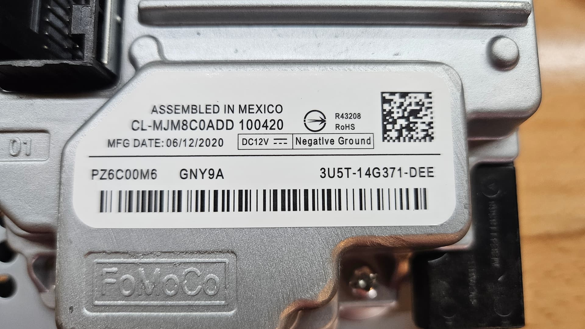

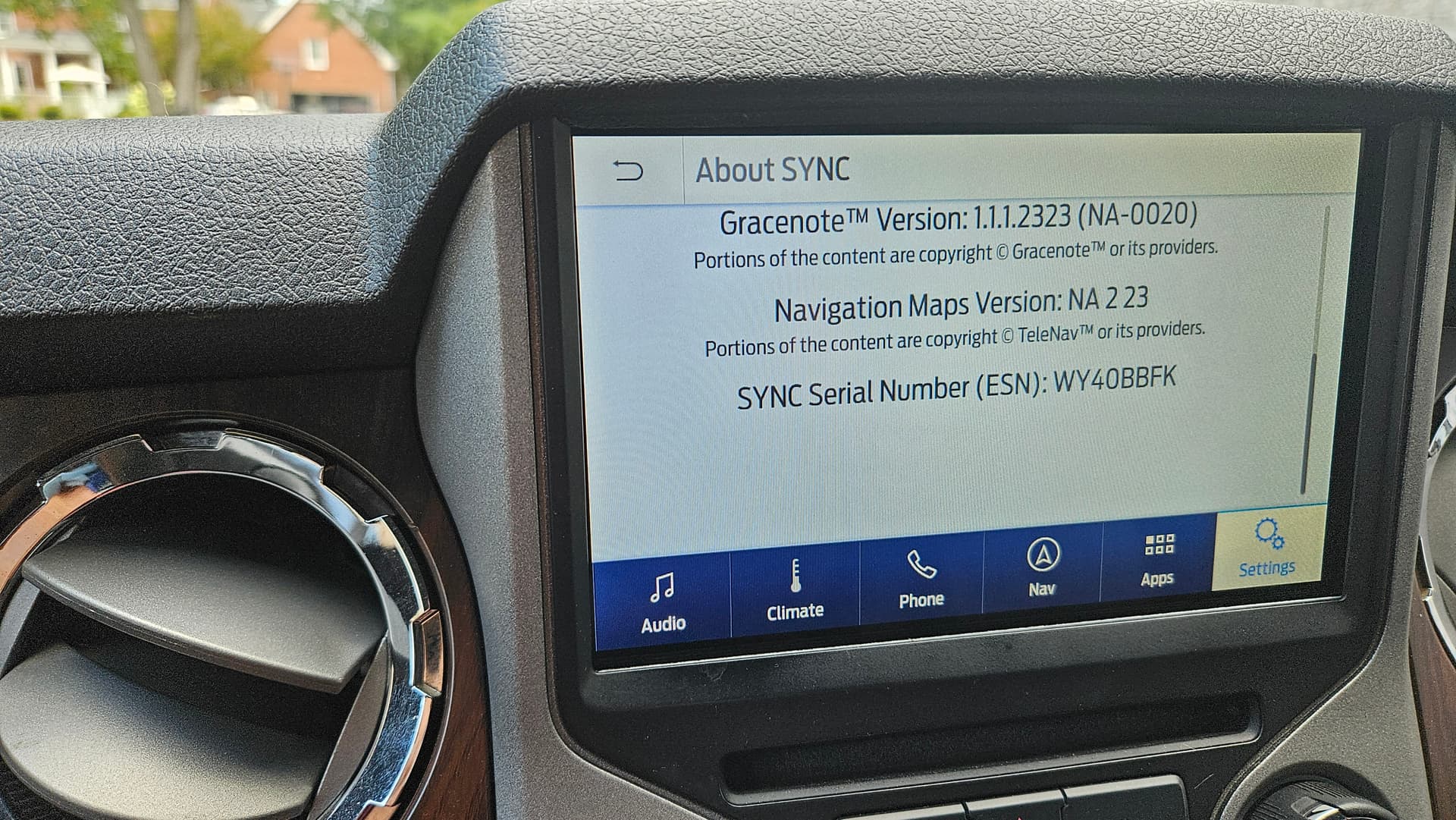

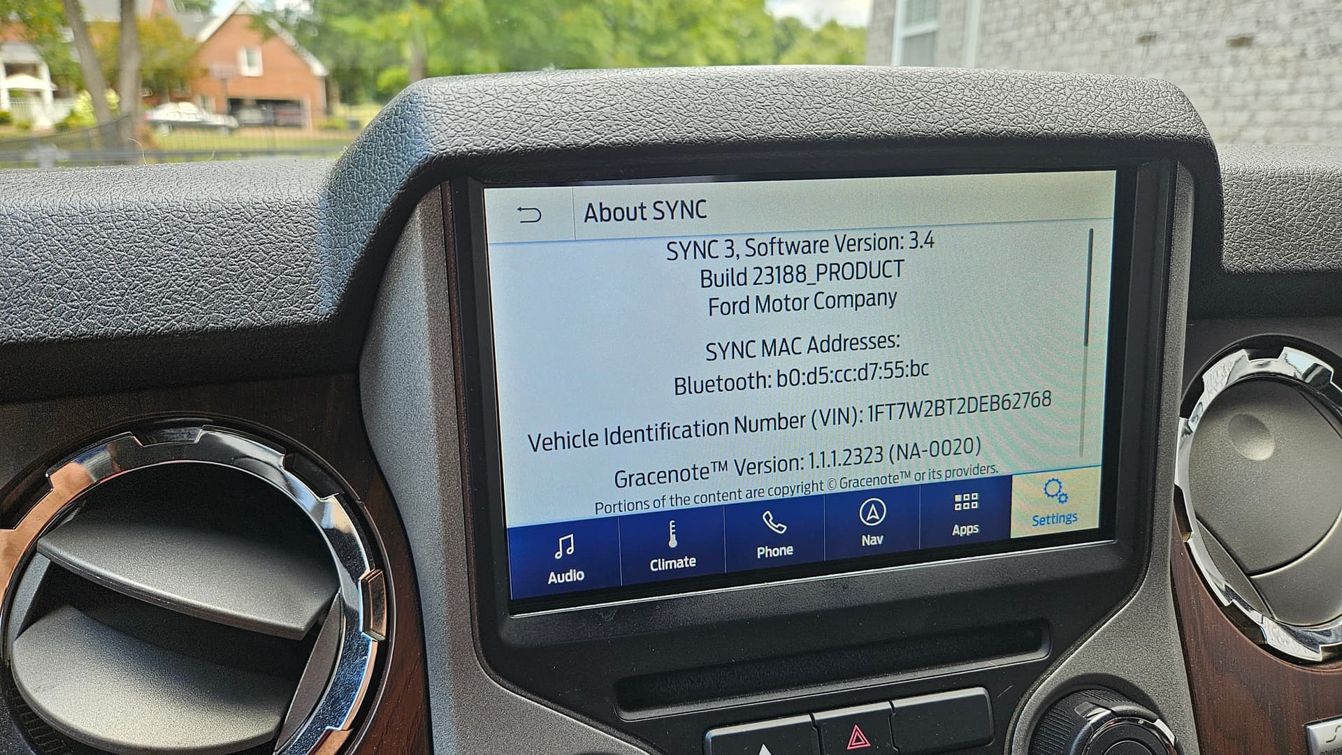

I recently bought a Sync 2 to Sync 3 upgrade kit from Ebay. They programmed the APIM with my VIN before shipping. Version is 3.4.23188, Nav is NA 223. MFG Date: 6/12/2020 by FoMoCo. Installation went quite well and everything functioned fine until I did a remote start. The truck started but the screen went black. I pulled the radio/SYNC fuse but this didn’t resolve the problem. After getting home and turning the truck on and off a couple times, the Sync 3 system would briefly work but would loop through shutting off/on. I should note that during initial setup of the Sync 3 I connected the truck to my Wifi and set it to do Automatic Updates.

Take a picture or supply the info on the unit including the part numbers and date of manufacture.

The navigation on the Sync 3 works.
That’s a Chinese fraud APIM. That would explain your problems and if it was not a fraud it’s a 2020+ APIM and you would brick it if you formatted it.
