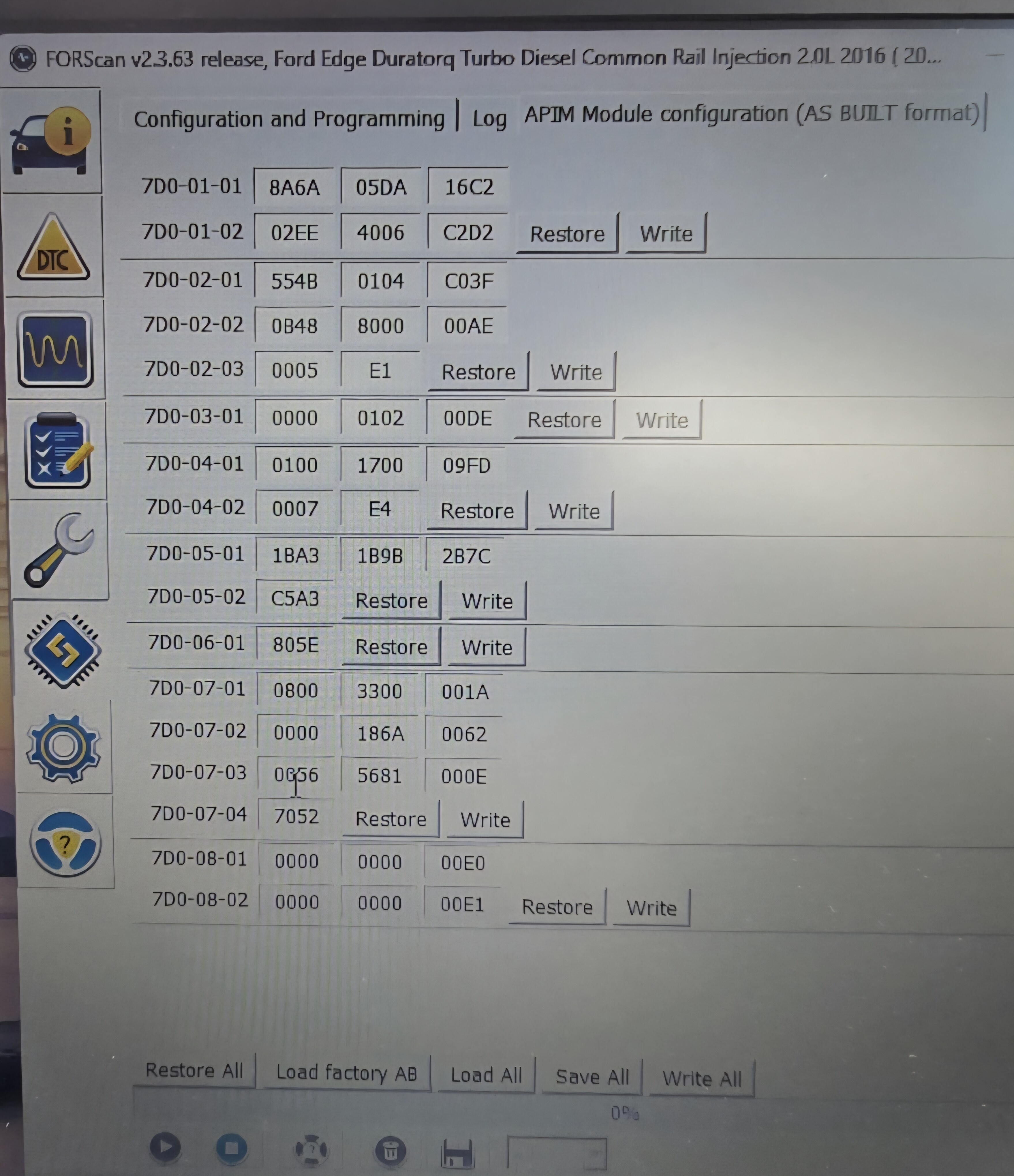

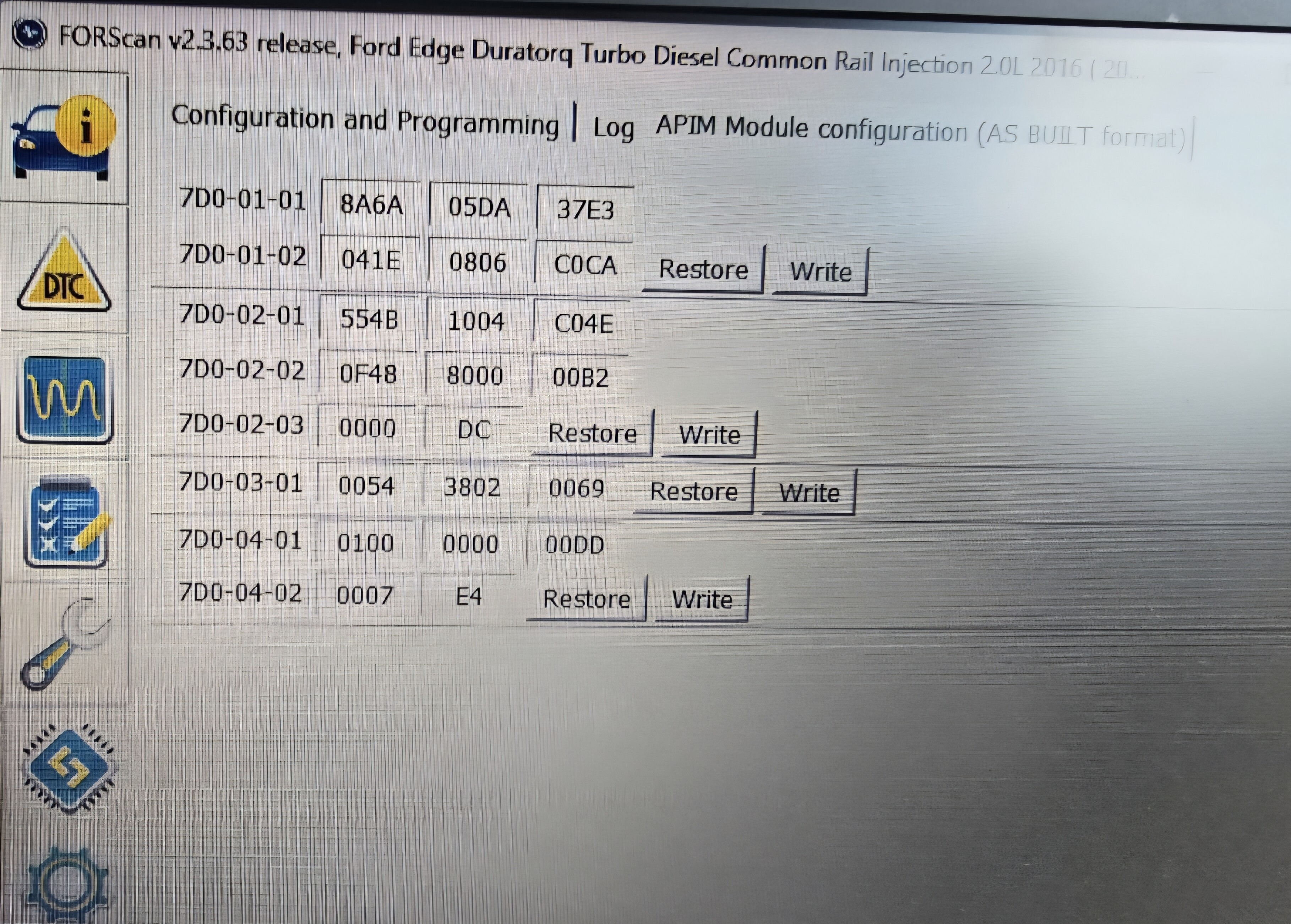

Hi,
These are the photos it took of the as built of the sync2 and the replacement sync3 unit. Will gather more info when i get home.
