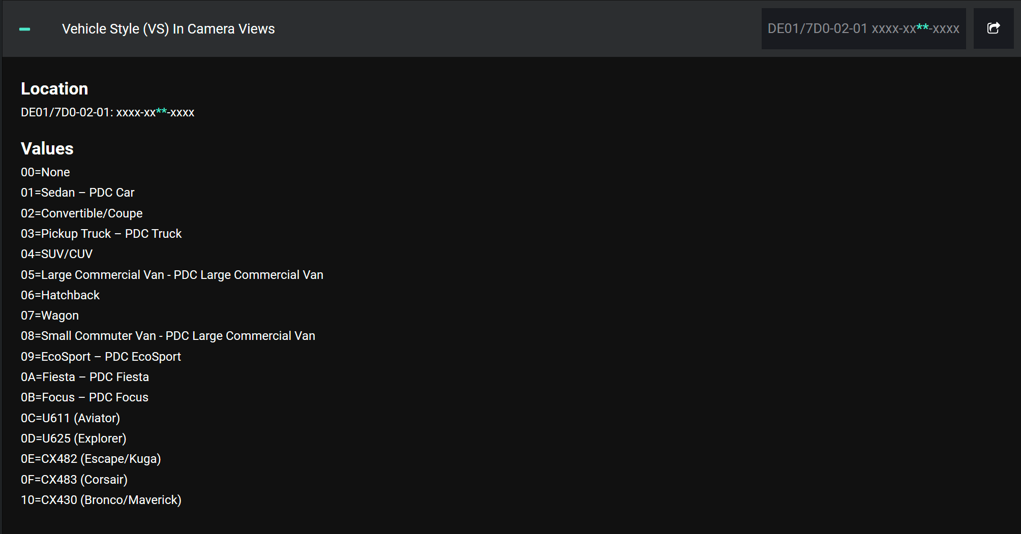

I have recently upgraded from my Sync 2 stock incar display to a new Sync 3 module. Everything seems to have posted over and I’ve had a fiddle with ForScan to get the settings right but one thing has eluded me.
When I put the car in reverse, I can’t seem to get the little parking car graphic with the semi-transparent lines in the top right corner I hear the audible beeps to tell me I am near something but can’t see a graphic…it also doesn’t pop up when the front/side of the car is near an object.
My specs for the car are below:
2014/5 Titanium X
Automatic Park Assist
Active City Stop
12 parking sensors (6 Front/6 back)
Start/Stop
Any help getting my little car graphic back would be greatly appreciated!
Try this…
