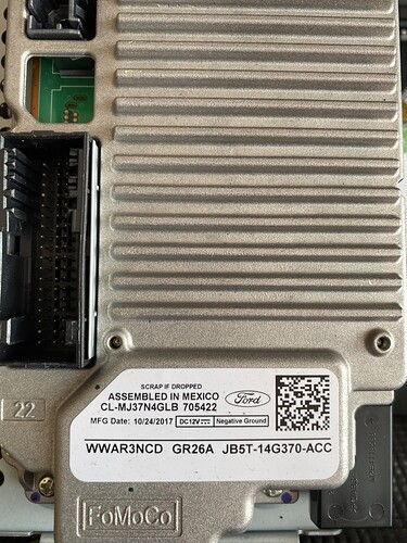

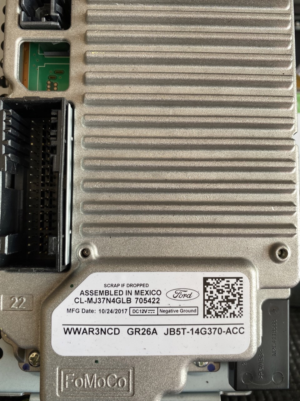

Here’s a photo of the part number on the SYNC 3 APIM if that helps
So the ACM will play music regardless of the APIM. That APIM should not be a 2020+ one just based on the date for that sticker. Can you get a picture of the big sticker on the back of the APIM?
Also if you could post your APIM AB info here from Forscan.
The build needs to be updated to 3.4.23188 or downgraded to 3.4.21265

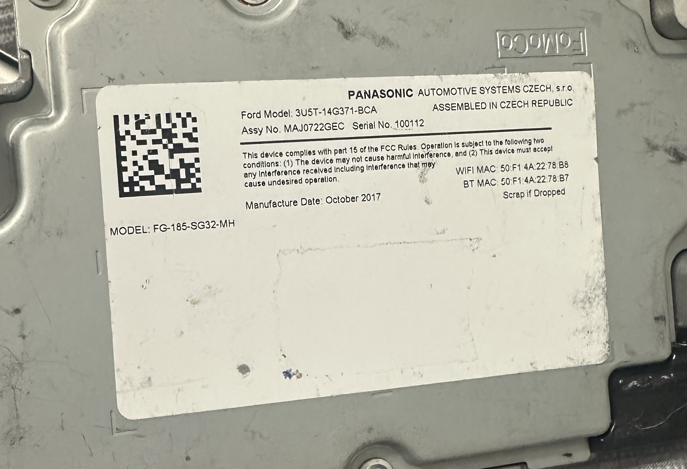

Yea that’s still not the right sticker. Looks like this one…
3U5T-14G371-BCA is a non-NAV EU 16Gb APIM.
I’m guessing this was a Chinese kit and they pushed in the maps piecemeal.
A NA NAV APIM is a 32Gb unit.

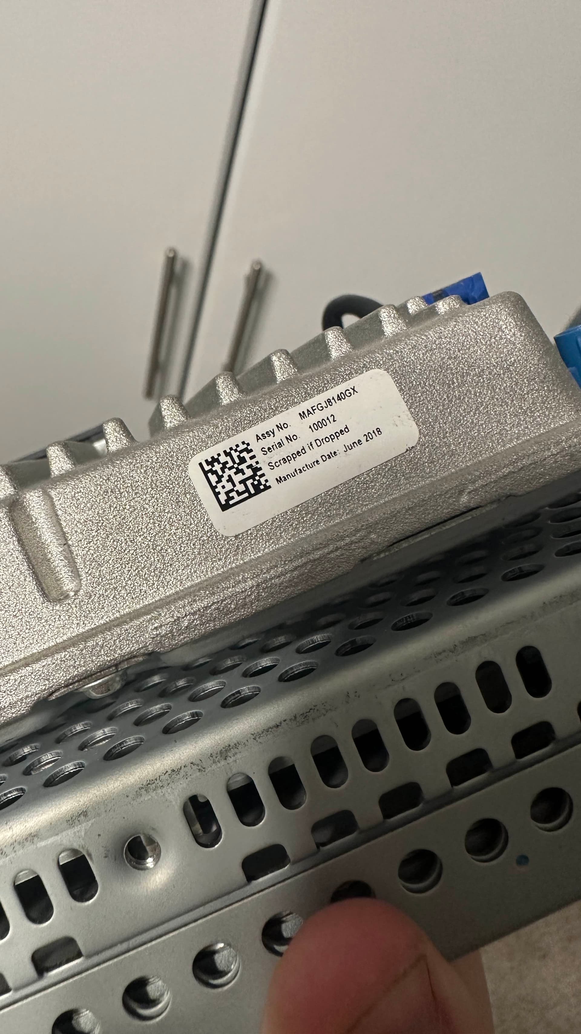

Mine doesn’t have that sticker. It’s just a blank area on mine
the one I ordered was supposed to be a 32GB NAV unit. Maybe I got screwed over in multiple ways
This, among other things, confirms it is a fraudulent APIM than. That would explain the problems you are having.
I would try to return it and get your money back. You got scammed.
