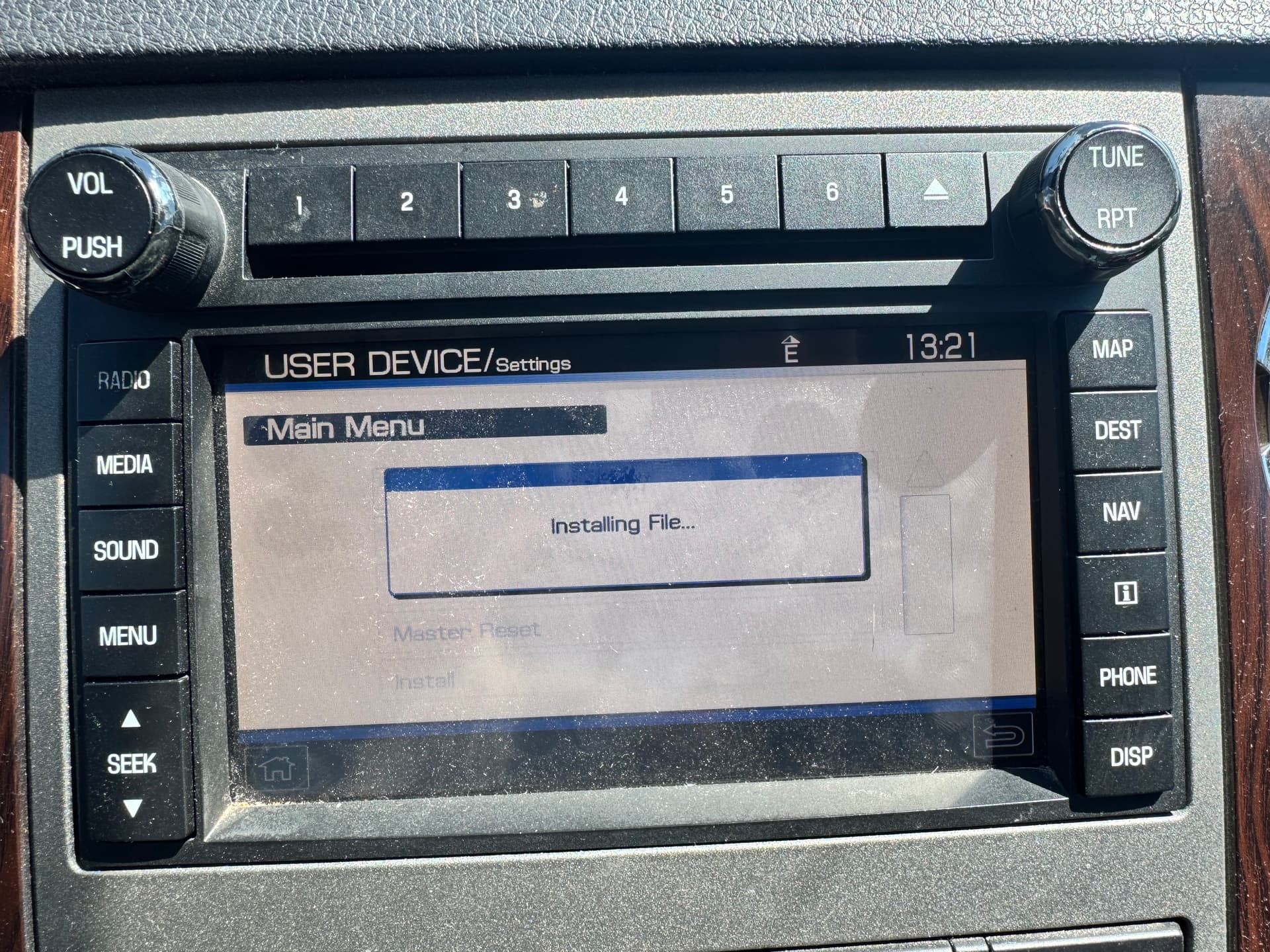

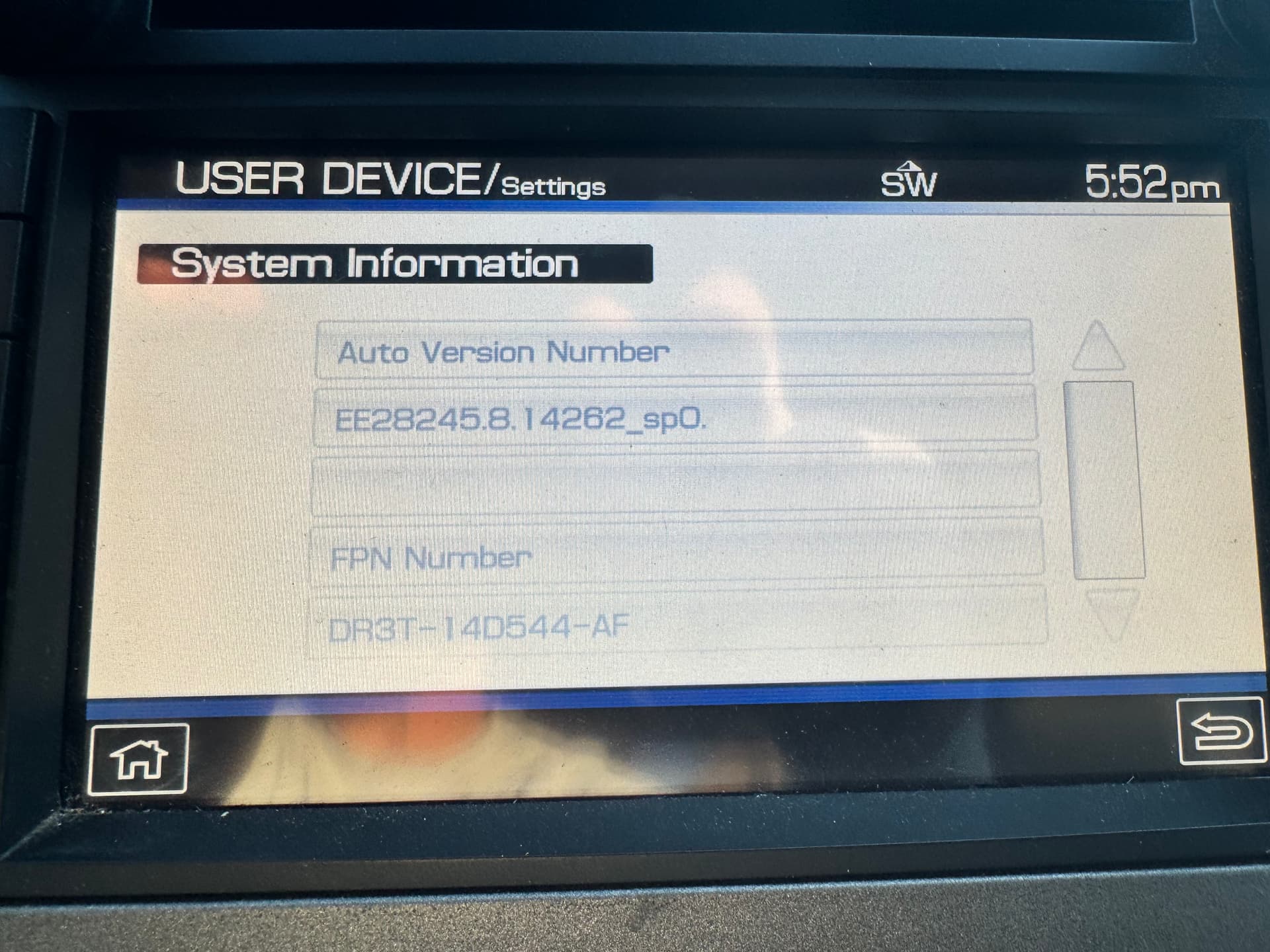

Help. My battery went dead and both batteries in my 2012 F250 SUPERDUTY 6.7 had to be replaced. Radio works fine. SYNC…it’s sounds really distorted and digital. I have tried downloading the file to a usb. But last night the screen says ‘Installing File’ for 3 hours. No joy. I’m not sure what to do.
The Cyanlabs updater will not work with this old version of Sync.
Thanks. So…what’s my best option? Do you know if a direction you could point a guy in? I honestly think it’s the software. But I’m stuck.
Perform a master reset on the unit and then ignition cycle the vehicle…
I wish there was a solution. If you had Sync 2 in a 2013 than you would have more options.
