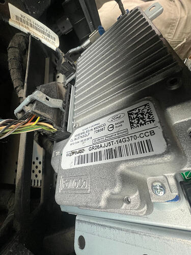

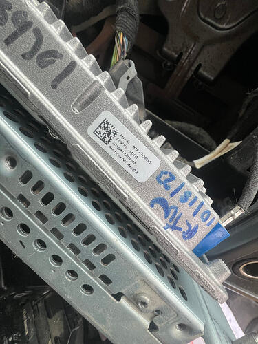

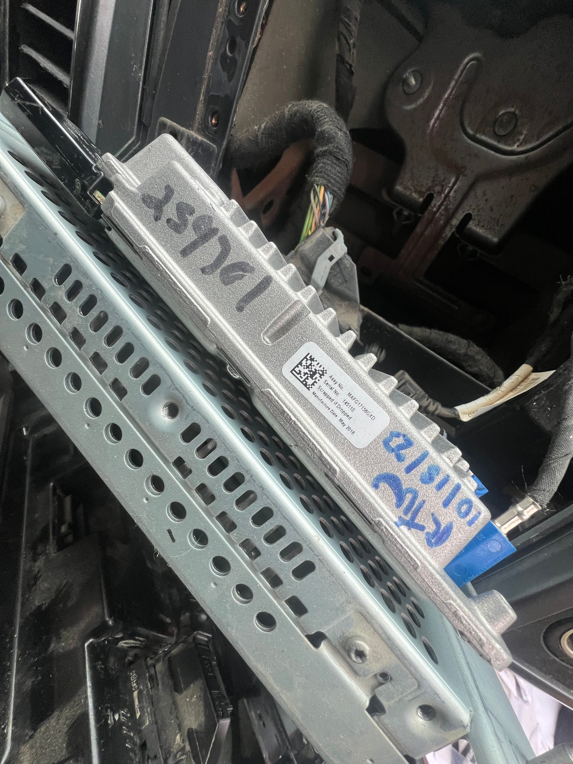

Thanks, Bill. Right now i’m of the mindset to leave well enough alone. My cameras work now so I’m probably not going to mess with a 3.0 → 3.4 Sync upgrade, because I am afraid of bricking the APIM. Previously when I was creating the upgrade file, I got some notices in the Syn3updater that said a 3.0 → 3.4 upgrade would not work, and i’m guessing it’s because the APIM is an older, cheaper model. I wish my GPS/maps would work, but I also received conflicting info on whether or not the APIM is a Navigation APIM. Now that I think of it, if I were to pull the APIM from the truck, would there be any stickers/labels that might help clear up the confusion?
Well if you get bored and take out the APIM than get a pic of the label on it. Curious what you have in there as a 2022 wih 3.0 makes zero sense.
FORScan will tell you what you need to know about the APIM as far as upgrading it to Sync 3.4, just look at the module configuration tab next to the logging tab. You will find the APIM part number which you can compare with the hardware database here.
Keep in mind that using any asbuilt database, even FDRS, IDS, or other that there may be production changes and differences between model years and models, and sub-models. There is no master database per se. The correct asbuilt for your vehicle will be the original version of the OEM asbuilt. This is not necessarily what you can download from Ford Service, as this can be updated anytime the vehicle is connected to the Ford online service system. The update may not agree with the OEM asbuilt file. You should review your OEM asbuilt file to determine the software and hardware your vehicle was equipped from the factory and proceed from there.
Hi Bill, below are the APIM pics. I also posted the interrogator results below. Let me know what you think.
VIN: 1FT8W3BT0NEC09078
APIM Model: JR3T-14G371-CGA
APIM Type: Navigation
APIM Size: 32GB
APIM Free Space: 4.9G
Version 3.0.18093 (JR3T-14G381-AM)
5/19/2014 5:15:01 AM +00:00

Yup, As I thought, Someone has swapped the APIM for a J series Nav. The person clearly did not know how to get the AB values right.
Looks like this is an XLT and those still came with Sync 3. They did not get Sync 4 till the Lariat version. Based on the Factory AB it did have Nav so it did come with the 8” screen.
It would have had an L series APIM in it so it’s not the original. The calibrations would be different so the AB values wouldnot line up past the 07 blocks. It did have values in the 08 blocks so unless you get a K series with the right calibration or above APIM some of the features will never work.

In all truthfulness they probably didn’t know what version of Sync the truck came with or the right hardware version of the APIM, they more than likely got it off auction.
Quite a few of the dealer techs may not even notice its not the right version at first glance, they see the Ford logo come up and its a Sync 3 screen. Partially this is due to Ford keeping 3.0 in some 2019(s) like the Escape, while others like the 2019 Fusion went to 3.4.x on the first Sync update, and others got Sync4
