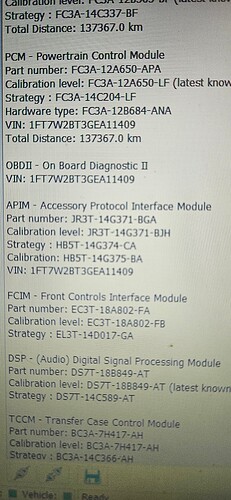

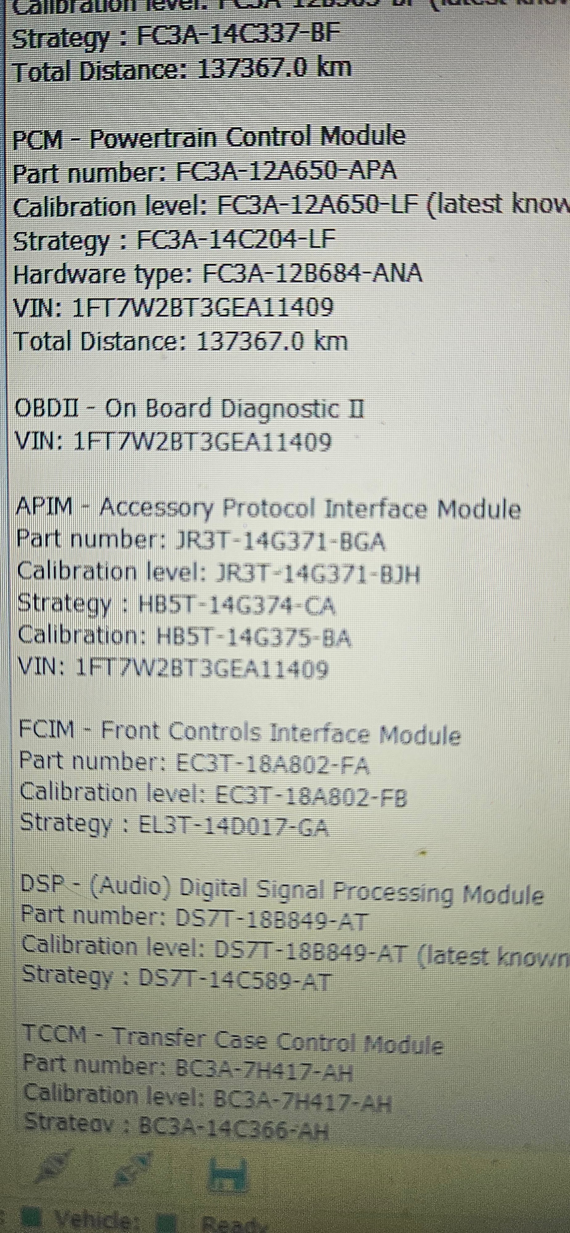

I plugged in the forscan. Not sure if this is what you are looking for but here are the screen shots. Is this helpful? Thanks!
Thank you for the information. So, according to our DB that’s not a MY20 APIM, so it should not be dead. I’m not sure about the screen though, and Forscan can’t see that part number. And even if it did, I’m not sure if there’s a naming convention.
There’s a chance the screen is MY20 and the reformat disabled the unit because it lacks the proper drivers for MY20 hardware (which includes the screen). If that’s the case, the unit should be recoverable by temporarily connecting a not-MY20 screen so that the process can complete.

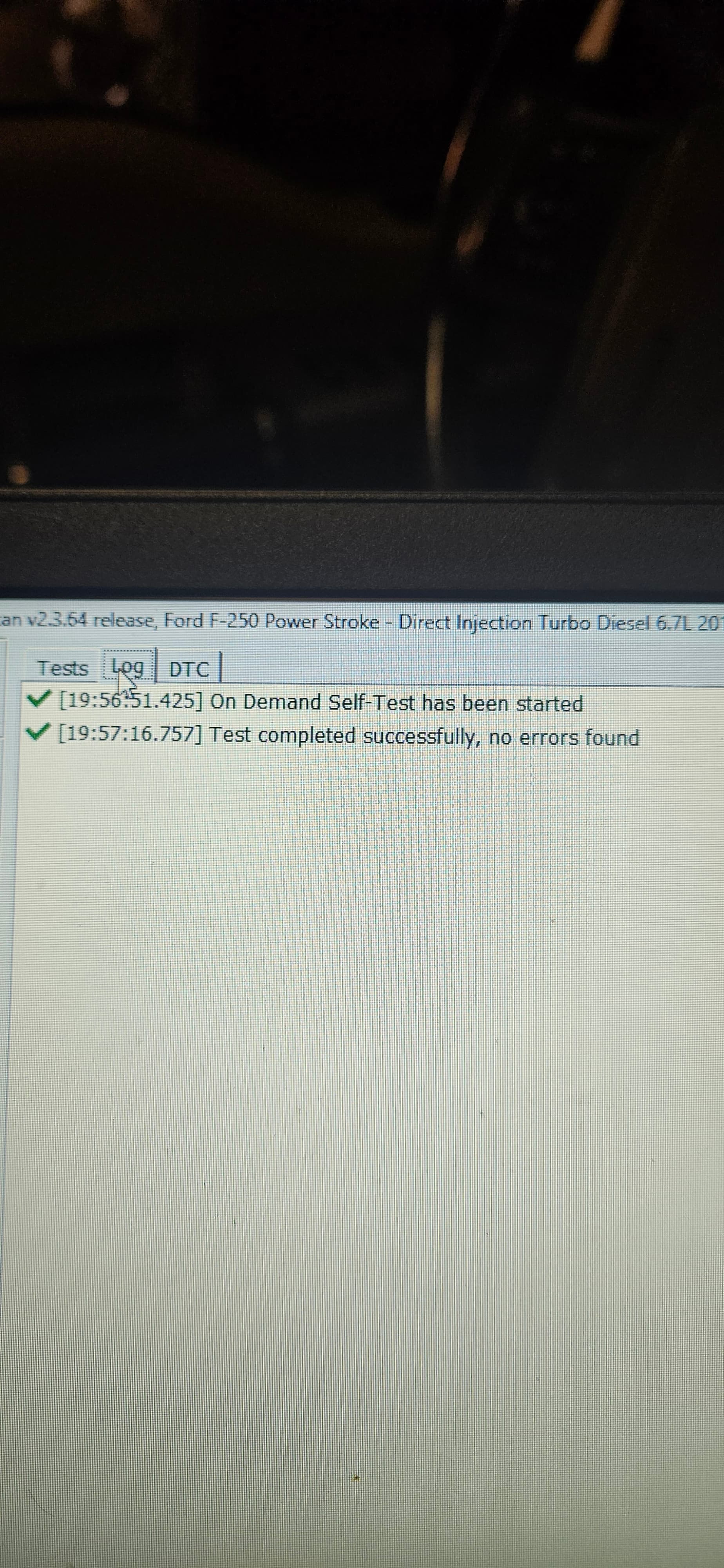

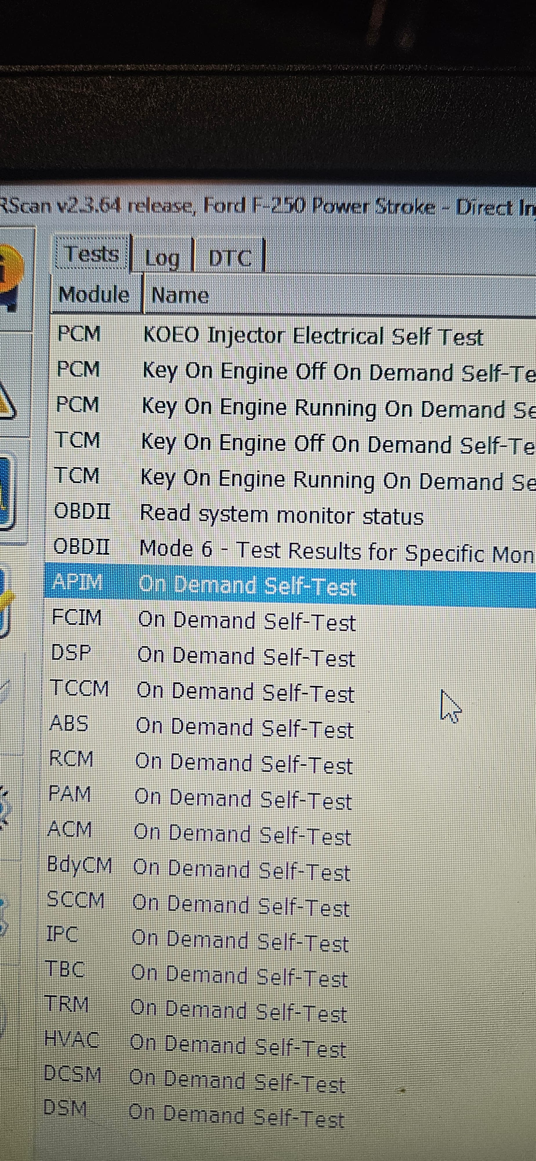

Is there any DTC present at the moment?
