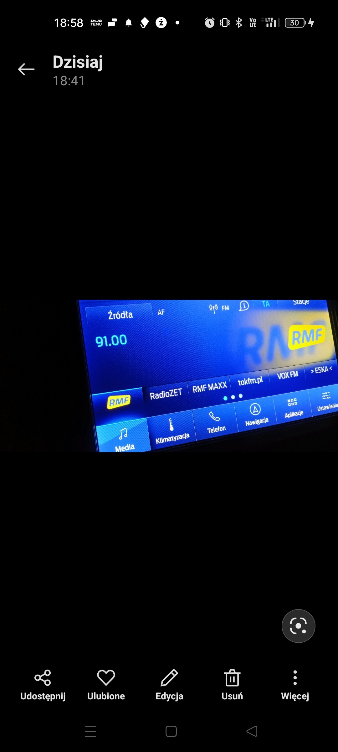

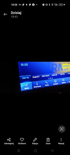

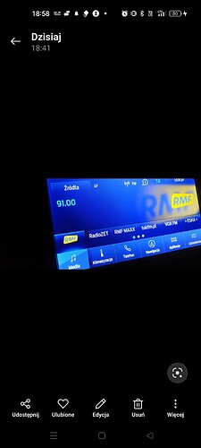

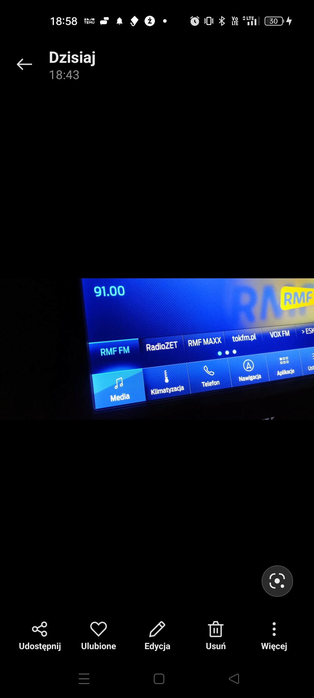

I have a problem with station logs on buttons in sync3. They do not save. After restarting system there is only the name. I found out that the only solution is to reinstall. I wanted to know if I configured the pendrive correctly to reinstall Sync3.4.23188, and also if the “reformat.lst” file looks good? Will the installation start after inserting the pendrive? Are there any surprises waiting for me? I know that because I have version MY20 I cannot use sync3 uploader. I also do not have a computer with Windows 10.

I only did the reset by holding the station search and the radio switch. Is there another way to do the reset? I also reset the APIM unit via Forscan. The idea of ​​reinstalling sync3 was suggested to me by a person from the Forscan forum on Facebook. No one knows what is the reason for the station logs not being saved on the sync 3 buttons. At first everything worked until my 12V battery died (my Ford is a hybrid). Since then it has not remembered the station logo.

Hard reset didn’t help. Still the same. After turning off sync and turning it on again, no logo.

Thanks for the information, I downloaded a new mod. I installed it (the shapes of the icons changed) but it didn’t solve my problem. I read in one thread that someone had this problem before. He wanted to upload the mod to his own radio station logos and some kind of mod conflict occurred. I didn’t upload anything new at the time but maybe some kind of conflict occurred. Unfortunately, you can’t remove mods so he reinstalled the whole sync3. I guess I have to do it too. I just looked, I have all the maps I downloaded. Because I don’t have my own computer with Windows 10 and I can’t install Syncuplader. Just put the files downloaded from the CyanLabs website with the appropriate version, i.e. the map system files and voices, on a pendrive, place them in the SyncMyRide folder and create a text file called reformat.slt and place references to the files from the SyncMyRide folder in it? Is the order of these references important? Will the pendrive configured in this way work? I won’t use the formatting from the CyanLabs website because I have an MY20 unit, I know that.
