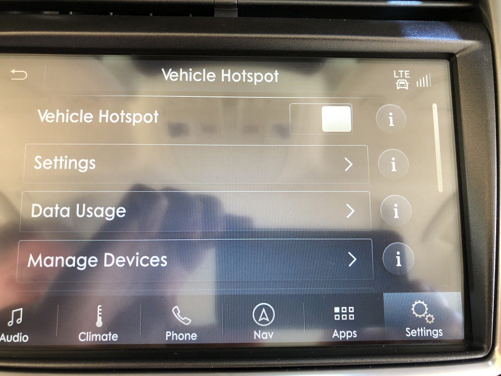

Why does it look like it has no signal when it does and it working? I get this notification/ icon in the hot settings. I am talking about the one in the top right corner.
That icon is for a Bluetooth connected phone not the hot-spot
I will see if it is still there when I have my phone connected to Bluetooth.
Update: it still shows that even when my phone is connected to Bluetooth??? It doesn’t affect anything as far as I can tell, just odd it shows like their isn’t any signal.

That icon is the ATT service. It will have the red X if the signal is missing from one of the antennas. There are 2 LTE antennas for diversity for the hotspot models. If your service still works on your hotspot, then something might be amiss with one of the antennas, or something else. The primary antenna is usually on the roof, like the sharkfin, and the second is usually by the back window or package tray.
BTW, you will only see this icon on this screen. The LTE (celluar) icon on the main screen is for your phone.

Hotspot antenna is built into the TCU Modem (FordPass) on the circuit board. If you have Hotspot, there is a diversity AT&T receive only antenna mounted up high in the vehicle.
