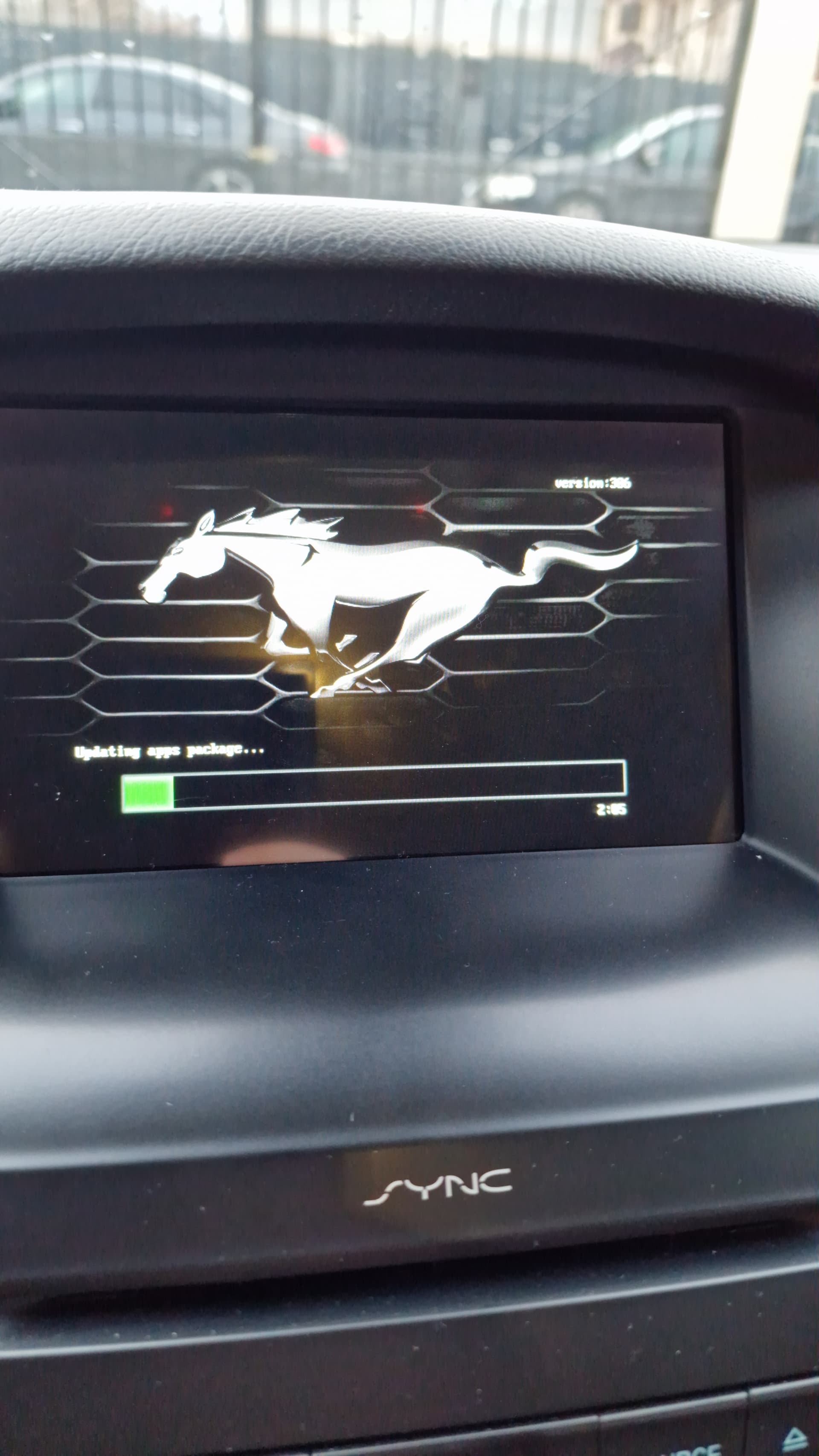

It is a 2017 apim, I will try to upgrade to sync 3.4 and see if the usb hub still works if not I will downgrade to an earlier version as I think the prices for a usb is a ripoff, wish me luck and I hope I do not damage this one as well :slight_smile:
The HUB should work, only issue is that if it’s an old one, 3.4 will warn you about USB HUBs not being supported every time you turn on the unit… But you can just hit “OK” (or something like that) and it should work nonetheless. The key word here is “should”.
About downgrading, you can’t go past 3.3… And I can’t assure you 3.3 will not give you the HUB warning…

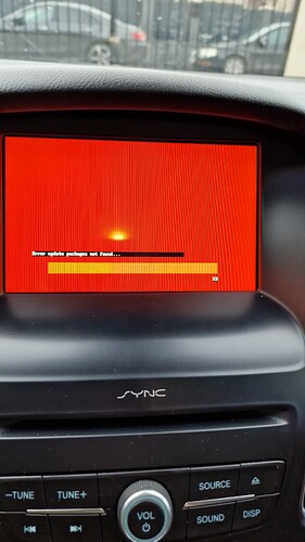

I get this error what should I do? Should I take the usb out?
Edit: fixed I forgot the SD card with the satnav maps in, now it is installing
Instalation successful but it throws up a navigation malfunction ( I have only selected the maps from my region eastern Europe) or is it because I do not have a got a GPS antena installed ( it was not reporting this issue with sync 2.3 it was jus saying no Gps signal), o don’t care about navigation as long as android auto works but I would like to have it fixed.
Edit: it is because of the GPS antena missing
