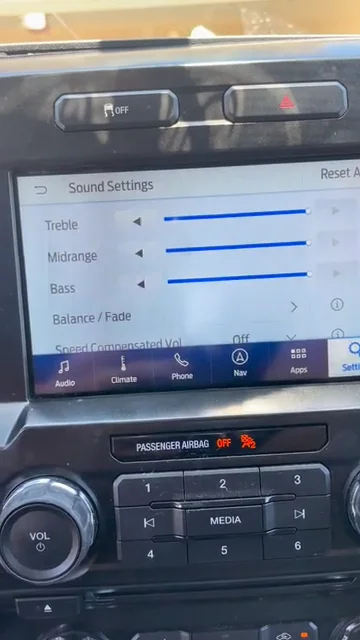

ok guys last question so my ford f150 2015 came with sync 2 i already installed the sync 3 gen 1 updated to 3.4 do i also need to change the bottom part cd player ? the one that came with the sync 3 has hd radio ?..now another issue i cant change the volume thru my steering wheel nor change stations also i cant adjust sound settings on the radio because they they move by them self’s
p.s i did a master reset twice

For the hardware, don’t use the CJ5T-19C107-GB 13-15 Ford Escape Am FM CD Mp3 Radio Receiver. It’s not Sync 3 ready. Not that it’s not compatible, the FL3T-19C107-HG is already programmed and a better unit.
For the steering wheel controls, they are disabled in the APIM. To enable, change 7D0-01-01 xx** xxxx xxxx from 28 to 2A.
The asbuilt in the APIM is from the donor vehicle, I can tell from the wheelbase settings it was a car. There are some changes to make. This will fix you r issues. I need a little time to go thru it.

Here is a new asbuilt to load into the APIM. Back up the old one first.
Open FORScan and go to the APIM asbuilt configuration. Select ā€˜LOAD ALL’. Choose this file and load it. If you get a parity message, just say YES.
This file is and equivalent model year and trim level to yours. May need one or two tweaks, but will work. And your nav will be accurate with this one.

also this happens check the video
Sorry I just sent the other post. Try loading that and see if it all works. I think it will fix the sound issue since your asbuilt says you have Sony and you don’t. Also you have manual climate controls. This might fix the clock.
DO a MASTER RESET after the APIM reboots from programming.

loaded everything so far everything is working with n issues if anything comes up ill let you guys know @F150Chief @CyanLabs @SaNdMaN Thank you so much
