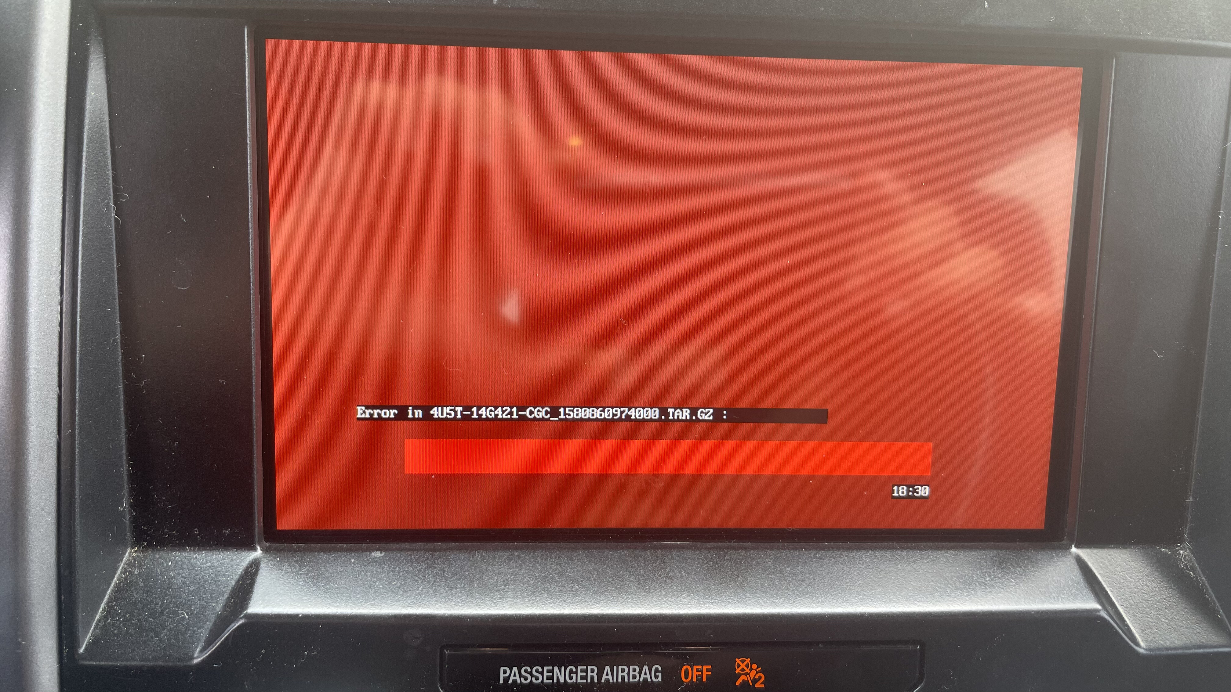

SFRANCO
(Hades)
18 May 2021 18:42
1
What is your SYNC Region?Na
What is your current SYNC Version? 3.019052
Do you have Navigation? Yes
Please paste your log output or provide the URL to your log file below
CYANLABS - SYN3 UPDATER - V2.6.2.0
Version: 3.3.19052
Mode: reformat
My20 Protection Enabled: False
Model: Kingston DataTraveler 2.0 USB Device 28.8GB

[5/18/2021 12:22:54 PM] Selected Region: NA - Release: Sync 3.4.21098 - Map Version: 1.19 (2019) - NA
[5/18/2021 12:22:54 PM] Install Mode: reformat
[5/18/2021 12:22:54 PM] Checking Existing File: 1u5t-14g386-cb.tar.gz
[5/18/2021 12:22:54 PM] Validated: 1u5t-14g386-cb.tar.gz (Skipping Download)

Please describe in detail your issue below
Please post your log file.

Your log and autoinstall files look all right. Try using a different USB drive if you have one. Preferably USB 3.0.

please helped so far 6 different usb 16 gigs 32 gigs and 128gb 3.0 and Same error tried a different usb

May be a stupid question, but does your car really have built-in incar GPS/Navigation?
SFRANCO
(Hades)
19 May 2021 19:19
8
it does it used to give me navigation fault thats why i tried to updated to fix the issue
FYI - So this is a Sync 3 upgrade from Sync 2 as 2015 F-150’s didn’t come with Sync 3.
So when you turn on the truck, what does the Sync screen show now? Is it normal, but at 3.3.19052. or is it stuck in the boot screen saying please insert usb?
SFRANCO
(Hades)
19 May 2021 20:10
11
I cant use that because its stuck on the screen with the mustang asking for install package
SFRANCO
(Hades)
19 May 2021 20:26
12
When i first installed it it was working it just had navigation fault so i update and no
Content made on Kapwing
SaNdMaN
(SaNdMaN)
19 May 2021 20:31
13
So NAV didn’t work before, and you are having issues with installing NAV now…
There’s a chance your APIM is NO-NAV, or region has been changed…
Why don’t you remake the USB but without maps?
It should trigger the reformat process but without map packages. If issue is due to lack of storage, then it will succeed.
Also, interrogator log should clarify things.
See if you can recover the unit…
Make a usb with the following:
reformat.lst file below.
DONTINDX.MSA file (Optional)
SyncMyRide folder:
In the folder, place 4U5T-14G381-AN_1552583626000.TAR.GZ. This is 3.3.19052.
reformat.lst (44 Bytes)
Hopefully this will recover the unit to 3.3.19052. Once it does, run the Interrogator Tool and post the results.
FYI he’s stuck on the boot screen…I’ve used the above to save several folks stuck there. Then go from there.
SFRANCO
(Hades)
19 May 2021 20:34
16
it went tru now i can boot into sync radio works but still navigation fault under diganostics i can see the satellites but when i go under settings about under maps it does not show any maps
Sync is the only thing that will work right now.
DO NOT install anything yet, please.
Run the Interrogator Tool…
SFRANCO
(Hades)
19 May 2021 20:52
18
sorry guys the guy who sold it to me on ebay told me it had navigation but it doesn’t
Version: 4U5T-14G381-AN
APIM Model: KU5T-14G371-BJA
APIM Type: Non-Navigation
APIM Size: 16GB
APIM Free Space: 8.5G
5/19/2021 3:41:48 PM +00:00
so i have a extra sync 3 gen 1 version 1 build 15139 can i update to 3.4 ?
Well, that’s too bad.
For the KU5T-14G371-BJA: Use the Syn3 Updater to update it to the latest app, voice, and Gracenotes. Use autoinstall mode. The app should choose that for you.
For the extra sync 3 gen 1 unit you can update that the same way, but it will be slower than the K series and may not have all the features due to older firmware. Being a Gen 1, don’t bother with the firmware upgrade, there is nothing to gain due to the old hardware. That said, it will work.
