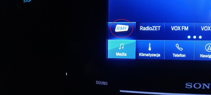

Is there any fix for Sync3 build 23188 for radio station icons in the tray? I managed to repair the camera and everything works. The problem with radio station logos on the bar remains.

The whole sync worked fine. It only broke down when my small 12V battery went flat (I have a 2021 Mondeo MK5 hybrid). After the battery went flat, the small icons with the station logos disappeared from the station selection bar. When I hold down the station name, an icon appears. When I restart sync, it is gone, only the station name is there. I wonder why this happened. Maybe it can be fixed somehow. I don’t know what APIM version I have, so I wouldn’t like to reinstall it. How can I check my APIM version?

The only problem is that the small radio station logos are disappearing. The large logos are ok.

Ok, but maybe it has something to do with the fact that the station’s logos don’t appear on the buttons?

Still no change, the station logos are not displayed. I am thinking about replacing the 12V battery. I measure the voltage after a night and the measuring device shows 12.03V. Maybe that is the problem. It should be around 12.4V. Could this be the reason that Sync 3 does not display the station logo on the buttons after restarting?

If they didn’t come back after being on straight FM then you are probably dealing with a case of a mismatch between what the ACM is sending to the APIM as the station identifier and what the APIM has in its internal DB.
There was a thread way back where a guy had issues with the logos not matching for stations in his area and he wound up getting into the database in the package and “fixing” the mismatch for his area.
