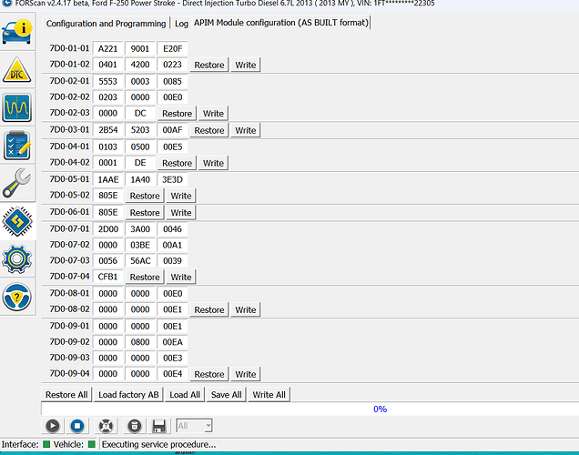

I just finished a Sync 3 retrofit on my 2013 F250 and I have a quick question on the programing. When I am using Android Auto and using my phones google maps for navigation, how do I code the APIM to show what audio source I am listening too on the split screen?
Currently, when it shows my phone’s pandora screen but the audio that is playing is SirusXM.
Old SYNC Version: 3.4.23188
Error log 004
Can't run the interrogator, I get ERROR LOG 004 message

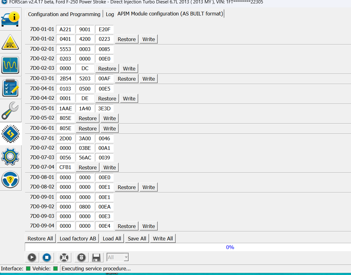

This is my current As Built data
Forscan is not programming or coding. These are AsBuilt settings being changed.
The Sync system does not know what CP or AA are doing so it will not display anything from them. There is no AB setting that will tell it to show something else.
Ahh, Ok thanks for the clarification. I thought there might be a setting that I was not aware of that I could change.
It would be cool. The only one I am aware of is the option to remove the AM option.
