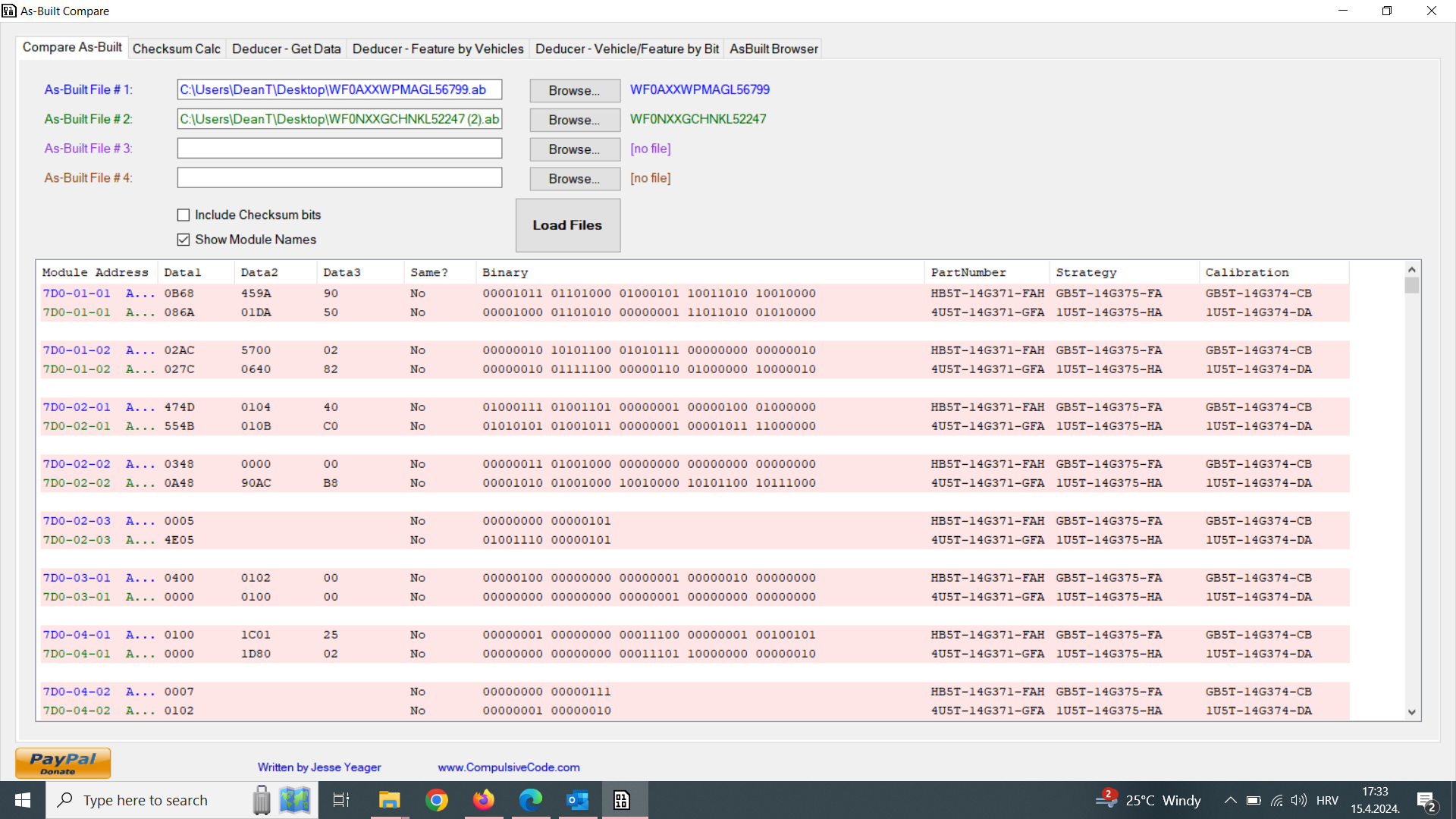

Yeah, did that already, quite a mismatch between the two in terms of number of fields. Symptoms are after original as built was loaded and master reset done.

Adding the -GFA changed the way the lighting strategy performs. Since this is a EU C1CMA vehicle, the value at 7D0-06-01 should likely be 81 instead of 80. In the original APIM, the value is 80, but that APIM Strategy file is -FA (US export) vs -HA (EU 64G NAV). The difference in the strategy files will change settings in the vehicle. Also, Sync 3.2+ handles lighting differently than 3.0.
You can see that all the way thru the new asbuilt it is defined for C1CMA, whereas the original asbuilt was defined for CGEA vehicles. (Thus the -FA strategy file.)
Ensure 7DO-01-02 xxxx xxxx Xx is set for C1CMA. Change the 8 to 0.
The strategy file difference is the culprit here, but you can’t really change it back to the original. The Illumination Cal file is likely different from previous also. Performing a firmware change could just fix all this if the C1CA settings don’t, but there is no guarantee.
