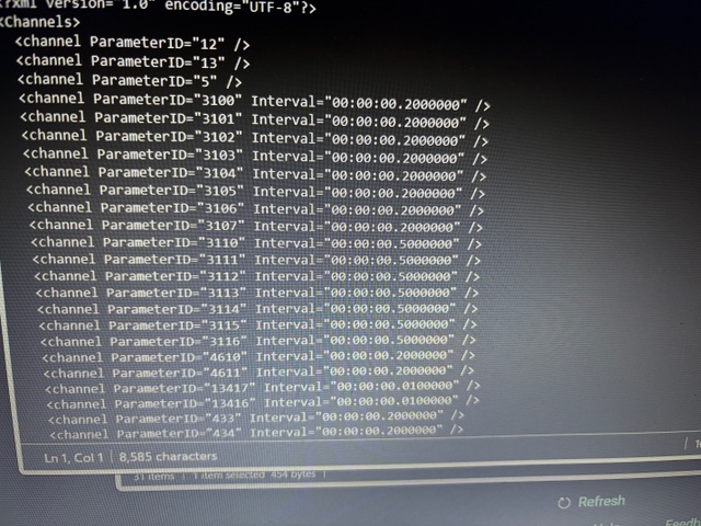

actuall changing the file to xml did allow it to open however it is not useable information, at least from my perspective. This is what comes up.
That’s why I asked about the VIN.

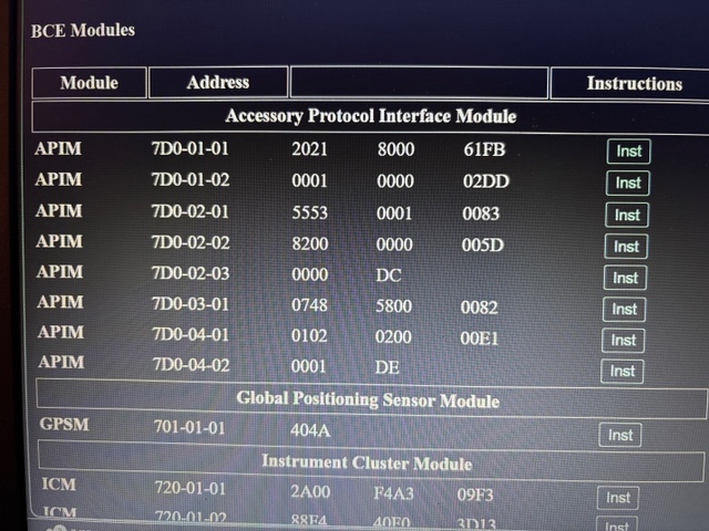

Ok, bear with me since I’m obviously technologically challenged. I found a program called AsBuiltExplorer that supposedly opens the Ford ab file extension…… and it did. Below are the results for a 2017 Explorer Limited ( the 2014 is also a limited). This looks like the formatting I see in Forscan. Are there changes that I would need to make to these codes to use in the 2014 in your opinion?
That is a Sync 2 asbuilt. Which is yours? That is not a Sync 3 asbuilt which is what you need to find. Having a GPSM present tells me this is an older vehicle.

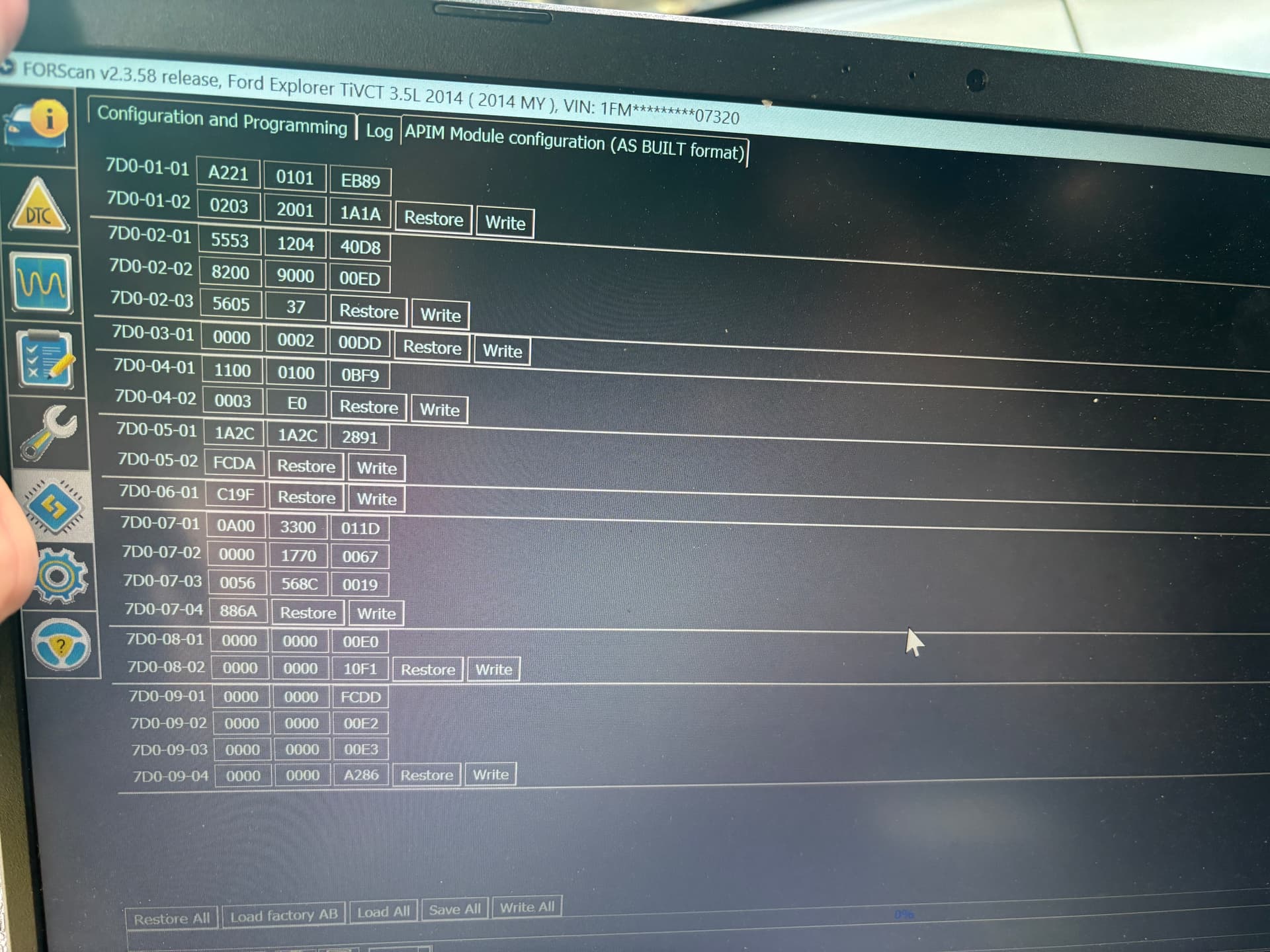

Just hang on I will get a pic of my AB.
Here is my AB for my 2015 which is for the most part identical to a 2014. Don’t worry about the 8 & 9 Blocks. They will not work in a CGEA 1.2 vehicle.
I am running the Sony system with heated steering wheel and HVAC seats so you will want to keep those settings in mind. I believe you have a Limited so these should carry over.

Back to my Explorer project. I will post a screenshot of the blocks as I programmed them using the spreadsheet as a guide later today, for whatever reason it won’t load from my phone. Everything appears to be working, won’t know for sure on the parasitic draw as it usually took 2-3 days to get to a no crank condition. If you see something wonky please let me know which block it would be and what you would suggest.
Again I appreciate the help and
Here is the screenshot I mentioned earlier. If you spot anything of concern please let me know. Thanks again,
