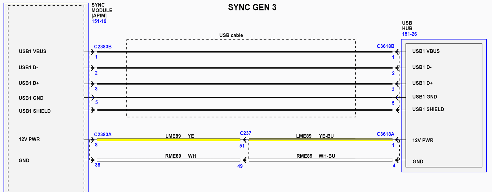

I inspected the cables and they do not appear to be damaged. The fact the USB lights are not illuminating makes me think there is an issue with the cable however. Is there any way to splice into different cables for a power source?

Lighting up means the 12v power connector on the module is good.

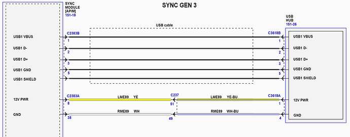

The USB hub is powered straight from the APIM. If you messed with the wiring when installing the console than something is probably messed up. The light should be on for it to function normally. While it is just a 12v source I would try to keep it running off the APIM so it functions like expected.
