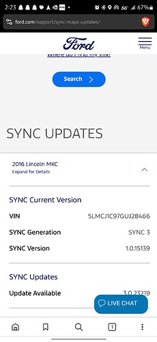

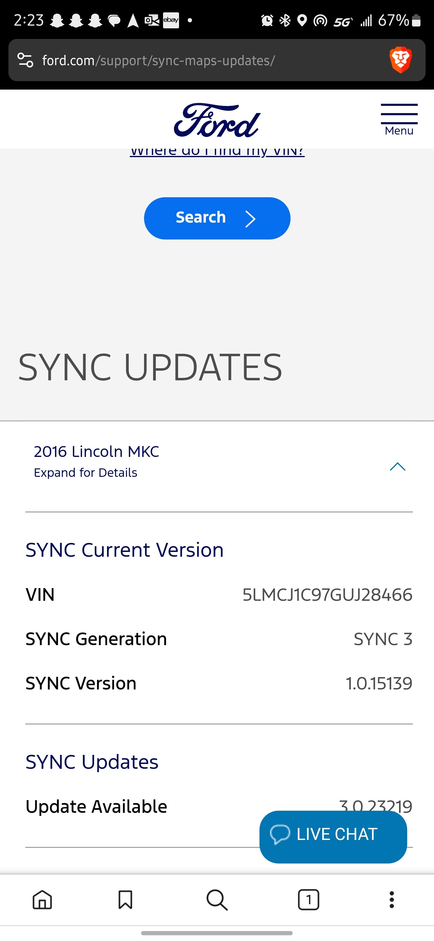

The seller got back to me about the Vin the apim came out of. Ford says it’s sync 3 and has an update available

The ford update I downloaded for that Vin gets further but does the same thing eventually
