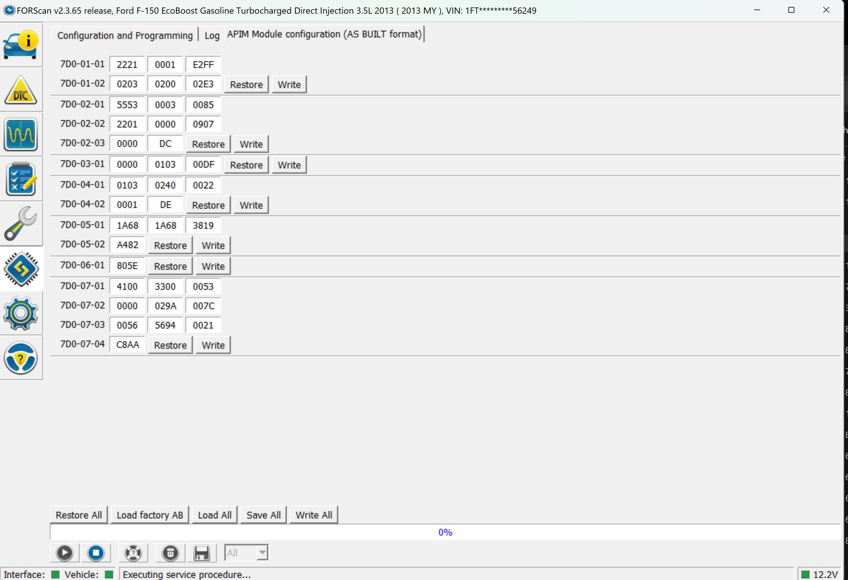

I have the same problem. Just switched out an APIM sync 3.4 unit from eBay (china) in my 2013 F150 Platinum. I think everything works except for the volume & fan repeater display. Had to change some settings because the GPS initially didn’t work and was getting a U0155 DTC. Would love to get the volume to show. TIA

Keep in mind that placing Sync 3 into a CGEA 1.2 vehicle that some things will have limitations. (The 2015+ F-150’s are CGEA 1.3) One of those issues is the climate control. CGEA 1.2 vs 1.3 is quite a bit different and was not really accounted for in Sync 3.
7D0-01-01 *xxx xxxx xx–
2221 0001 E2FF
needs to be changed to
AA21 0001 E2xx (xx is the parity bits, let FORScan calculate and write those…)
This should fix the audio issues.
7D0-04-01 *xxx xxxx xx–
0103 0240 0022
0103 0200 00xx
This will turn on the setting for the Fan Repeater, if it will work…

Thank you! I have volume controls!
