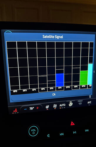

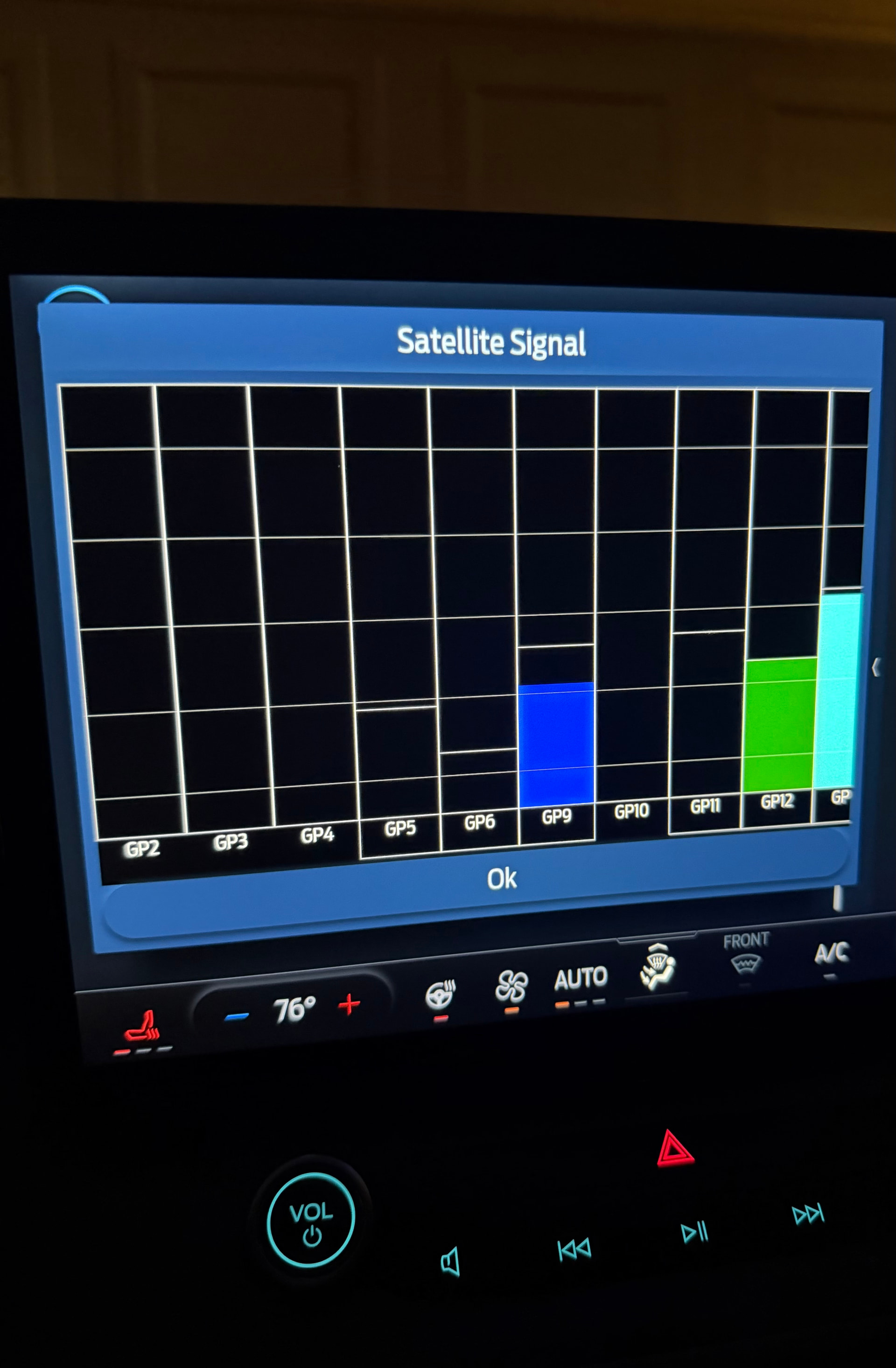

Edit: Going into Sync 4 diag mode (like https://www.youtube.com/watch?v=Sxa8CzPm1h4) shows no satellites connected.

If you see no satellites in the diagnostic menu then there is an issue with the GPS antenna, most likely. You can troubleshoot this using this guide, it’s the same as Sync 3.
GPS Hardware Test: The Compass/Navigation is Inoperative or Does Not Operate Correctly. (No GPS) - Ford / Guides - CyanLabs Official Community
Thanks for linking that, that was good to run through! I had used a more generic code reader earlier without luck, but used one with better support for Ford PIDs and saw a U2101-00 indicating “Control Module Configuration Incompatible”. I haven’t touched any other modules except adding fog lights in the BCM module, so I went through and revisited my APIM config against someone else with a similarly equipped Maverick running Sync 4, and that seems to have done it. So I guess I must have changed something else around that time and forgotten about it, sorry.
Just for posterity, it was originally equipped with Sync 3, and Sync 4 is running 23159_PRODUCT. Though this now means I should probably pull my APIM out and reconnect the factory GPS instead of my other module. Such a pain on the Maverick :face_exhaling:
All good, glad you have it fixed. Be sure to make backups of all the asbuilts you adjusted just in case. I would stay with the factory GPS as it feeds several modules time and location info.
