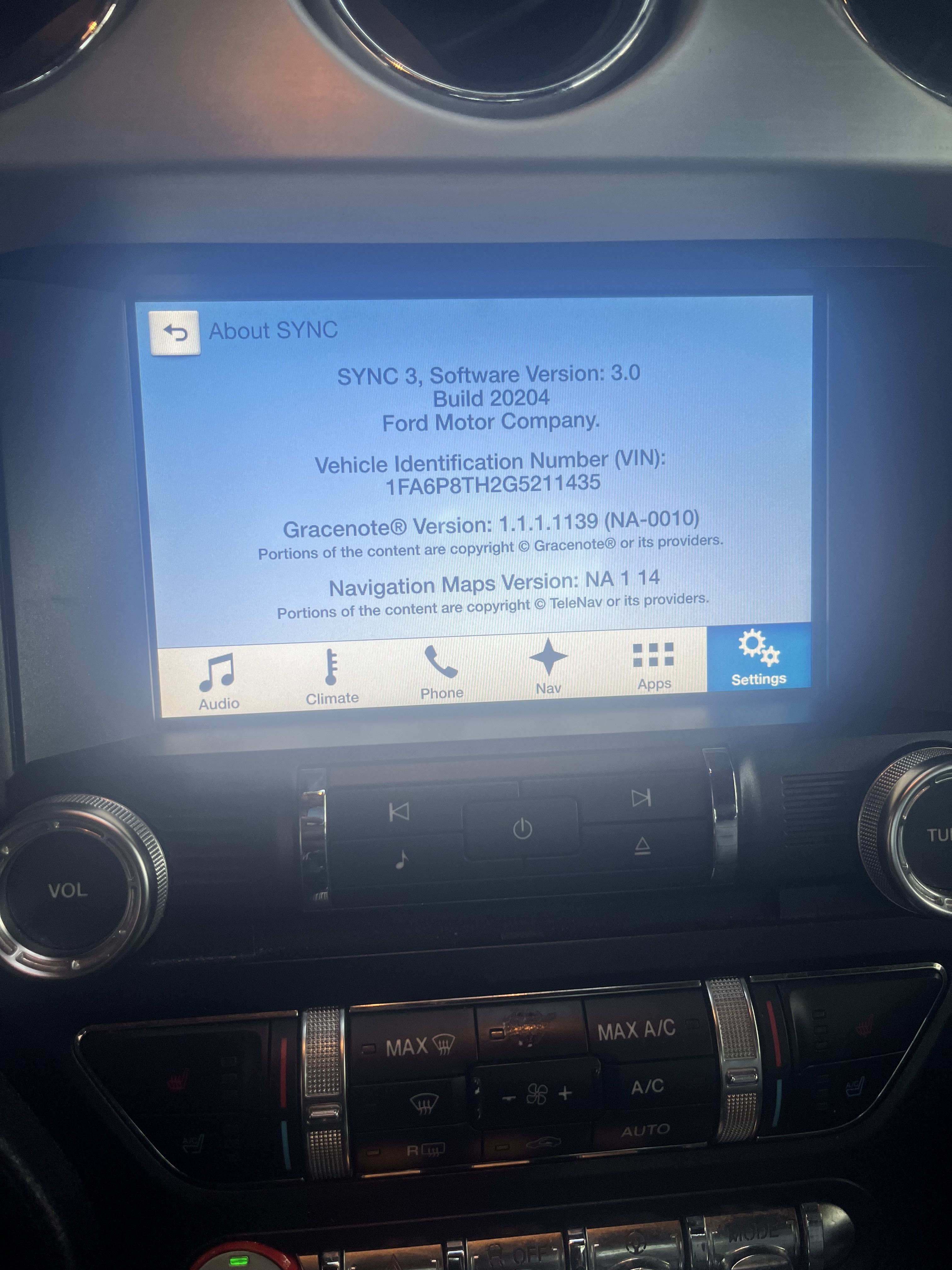

I’m having an issue where i updated the software from v1 to 3.02024 in my 2016 mustang and in the settings it says its on 3.02024, but it hasn’t changed anything. Like the navigation icon hasn’t changed or any of the other ones as well as android auto being there as it should be. Where should I go from here?
Old SYNC Version: 1.0
New SYNC Version: 3.02024
no error message it said completed but none of the update features are appearing
You probably won’t get Carplay anyway unless you have changed the hub.
You say it is showing the updates in the settings…3.0.20204, does it show the maps version as well and if so, what is it?
yes thanks, I have the hub on the way. When i go to the settings in my car it’s 3.0.20204. It still has first version of maps, but i dont really care about that very much I just will use apple car play mostly. its still looks like the version 1.

okay thank you. I will try to do that when i get home i was just a little worried about putting 3.0.20204 as the current version because it doesn’t appear to actually be on that version. I just don’t wanna mess up the system i’ve read about people getting black screens that pretty much breaks it.
There are no visual changes in the build. its all back end, eg supporting new BlueTooth specs.
3.0 looks like 3.0 not 3.4, just as 3.4 doesn’t look like 4.0.
I don’t really mind how it looks with everything i mostly just want the apple car play along with those features. From what i’ve seen there is visual changes from sync 1.0 to 3.0 like a lot of the icons changing and the nav at the bottom being different. And with 3.4 that’s when it’s the blue interface right?
so there is no way to fix the version 3.0. 20204
to how it’s supposed to be? I’m a little skeptical to go to the 3.4 version because i’ve seen a lot of people mess up their system.
