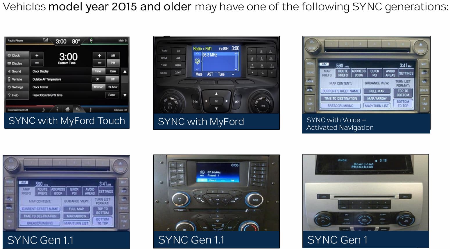

Get the right harness because you did not have Sync 1.
Actually its 2016 not 2015, the Fusion as an example didn’t make the jump out of MFT etc until 2017
My point is that the Fusion jumped out of Sync 1 in 2012 and went to MF/MFT or 1.1 in 2013.
To many people get it wrong when they say Sync 1. This picture is straight from Ford.
The Explorer is another Example as it left MFT in 2017.
