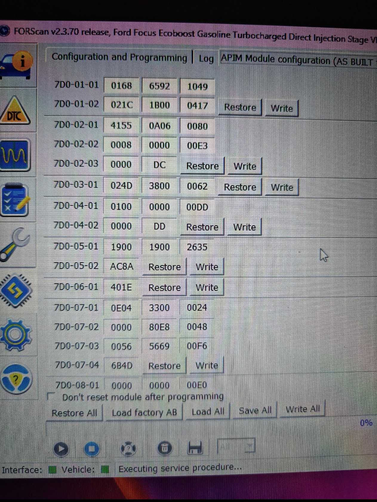

To my problem, I upgraded from my Sync2 with Nav to a Sync3 64GB with Nav EU, everything works fine, except. When driving… i can drive forward and backwards, the maps show this correct, GPS has enough satellites and is happy. When I turn left with my car, the integrated maps turn right. When I turn right, maps turn left. And well, yes, I kinda drift off. Since I am pretty new to this, I would appreciate any help. I drive 2015 Ford Focus Mk3 facelift titanium and tinkeree a little with forscan but its really confusing as a beginner with these values :slight_smile:

This is usually due to either the asbuilt coding or how the APIM is physically mounted. In your vehicle it should be mounted to the rear of the screen, I believe, top of the APIM facing the front of the vehicle.

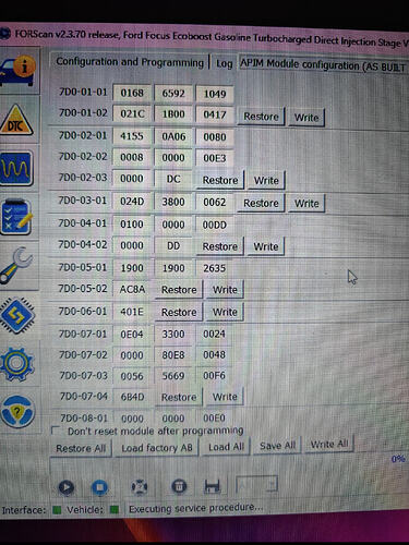

thanks for the reply, I already figure it out, the Y axis was programmed wrong, I set 7D0-07-02 from 80E8 to 1356 and now it works fine. :slight_smile:
