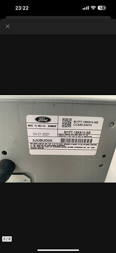

The part number is M1PT-18K810-AC. Second one was with the ending AB
That is the ACM. Need APIM. You can get the info from FORScan in the Configuration tab next to the log screen.
Please see the screenshot, I’ve disassembled the unit. The one from the photo was bought
That is your radio, not the Sync APIM.

The unit you show in the pictures is NOT the APIM, it is the ACM, CJ5T-19C107-HB.
It has nothing to do with this.
