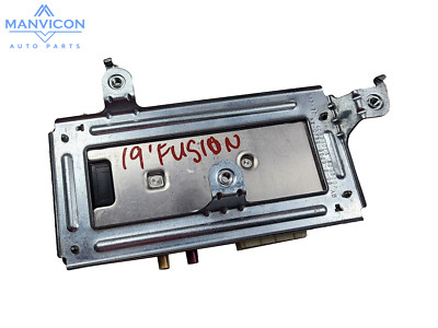

TCU mounting point in the 2019 Mondeo/Fusion is in the trunk on the back left side inner structure. Pull the trunk liner and if there’s a cable it will be in the area between the outer body and inner structure.
Here’s what the bracket looks like (which won’t be there) but you can use cable ties in the square holes it would mount to if you want to put it there.
