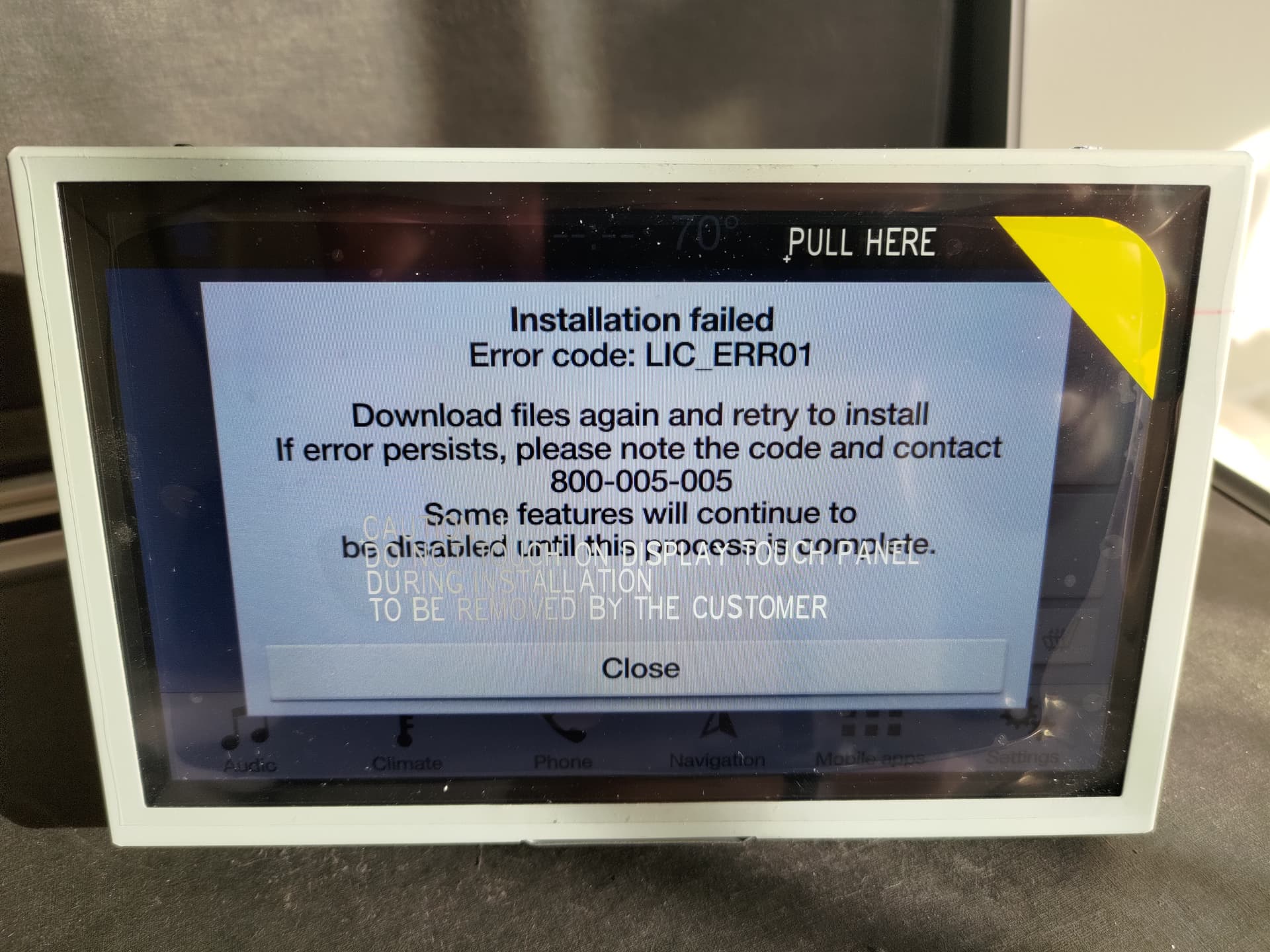

Hello, I came across a SYNC MY20 with a really curious version, indeed it is version 4.224 rev 17013_DEVTEST
Impossible to update it, I have an error message LIC_ERR01
SYNC Region: ANZ
Install Type: Unknown
Old SYNC Version: 4.224.17013
New SYNC Version: 3.4.22110
LIC_ERR01
Youre going from version 4 to version 3, thats a generational backstep

Is this SYNC 3 or SYNC 4? because it sounds like SYNC 4, either way it’s some DEVTEST version so it won’t have a production CERT so won’t be able to run production signed code.

I need to see a pic of that screen.
Gaz
(Gaz)
27 February 2023 21:13
5
I confirm that it is indeed a SYNC 3, I am convinced that it looks like the very first software version or we could not go directly to version 3.0 we had to update to 2.0 or 2.2 before going in 3.0 or 3.4, however the software that you make available to us does not have the possibility of loading 2.2

I unlocked the SYNC 3 to install a program that erases all navigation data in order to recover space on the disk and install a version 3.4 US navigation but I get an error LIC_ERR01
