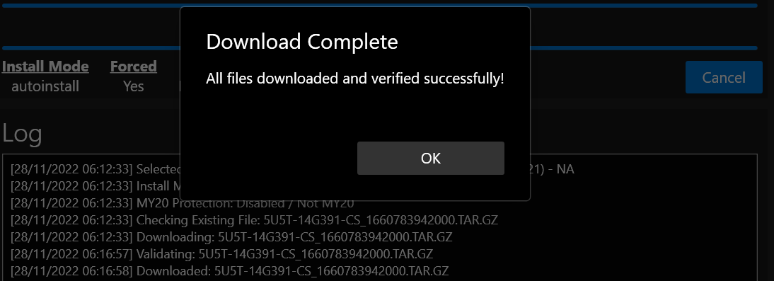

I think I figured it out.
Apparently when I made my post it recognized the file name and left a link behind (smart feature!), which I was able to follow to download the file. I dropped it in my Syn3 directory and now it doesn’t have to download it and everything is validating fine. Just waiting for the files to transfer to USB.
Thanks all.
This points to your connection or Ford’s servers not liking the multithread download Syn3updater uses… that’s why I suggested earlier to force Syn3updater to use a single download thread… When you download the file via a browser, it uses a single connection…
