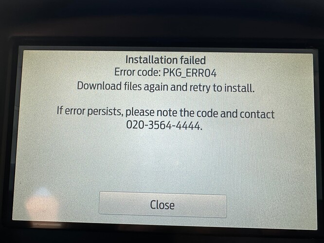

Erm…‘Update Failed’

I’ve tried it twice and it both times the Sync screen shows this error message. Is this in reference to trying to run the interrogator or what the original problem was?

First this can’t be “official Ford” for an upgrade method since you went from Sync3 3.0.x to 3.4.x
What are you trying to install now?
That error is the kind of thing that shows if your on 3.4.x and try to do a reformat without selecting “downgrade” as the reformat tool is not supported by Sync 3.4.x

To get the above I just opened the .Ist into notepad and then copied and pasted the result above. I know a little knowledge is a dangerous thing, but given the ‘PKG_ERR04’ in the picture I posted above the FAQs are stating…
** One of the packages you are trying to install has been blacklisted on the version you are presently using.*
** The most common time this happens is when trying to use the [reformat] utility. Downgrade your apps version to 3.4.19101 or lower, or use the ‘downgrade’ functionality of the [Syn3 Updater], then re-run [reformat] utility.*
Should I just follow the instruction above? :man_shrugging:
