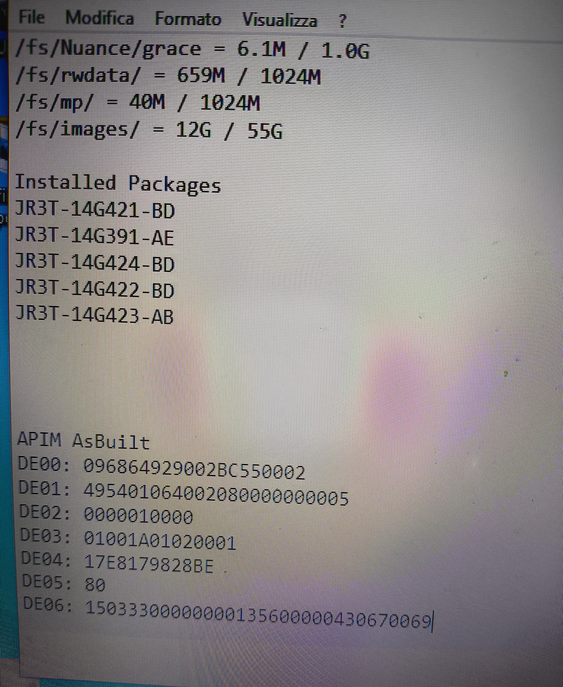

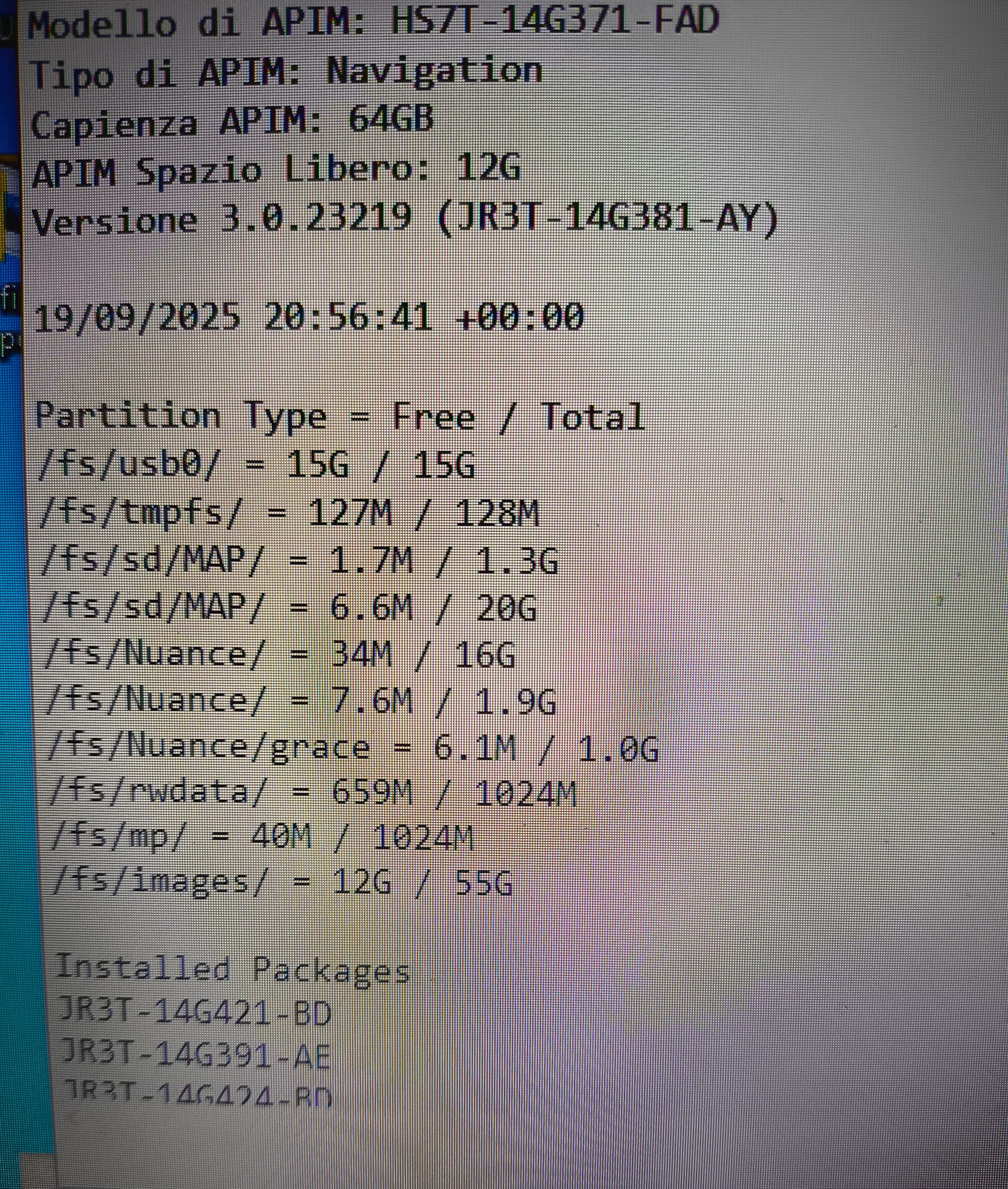

Run the Interrogator Utility to determine if the unit is MY20+. Post the XML here…you could have other issues that the utility might point out.
yeah please run interrogation and post the file here

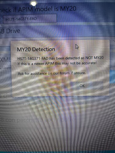

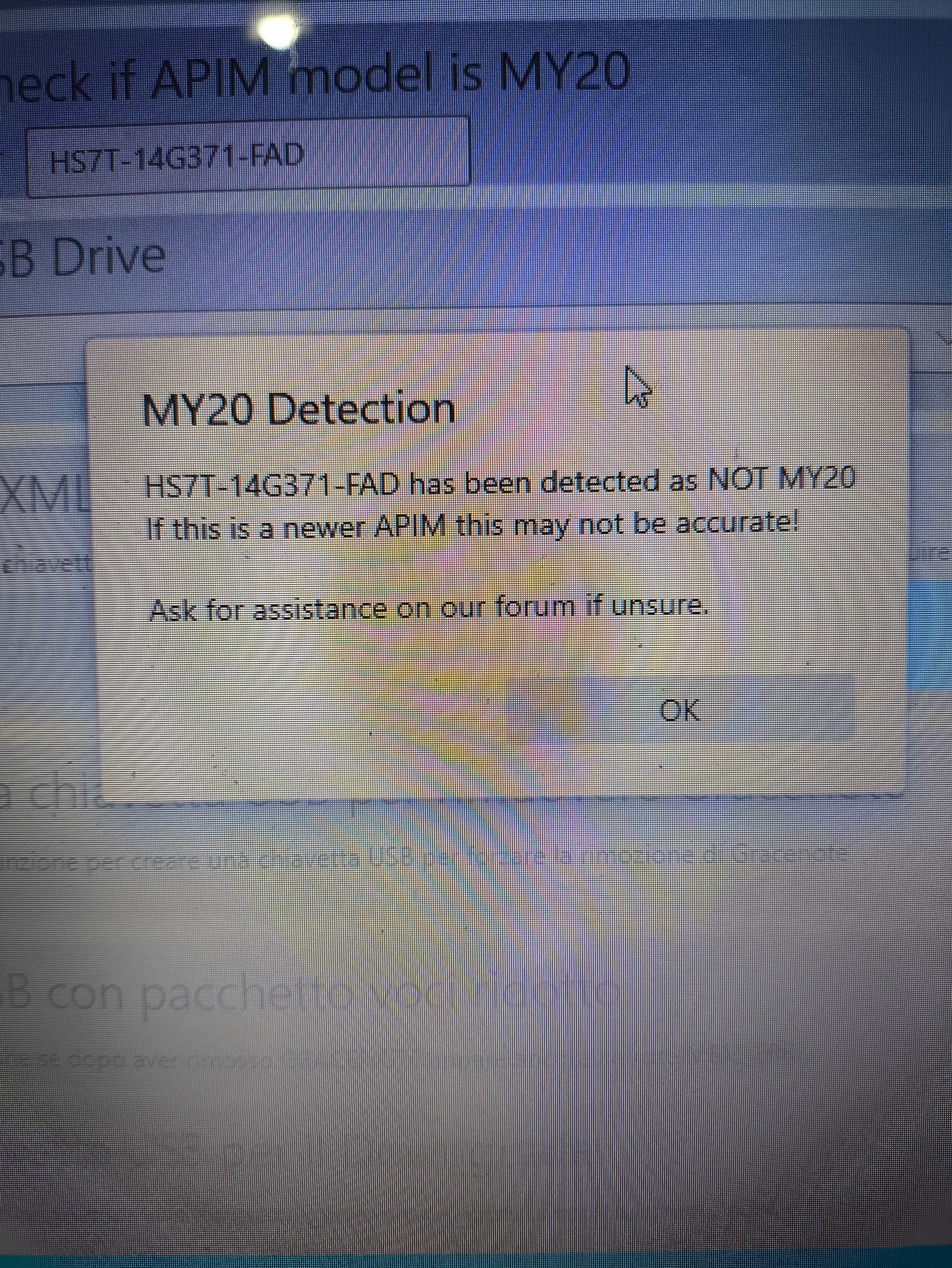

I tried to check manually and this is the message.
I don’t know if is correct I didn’t see any XML file.
I understood how to do it. In your opinion can I upgrade?
Bro your APIM won’t get bricked as long as you follow the CyanLabs Sync 3.4 upgrade steps. Only flashing apim with forscan might brick it and for now you don’t need to. Simple upgrade using Syn3 Updater will be good for you.

HS7T-14G371-FAD is NOT MY20+. You can reformat the unit to Sync 3.4 and F13 maps.
