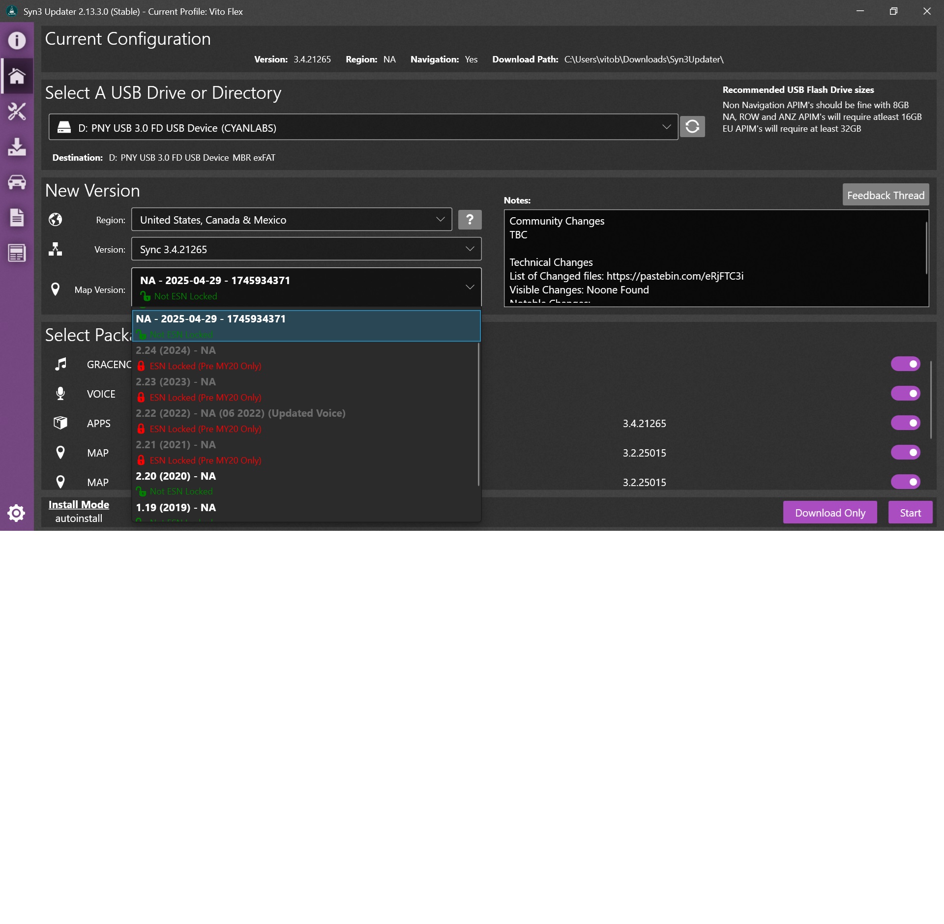

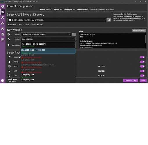

Which map version should I be installing

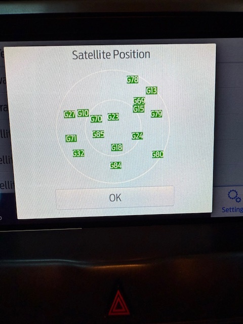

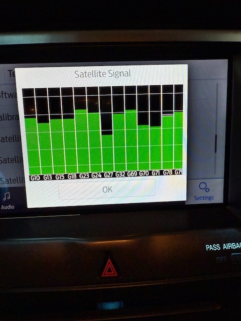

Ok I was able to access he test menu. Here are some pics of the satellite
