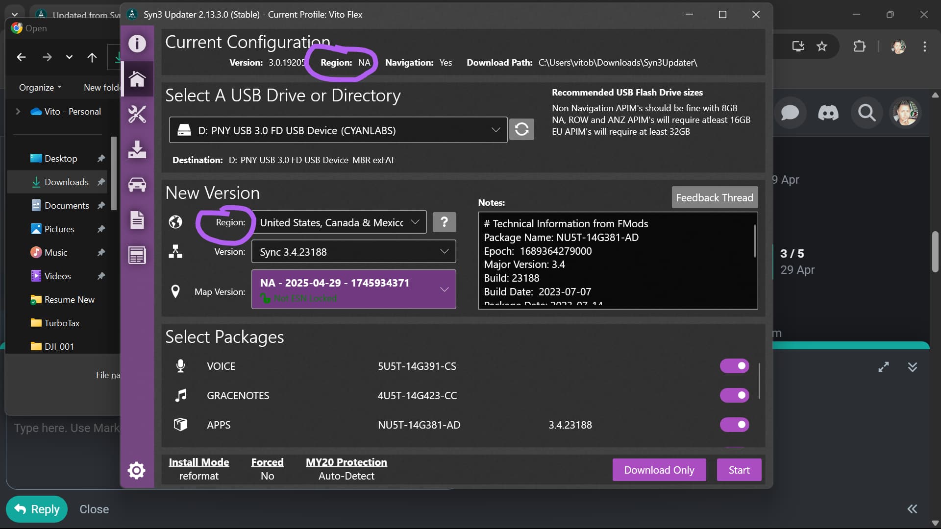

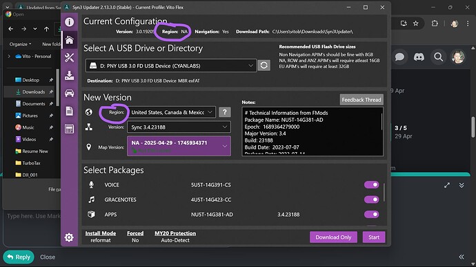

Need some help please. I updated from Sync 3.0.19205 and Nav version NA 1 17 to SYNC 3.4 Build 23188 and Nav Map version NA 2 24 all went well no errors however I see a couple issue. The time is off by 4 hours and evertime I change the time it go back ahead by 4 hours a few seconds later. Also when I click Map all I see is the directional curser and the POI no map. Need some help fixing this please. I have a 2019 Ford Flex

; CyanLabs Syn3Updater 2.13.3.0 Stable - reformat  Mode - Sync 3.4.23188 NA
FILES (8)
[4/29/2025 9:47:51 AM] Selected Region: NA - Release: Sync 3.4.23188 - Map Version: NA - 2025-04-29 - 1745934371
[4/29/2025 9:47:51 AM] Install Mode: Auto-Detect (reformat) Forced: False
[4/29/2025 9:47:51 AM] MY20 Protection: Auto-Detect
[4/29/2025 9:47:51 AM] Formatting USB drive
[4/29/2025 9:47:51 AM] Re-creating partition table as MBR and formatting as ExFat on selected USB drive
[4/29/2025 9:48:00 AM] Checking Existing File: 1u5t-14g386-cb.tar.gz
[4/29/2025 9:48:00 AM] Validated: 1u5t-14g386-cb.tar.gz (Skipping Download)
[4/29/2025 9:48:00 AM] Checking Existing File: PU5T-14G386-BB_1690840002000.TAR.GZ
[4/29/2025 9:48:00 AM] Validated: PU5T-14G386-BB_1690840002000.TAR.GZ (Skipping Download)
[4/29/2025 9:48:00 AM] Checking Existing File: 5U5T-14G391-CS_1660783942000.TAR.GZ
[4/29/2025 9:48:04 AM] Validated: 5U5T-14G391-CS_1660783942000.TAR.GZ (Skipping Download)
[4/29/2025 9:48:04 AM] Checking Existing File: 4U5T-14G423-CC_1615429225000.TAR.GZ
[4/29/2025 9:48:11 AM] Validated: 4U5T-14G423-CC_1615429225000.TAR.GZ (Skipping Download)
[4/29/2025 9:48:11 AM] Checking Existing File: NU5T-14G381-AD_1689364279000.TAR.GZ
[4/29/2025 9:48:19 AM] Validated: NU5T-14G381-AD_1689364279000.TAR.GZ (Skipping Download)
[4/29/2025 9:48:19 AM] Checking Existing File: 4U5T-14G421-CAH_1739451493000.TAR.GZ
[4/29/2025 9:48:19 AM] Downloading: 4U5T-14G421-CAH_1739451493000.TAR.GZ
[4/29/2025 9:50:35 AM] Validating: 4U5T-14G421-CAH_1739451493000.TAR.GZ
[4/29/2025 9:50:44 AM] Downloaded: 4U5T-14G421-CAH_1739451493000.TAR.GZ
[4/29/2025 9:50:44 AM] Checking Existing File: 4U5T-14G421-CBH_1739452251000.TAR.GZ
[4/29/2025 9:50:44 AM] Downloading: 4U5T-14G421-CBH_1739452251000.TAR.GZ
[4/29/2025 9:53:20 AM] Validating: 4U5T-14G421-CBH_1739452251000.TAR.GZ
[4/29/2025 9:53:33 AM] Downloaded: 4U5T-14G421-CBH_1739452251000.TAR.GZ
[4/29/2025 9:53:33 AM] Checking Existing File: 4U5T-14G421-CCH_1739452486000.TAR.GZ
[4/29/2025 9:53:33 AM] Downloading: 4U5T-14G421-CCH_1739452486000.TAR.GZ
[4/29/2025 9:56:14 AM] Validating: 4U5T-14G421-CCH_1739452486000.TAR.GZ
[4/29/2025 9:56:23 AM] Downloaded: 4U5T-14G421-CCH_1739452486000.TAR.GZ
[4/29/2025 9:56:23 AM] Preparing USB drive
[4/29/2025 9:56:23 AM] Checking Existing File: 1u5t-14g386-cb.tar.gz
[4/29/2025 9:56:23 AM] Copying: 1u5t-14g386-cb.tar.gz
[4/29/2025 9:56:24 AM] Validating: 1u5t-14g386-cb.tar.gz
[4/29/2025 9:56:24 AM] Copied: 1u5t-14g386-cb.tar.gz
[4/29/2025 9:56:24 AM] Checking Existing File: PU5T-14G386-BB_1690840002000.TAR.GZ
[4/29/2025 9:56:24 AM] Copying: PU5T-14G386-BB_1690840002000.TAR.GZ
[4/29/2025 9:56:24 AM] Validating: PU5T-14G386-BB_1690840002000.TAR.GZ
[4/29/2025 9:56:24 AM] Copied: PU5T-14G386-BB_1690840002000.TAR.GZ
[4/29/2025 9:56:24 AM] Checking Existing File: 5U5T-14G391-CS_1660783942000.TAR.GZ
[4/29/2025 9:56:24 AM] Copying: 5U5T-14G391-CS_1660783942000.TAR.GZ
[4/29/2025 9:56:45 AM] Validating: 5U5T-14G391-CS_1660783942000.TAR.GZ
[4/29/2025 9:56:54 AM] Copied: 5U5T-14G391-CS_1660783942000.TAR.GZ
[4/29/2025 9:56:54 AM] Checking Existing File: 4U5T-14G423-CC_1615429225000.TAR.GZ
[4/29/2025 9:56:54 AM] Copying: 4U5T-14G423-CC_1615429225000.TAR.GZ
[4/29/2025 9:57:21 AM] Validating: 4U5T-14G423-CC_1615429225000.TAR.GZ
[4/29/2025 9:57:35 AM] Copied: 4U5T-14G423-CC_1615429225000.TAR.GZ
[4/29/2025 9:57:35 AM] Checking Existing File: NU5T-14G381-AD_1689364279000.TAR.GZ
[4/29/2025 9:57:35 AM] Copying: NU5T-14G381-AD_1689364279000.TAR.GZ
[4/29/2025 9:58:54 AM] Validating: NU5T-14G381-AD_1689364279000.TAR.GZ
[4/29/2025 9:59:17 AM] Copied: NU5T-14G381-AD_1689364279000.TAR.GZ
[4/29/2025 9:59:17 AM] Checking Existing File: 4U5T-14G421-CAH_1739451493000.TAR.GZ
[4/29/2025 9:59:17 AM] Copying: 4U5T-14G421-CAH_1739451493000.TAR.GZ
[4/29/2025 10:00:53 AM] Validating: 4U5T-14G421-CAH_1739451493000.TAR.GZ
[4/29/2025 10:01:19 AM] Copied: 4U5T-14G421-CAH_1739451493000.TAR.GZ
[4/29/2025 10:01:19 AM] Checking Existing File: 4U5T-14G421-CBH_1739452251000.TAR.GZ
[4/29/2025 10:01:19 AM] Copying: 4U5T-14G421-CBH_1739452251000.TAR.GZ
[4/29/2025 10:03:04 AM] Validating: 4U5T-14G421-CBH_1739452251000.TAR.GZ
[4/29/2025 10:03:27 AM] Copied: 4U5T-14G421-CBH_1739452251000.TAR.GZ
[4/29/2025 10:03:27 AM] Checking Existing File: 4U5T-14G421-CCH_1739452486000.TAR.GZ
[4/29/2025 10:03:27 AM] Copying: 4U5T-14G421-CCH_1739452486000.TAR.GZ
[4/29/2025 10:05:18 AM] Validating: 4U5T-14G421-CCH_1739452486000.TAR.GZ
[4/29/2025 10:05:45 AM] Copied: 4U5T-14G421-CCH_1739452486000.TAR.GZ
[4/29/2025 10:05:45 AM] Generating reformat.lst
[4/29/2025 10:05:45 AM] Generating autoinstall.lst
[4/29/2025 10:05:45 AM] ALL FILES DOWNLOADED AND COPIED TO THE USB DRIVE SUCCESSFULLY!
