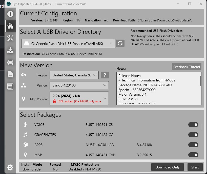

This is what I meant by setup (see picture) , this is how Updater is set up at this point.

Thanks, that looks good. APIM KU5T-14G371-CDF is not MY20 as per our DB, you should be fine.
As per the setup, it’s correct.
But I recommend you use a better USB device, not that generic one.
