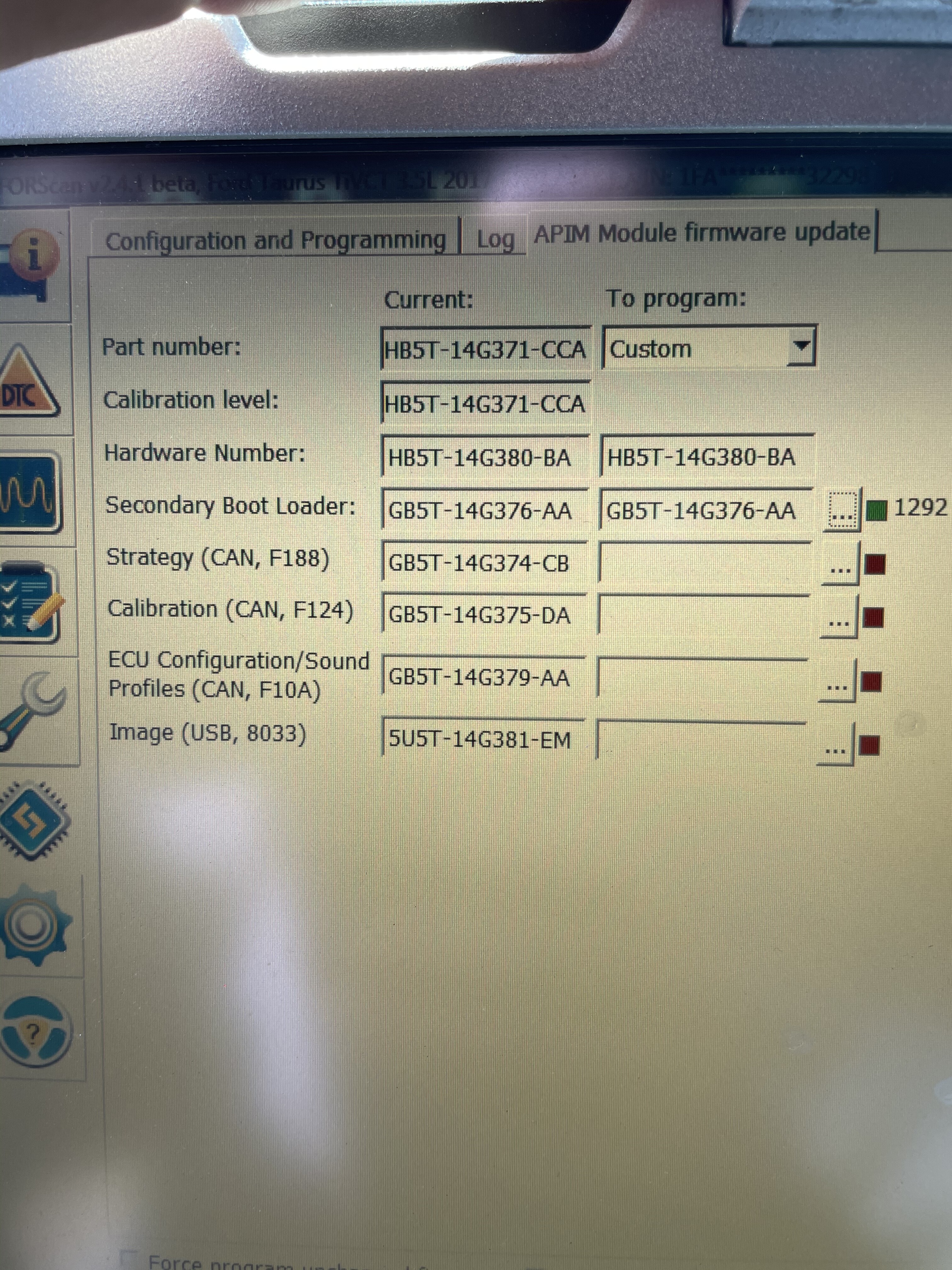

Updating APIM Firmware (Calibration Files)
For NON-NAV, -CA would be correct then…
It’s not a bad idea about flashing the firmware, but a matter of what it will get you. In this case, flashing the firmware will not enable any new features, since you are rather recent anyways. But it won’t hurt anything either.
Thanks…I’ll report back after flashing it
By the way, there is a much newer version of FORScan 2.4.3 beta available (2021-02-24). You appear to be using a build from 2020-09-20. If you are going to be doing any sort of flashing it would probably be best to grab the newest beta build to be safer as it also has a new recovery mode function in case things go wrong.
OK, so it boils down to a hardware limitation. Thanks. I was hoping to avoid sourcing a new APIM, but there seems to be no way around that in my case.
Also, thanks for the link though I’m already up to date on that thread. I didn’t find a whole lot more information relating to updating the firmware on ‘G’ APIMs, other than a generalized statement that some users have reported difficulty. Your earlier post was the first instance I could find of someone seeming to know more details related to it!
Thanks! I noticed this too and did update to the 2021-02-24 release shortly after capturing that screen grab. :wink:
I was actually thinking I may even have to downgrade to 2.4.0 as there were some earlier posts about 2.4.3 having bugs that were causing issues. Not entirely sure if they’ve been addressed in the latest release of 2.4.3. But it seems my best route will be to source a newer APIM anyway, so once I get that newer APIM up and running, then I may go back and play around with the original APIM to see what damage I can do ahaha
If I recall correctly, FORScan 2.4.3 beta available 2021-02-24 and 2020-09-20 were never released on the FORScan website. These were test builds to resolve issues. The last release on the website was 2.4.2.
2.4.0 has issues on it’s own. I would stick with the latest build unless you experience issues.
As far as the APIM, that really is the best way to go and it will just work. I’ve done a few and it makes life so much easier…and breaking the old APIM is one of the reasons I learned so much about this.

Hi folks,
today I tried to get the radio logos in my car - so I need to flash the APIM. My current strategy (CAN, F188) is GB5T-14G374-CB - After Forscan updated the APIM with HB5T-14G374-CA my radio display in the car stays black (forscan comes up with a message programming error - Module is bricked) and in the display between the speedo and tach it says something like “lost communication with audio unit…” - I am able to flash back to GB5T-14G374-CB which brings back my unit to live - this is no problem…what can it be when the display stays black ? does anybody had the same problems ?
This hardware is too old to update to the latest firmware levels with reliable results and performance. Not that you can’t, but you probably shouldn’t. This is a common issue with the Gen 1 Sync units. The J and K series units are far more reliable.

Wanting to know what calibration files I need to update my firmware
image|375x500
Please download the latest beta of FORScan 2.4.3:
FORScan 2.4.3 03.28.2021
It should then give you the option to download firmware files. You will need a paid extended license. Note this is still an un-released beta and you will have little support from FORScan if the firmware update process fails.
