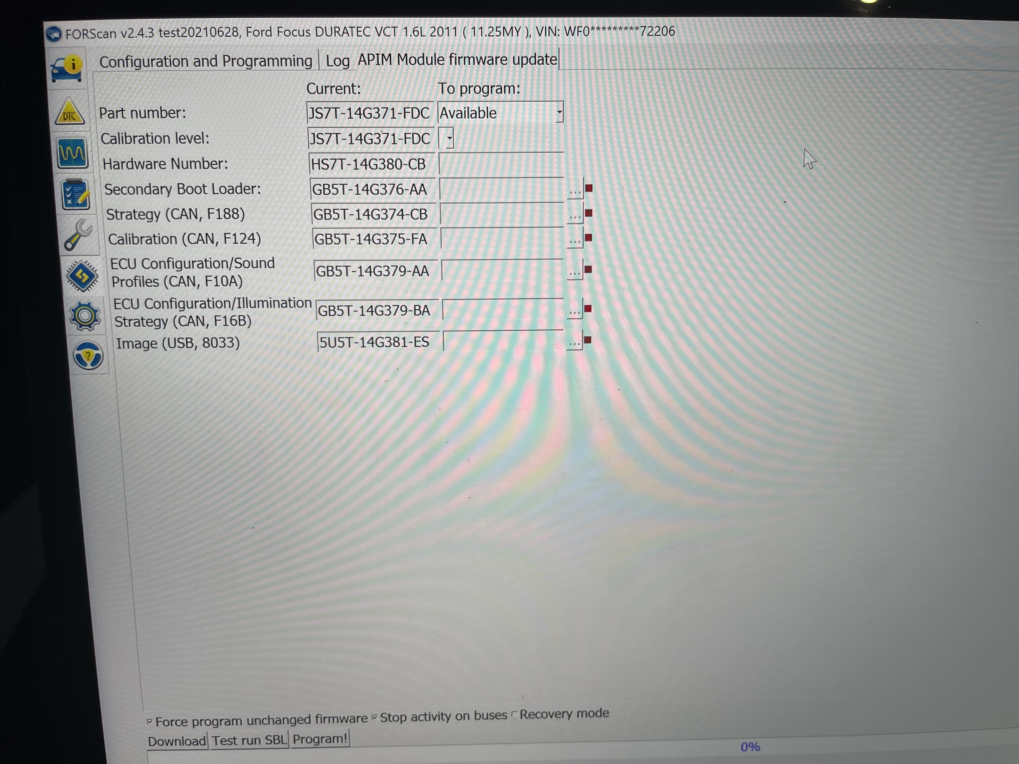

So after I tried to update the firmware, my APIM decided to act “weird”…

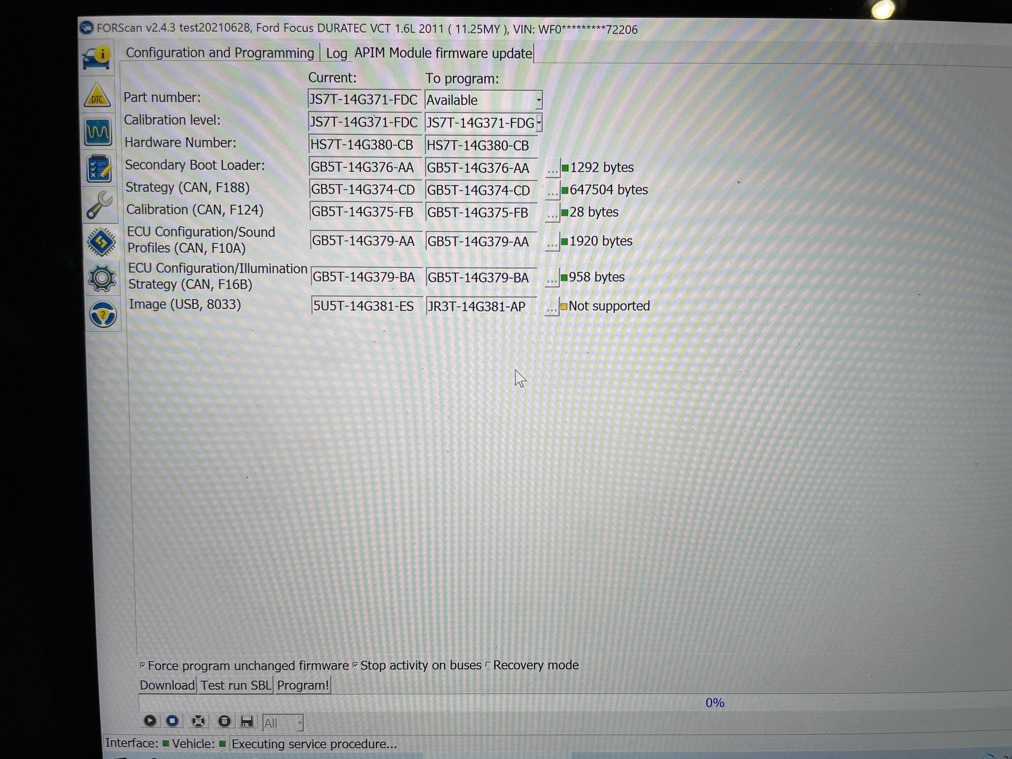

In FORScan, under the firmware update, it says that there is a new version (calibration level), but if I select any version from the list, other file names are exactly the same:
Does that mean that I’m already on the latest version?
I have tried force installing level …-FDG. Everything went ok and I got the success message:
But here comes the first “problem”. I have delete the profile in the FORScan, turned the car off for 10 sec and after that, when I read modules from scratch it says that calibration level is …-FDC (as it was before firmware update).

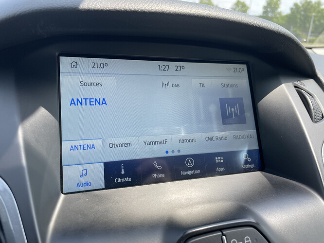

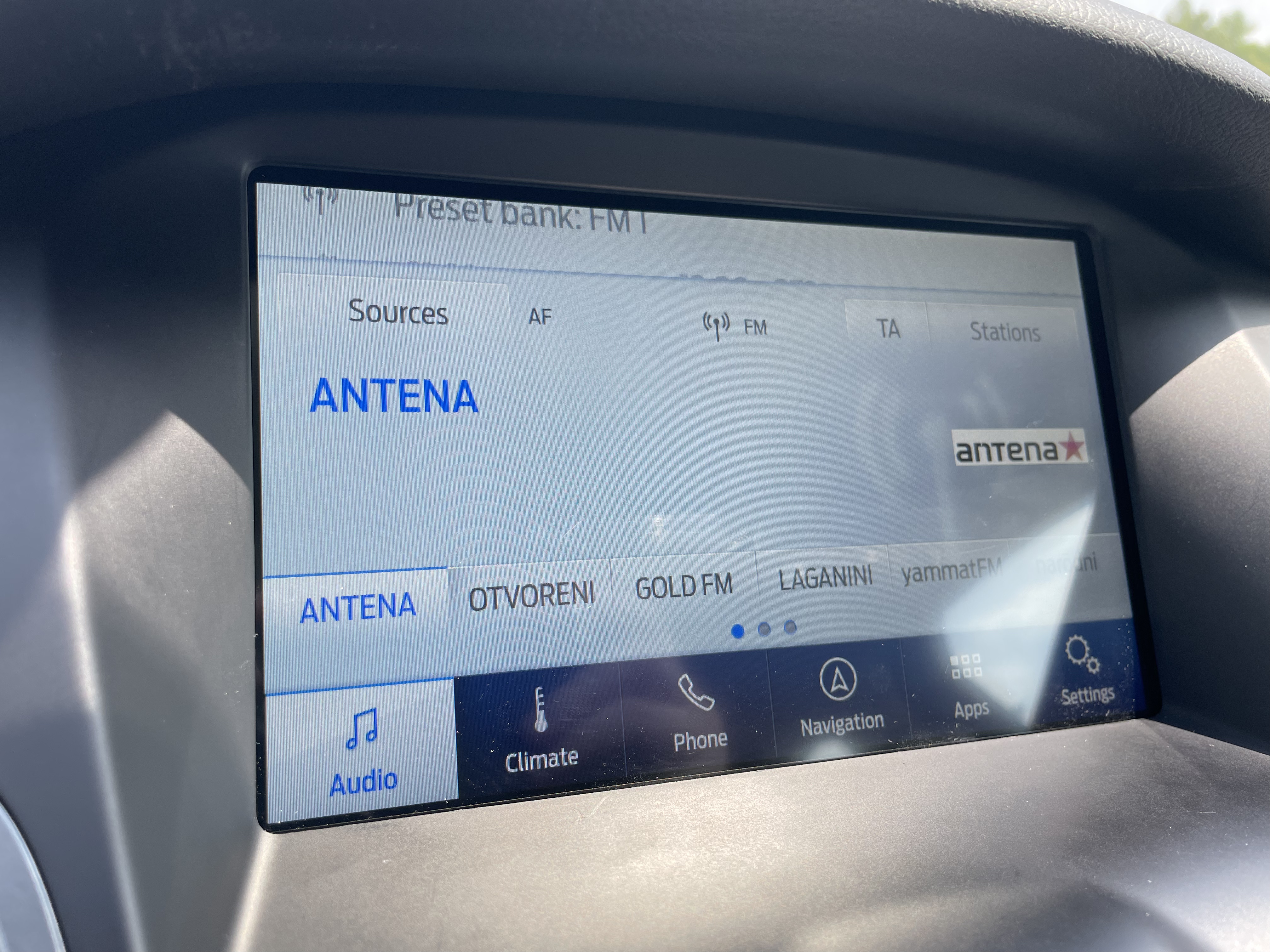

If I go to the settings of the Radio, I can se Radio Logo and when I turn it on, I’m getting logos for FM:
but there is no logos for DAB (this is the same station):

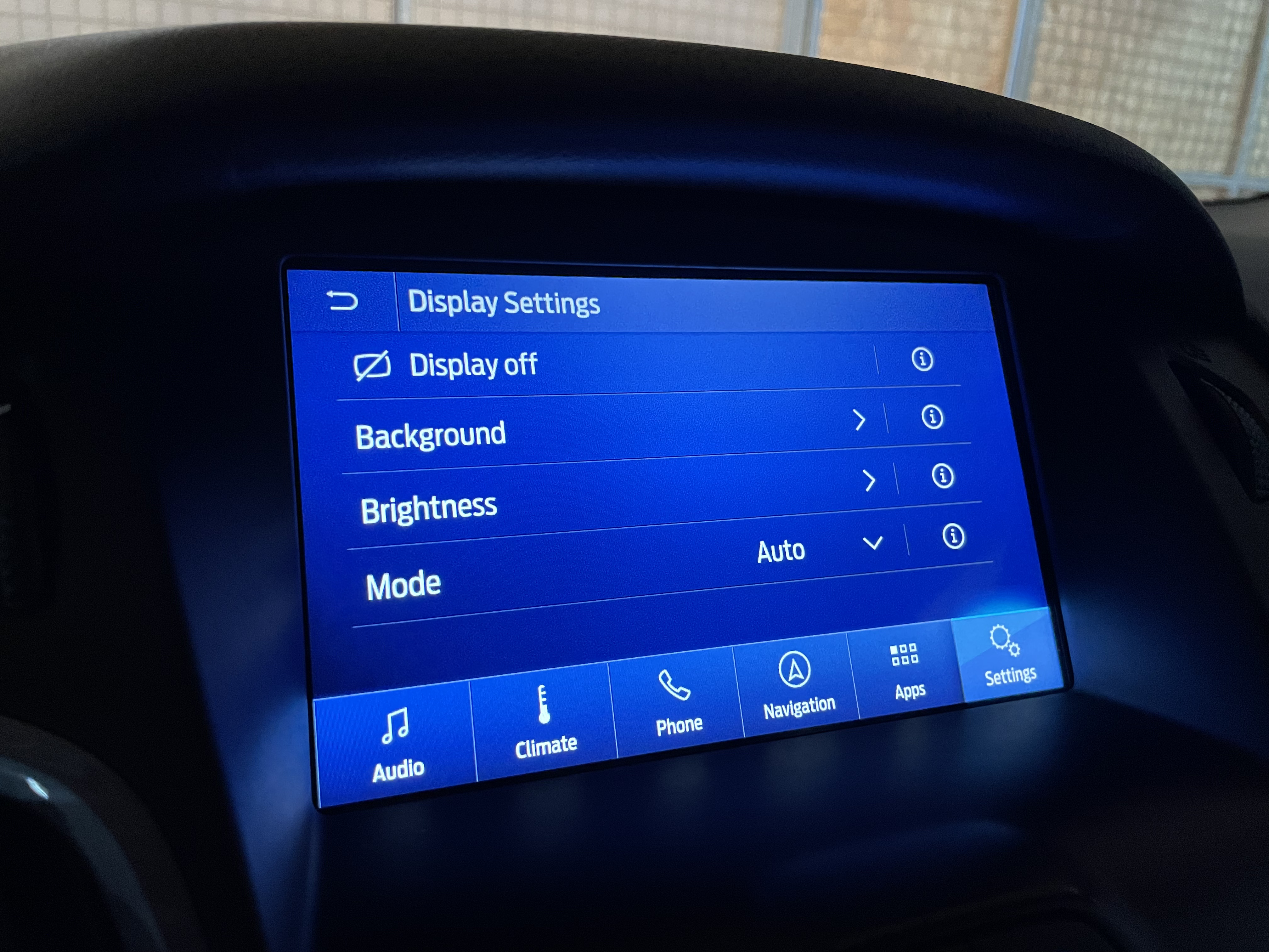

Inside Display Settings, initially, I had the Calm screen that worked. Once I turn off and back on the car, that option is missing again, while station logos are present:
So my question is what am I doing wrong? Is this normal that there is no DAB logo, while the FM logo is present (on the sync 3 installer, I have left everything enabled so logos should be installed)? How does it come that I’m missing calm screen after car on/off, while logos are still present? And, is this normal that FORScan is always showing that APIM has a new version, install goes ok, but whatever I do it always stays on original …-FDC calibration level?

I have changed the value 6 to 0 and then back to 6 and everything was present until the next time I have turned off/on the car… After that, the calm screen is missing, and under the stereo settings, some DAB+ options (e.g. slide show) went missing as well.

Reflash back to -FDC and check “Force program…” silence the busses, and recovery mode at the bottom of the screen. I think you might have a firmware corruption.
Be sure to clear all DTC’s after that.

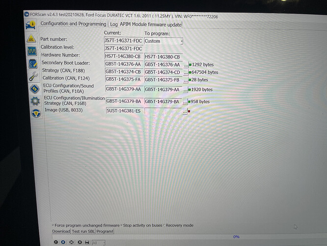

There is still an issue with the unit firmware, I believe. I’ve attached the previous versions. You can load these and see if the unit works, then upgrade back to the current versions. If there is a load corruption, this should clear that. You will need to set FORScan to 'Custom" and load only these 2 files. (Along with the SBL.)
You might also try loading newer files with a custom load. Look at ChrisDD’s post above.
After flashing firmware with those files (re-write AsBuild, clear errors), calm screen was not present at all. Then when I went to install new ones (downloaded via FORScan), initially I got warning “Unable to read current firmware… p/n: GB5T-14G379-BA” and list was empty:
I selected everything manually as it was before flashing with older files:
After that, I have re-writed APIM AsBuild (to get rid of the “not configured” error code, cleared codes) and calm screen was there. After performing master reset - calm screen was missing…
I have tried to install old and new files with selected and unselected “Recovery mode”. And I have tried skipping the master reset (once calm screen was visible) but after turning the car on/off, calm screen wasn’t there.

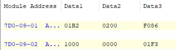

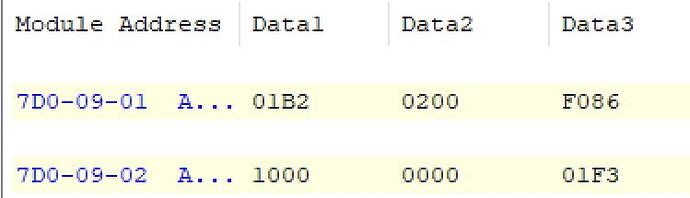

After flashing the ChrisDD’s files, everything now works as expected. All DTC codes are cleared, even when Master Reset is performed, calm screen and DAB+ features are present on the Sync. I didn’t play with 7D0-09… values, this will be a project for the next time, but for now, I’m happy that Sync 3.4, with all its features, works!
