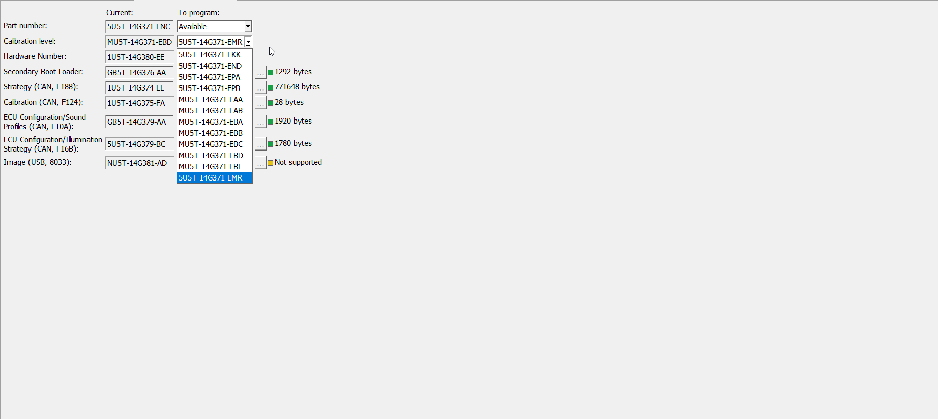

Hi all,
Given that the part number starts with 5UST and the calibration level starts with MU5T which file in the drop down list would be suitable for my car. I feel like the obvious choice is MU5T-14G371-EBE but when I choose that file, forscan alerts me that the file isn’t compatible with my hardware. My car is a 2021 Everest in Australia.
Edit: Looking back in this thread other posts show the first 10 characters of the part and calibration fields to be identical, why would mine be different?
M = 2021.
The latest Strategy file is 1U5T-14G374-EM. You are on -EL. That is the only difference. I doubt you will see anything useful in the -EM file for your vehicle.
Ok thanks very much for the reply, that’s good to know.

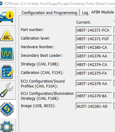

Hi,
What are the latest calibration files that I could use on the following current APIM please and where can I get hold of these files? This is an EU APIM with navigation. Thank you.
What are you trying to accomplish by going to a higher calibration?
Sometimes raising beyond what you’ve got causes compatibility issues with other modules.
Hi Warlock12118,
I need to get the CS options enabled in APIM to enable some features. That’s the reason for upgrading the calibration. Thanks.
