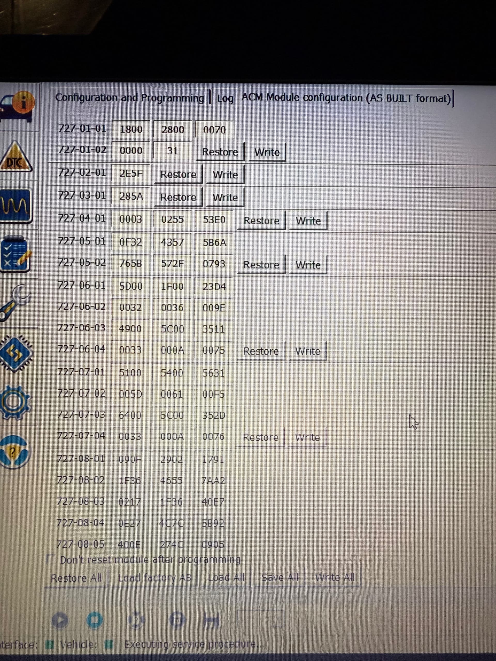

If you upgraded from Sync 1 to Sync 3:
In the ACM you will need to make sure the following setting is correct.
727-01-01 *xxx xxxx xxxx
Set for Gen 2 APIM.

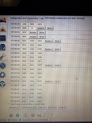

Having issues getting the interrogator log to work however here are the values I have for the ACM

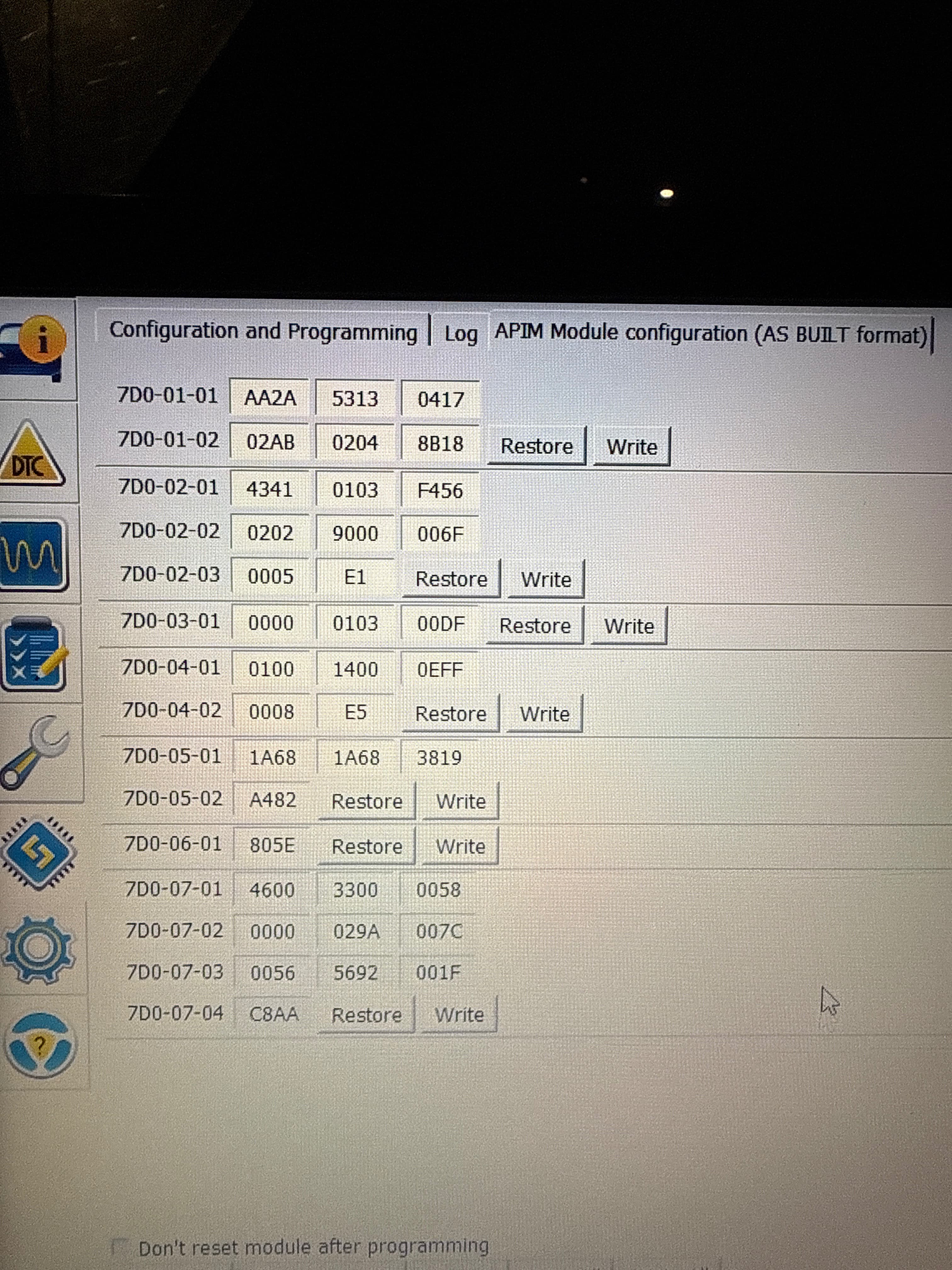

And the APIM

It looks like this APIM came from a n F-150 Platinum or similar trim level with a TCU.
Your APIM asbuilt is coded for a Sony DSP, which is the issue with the sound and EQ settings. 7D0-01-01 is AA2A, needs to be changed to not indicate a DSP if you had Sync 1 before. Try 2A2A.
I see the APIM is coded for NAV. Your APIM is also coded for 4341, which if you are in the US needs to be 5553 for the NAV to work properly.

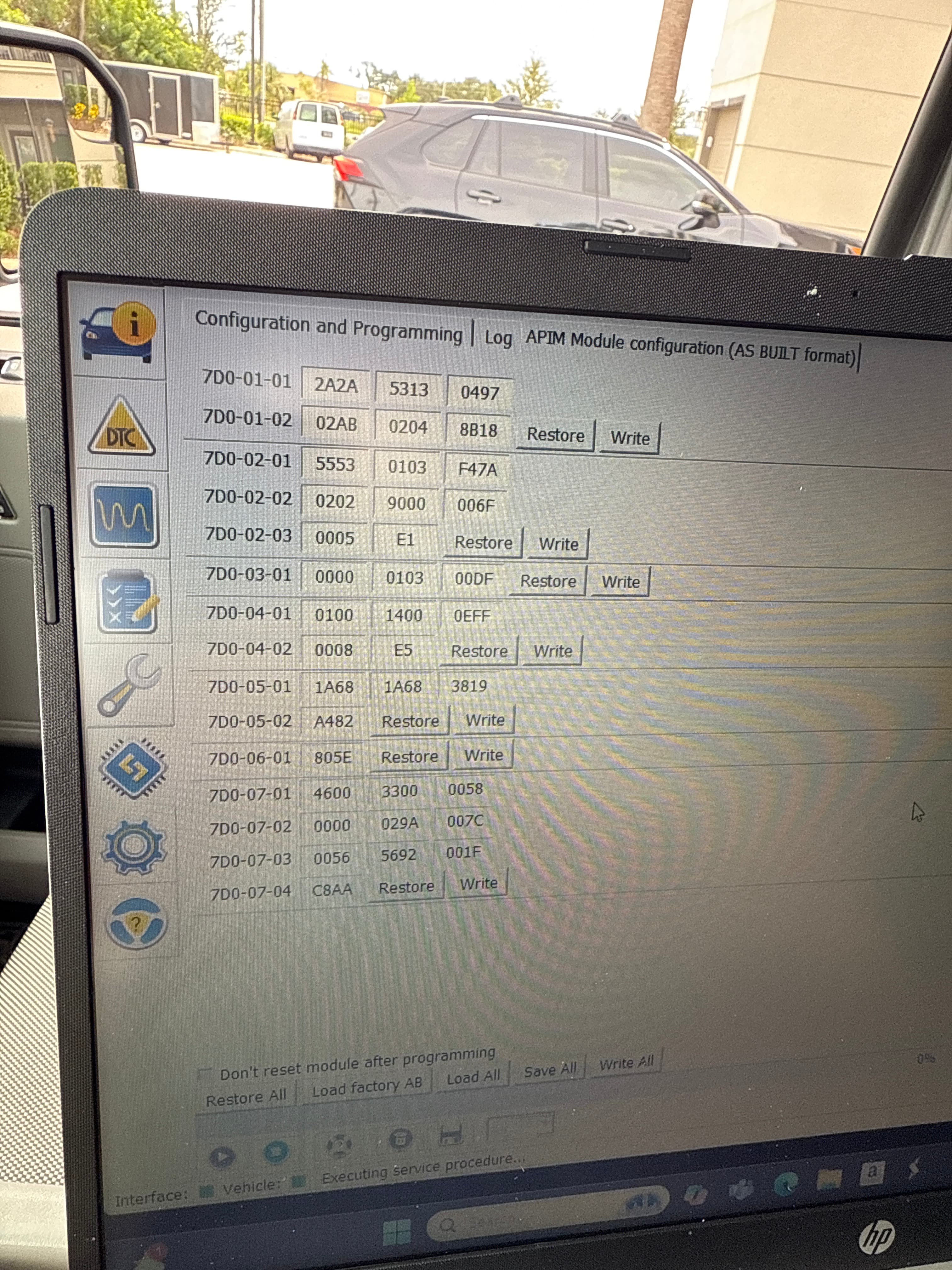

That worked! Here’s what we’re working with now
OK, let me take a look at it in a bit…

This is based from a 2017 F-150 XL with Sync 3. This should work without issue.
APIM - Accessory Protocol Interface Module (SYNC).abt (347 Bytes)
Load the entire asbuilt thru FORScan using the ‘LOAD ALL’ button at the bottom of the page and then ‘WRITE ALL’. FORScan will prompt you about the checksums, just accept and have FORScan write these. Reboot the APIM and see that it comes up properly.

Should I change anything with the ACM?
Nope. Not needed if the audio is all working.
