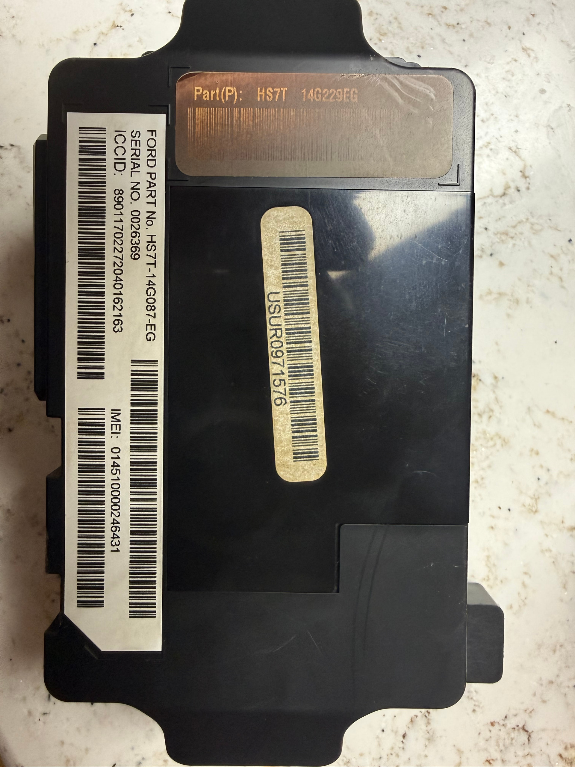

Except it did come with a TCU on the Energi models in 2013. My system used to work until the 3g system went down. Attached is a picture of the TCU I removed from the system and my asbuilt file. I used the old FordPass app until they stopped supporting the 3g system. I thought I could replace the TCU and get it working again.
3FA6P0PU8DR383289.ab (26.6 KB)
