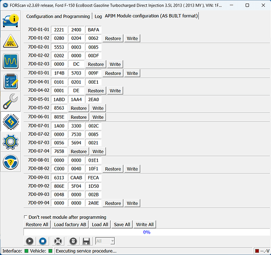

I have pasted my current asbuilt configuration in below

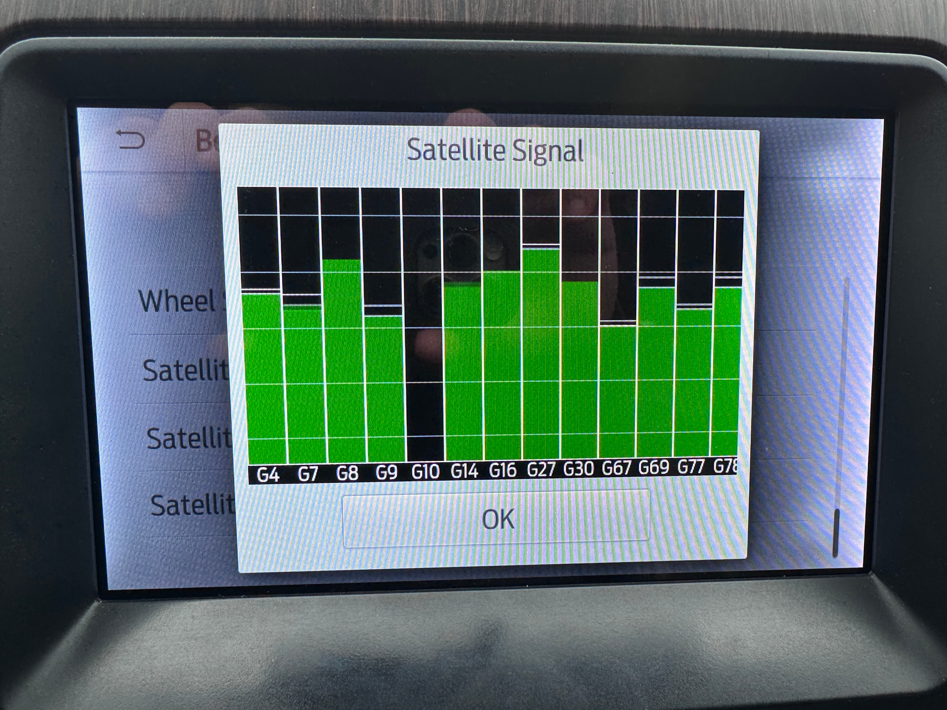

Have you gone into the diagnostic menu to see how many satellites the unit is picking up?
I used the GPS receiver that came with the kit, not sure if it even had a brand name on it (it was blue). I stuck it on the underside of the dashboard on the passenger side. I accessed the diagnostic menu and it looks like it is seeing plenty of satellites with good signal strength. I have a whole bunch of idea/questions but would appreciate any guidance or suggestions!

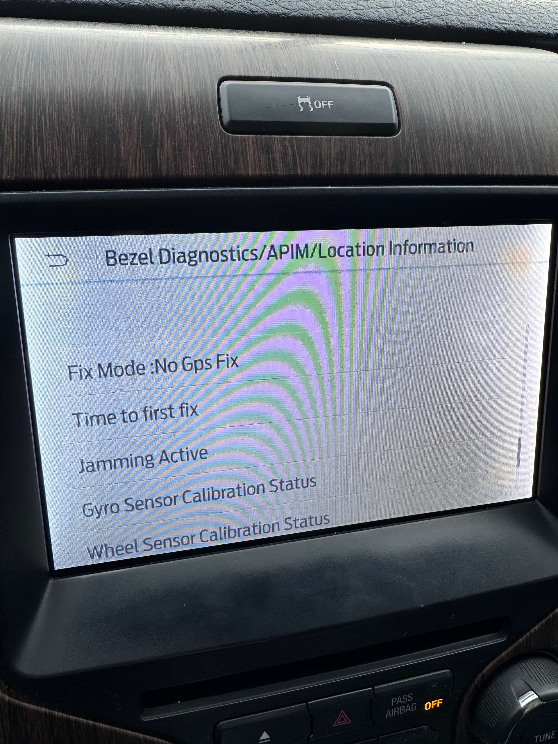

  • Scrolling through, does gpsfix: nogpsfix mean that it isn’t locking on despite the signal being there? Also i see the “jamming active” flag is there
  • Also I noticed that the compass direction is wrong, I was pointed east but the menu said north.

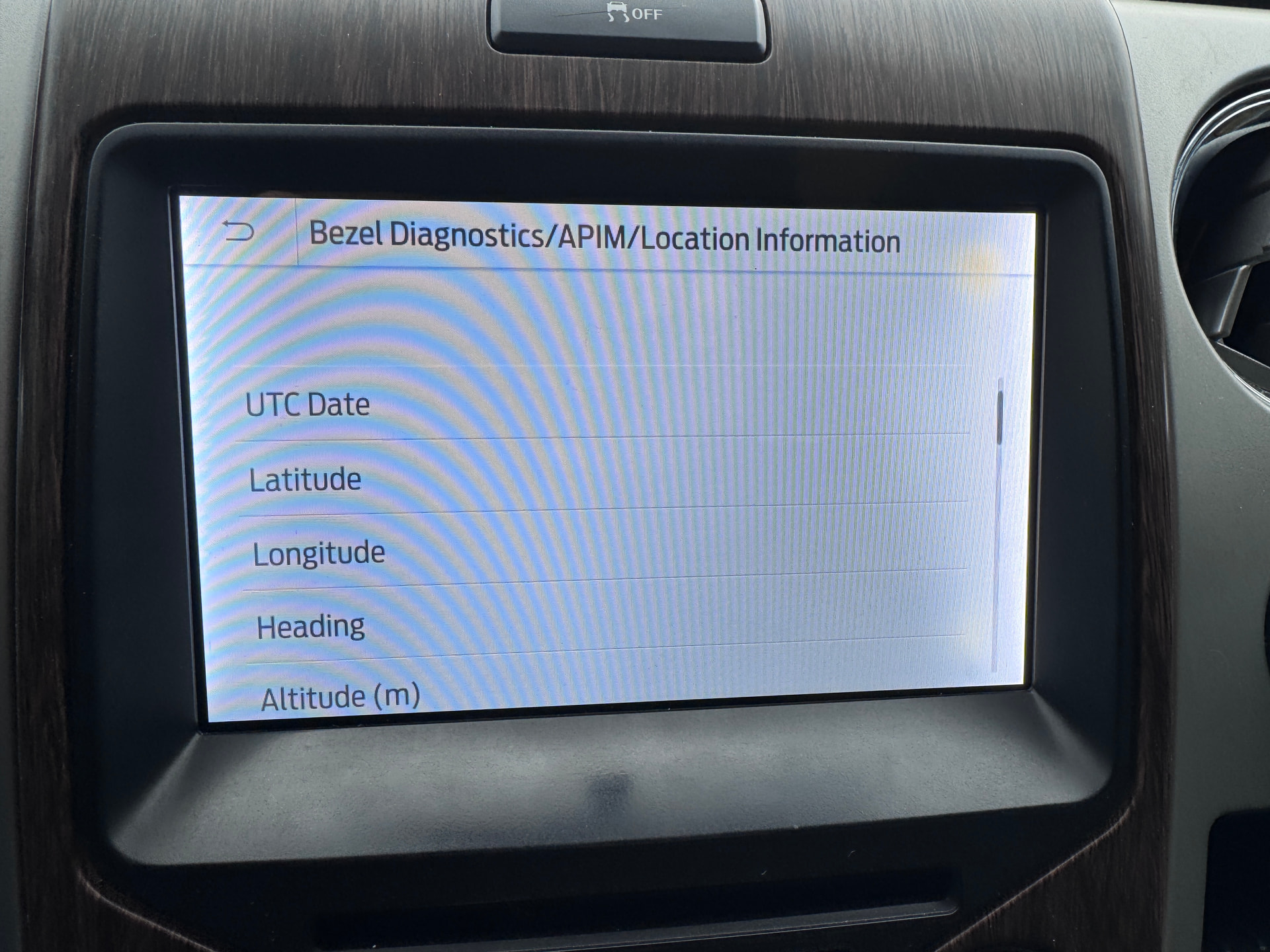

  • At the very top for latitude and longitude, should there be numbers there if it actually has a fix?
  • On a related note, about a week ago I came home from a work trip to a truck with a completely dead battery (combination of extreme cold plus a lot of time fiddling with the APIM with the engine off, dumb mistake!). I have replaced the battery but if there are certain modules/systems that require you to drive a certain time or over a certain speed or a certain distance to reset/calibrate, I almost certainly haven’t met that yet. Could this literally be fixed just by driving enough to reset the systems? In other words, does the system remain “jammed” until it is receiving data from all the wheel position and speed sensors, etc?

The blank values are not normal. This points to a bad APIM.
