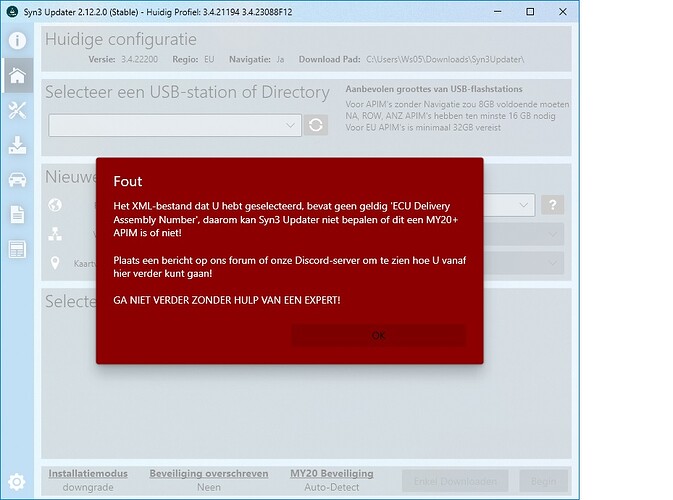

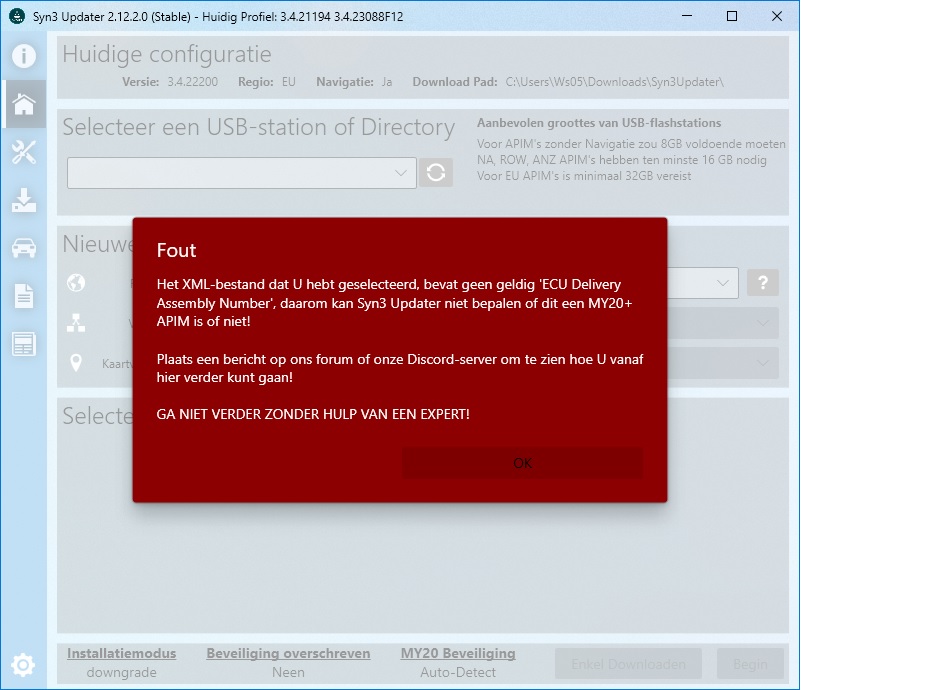

XML-file autodetect MY2020 error
When uploading a xml file after interrorgator tool i get an error that the xml file isn’t providing a correct ECU number
Old SYNC Version: 3.4.22200
XML file dosn’t hava a correct 'ECU Delivery Assambly Number"so therfore cync3update can not check if this is a MY20+ APIM or not
Syn3 Updater Version: 2.12.2.0

Well that VIN comes back as a 2021 Fiesta (2017 model) so treat it as a MY20 until you do a visual check of the labels on the unit.
Yep, APIM also has been renewed a few months ago so i’m sure its an after 20MY but the Sync3 updater dosn’t go further after this messages.
In the advanced settings override the my20 autodetect to yes/my20
