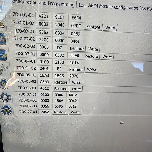

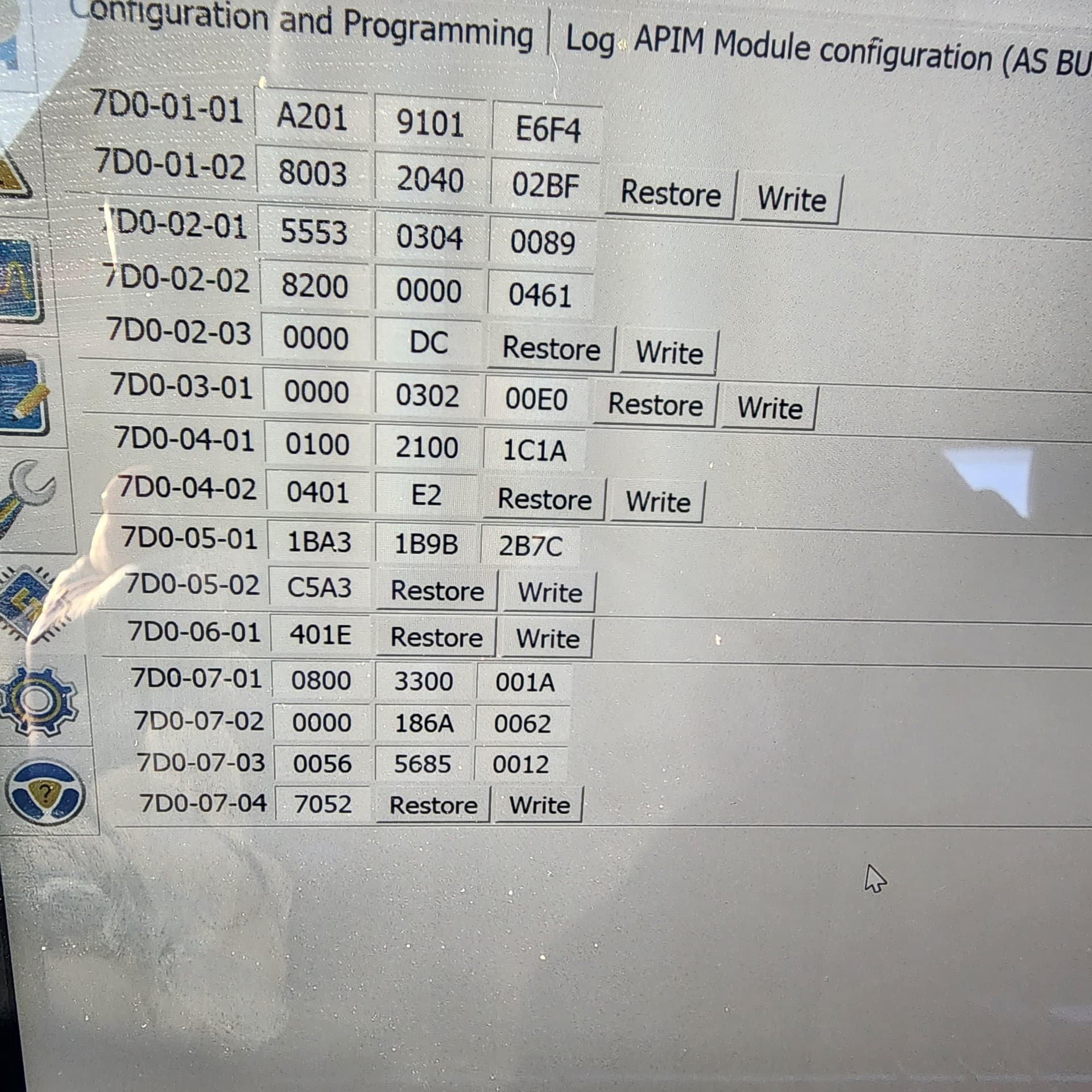

APIM AsBuilt
DE00: BLANK
DE01: BLANK
DE02: BLANK
DE03: BLANK
DE04: BLANK
DE05: BLANK
DE06: BLANK
Did you do a sync master reset after the upload to the car?
Yes a few times.
Upload the saved APIM config file from ForScan.
It sounds like you still have something amiss.
It would be easier for me to do if it was allowed on the forscan app vs having to use a laptop.
You’ll have to speak to the Russians that own the app about that one
Forscan has nothing to do with this. It is a limitation of the apps.
Anything wrong in the APIM ? I am actually thinking of switching back to sync 2 just to get everything working right. I just don’t know if I can live without Android Auto. Maybe time to sell it and get a newer MKX.
