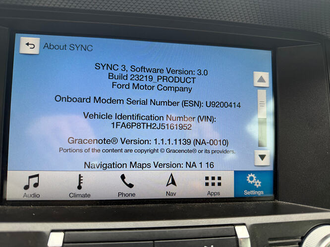

My Sync 3.0.23219 recognized ESN correctly after 1 day. 8 –> 9 in APIM changed.
The problem is that TCU stuck in Unprovisioned Mode. My APIM asbuilt:

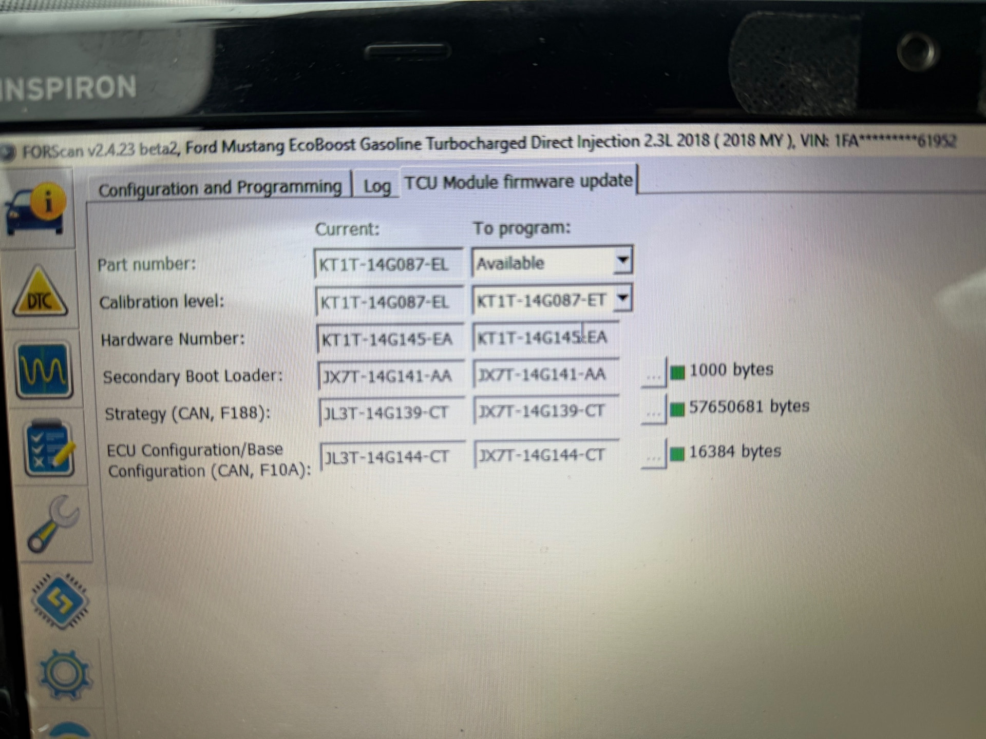

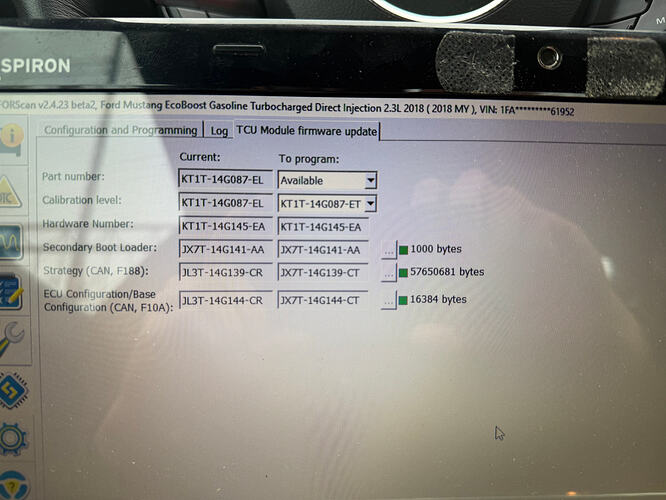

Currently used Firmware:
I’ve tried to change Country code in APIM to EU,UK,RS, tried to change B138 to B100, and deleting Fordpass.
Multiple Master reset performed too. Any ideas?
Firmware.
You need to update the TCU to -CT as shown as available and update the APIM firmware. You need to be on at least a J series firmware rather than an H series firmware in the APIM. You should upgrade to Sync 3.4 and The MY18.5+ firmware in the APIM to use this TCU.

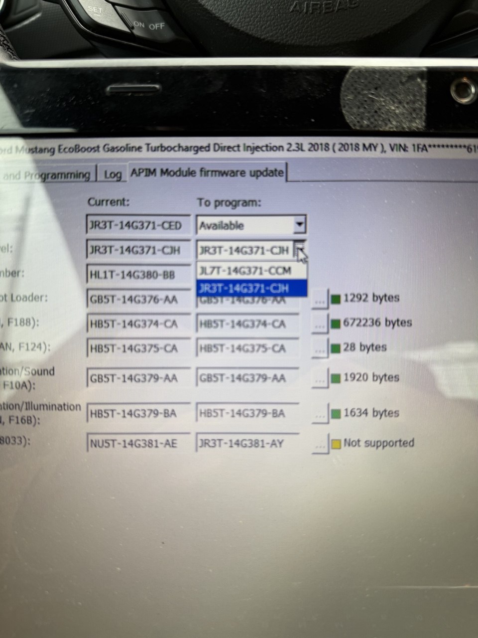

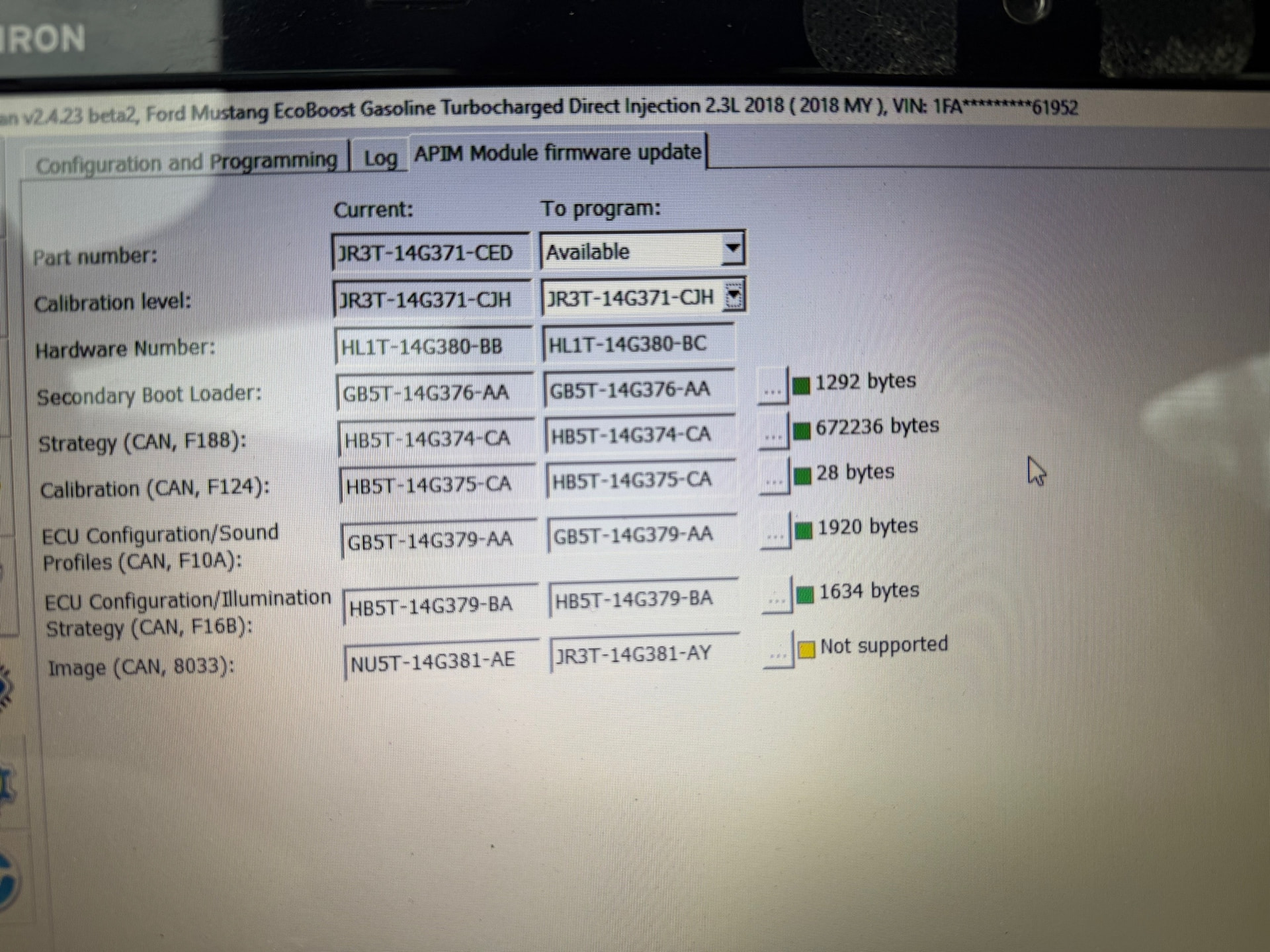

Ok, so APIM updated to latest CA available for my hardware

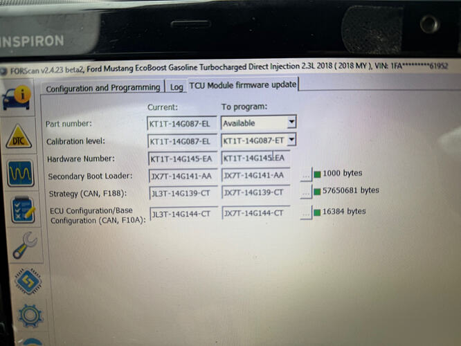

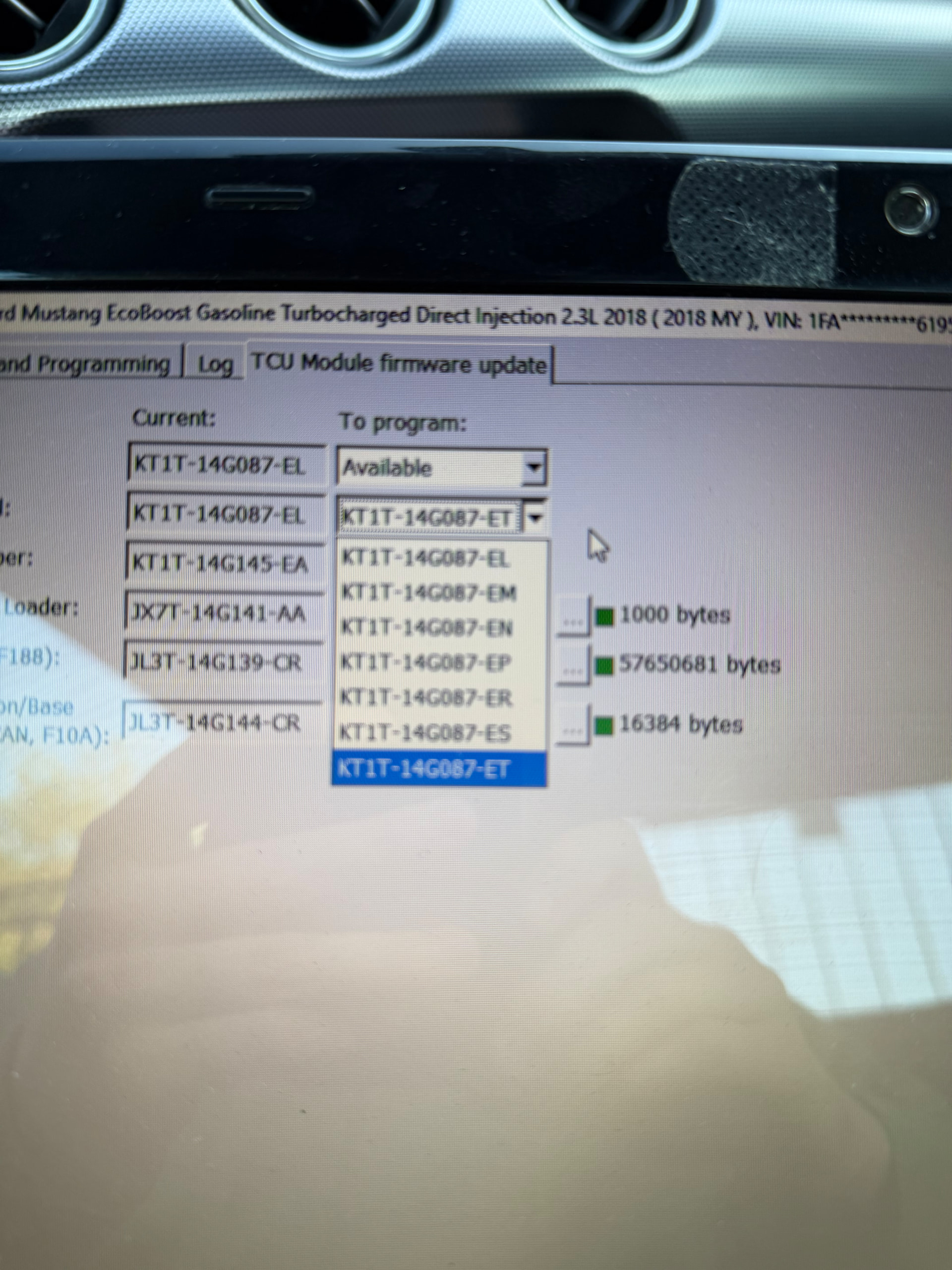

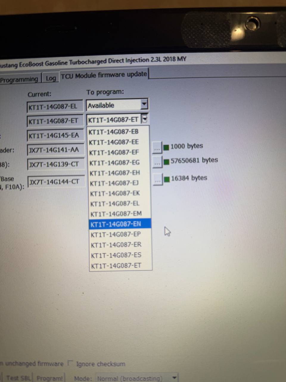

Can you explaing how should I downgrade to J -series? Available list in my Forscan is:
KT1T-14G087-EB to KT1T-14G087-ET. I upgraded to last one, but when I’ve tried to change it back to orginial KT1T-14G087-EL - nothing happened. 17 blocks of data and calibration level not changed.
I’m updating block outside the car “on table”, so at this moment it doesnt have antennas connected.

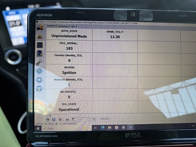

In car cellular signal is 130-140.
Tiu do not want to upgrade to a K series firmware. If you are on the firmware listed a JX7T you need to stay there, as you have the latest firmware for that series. You have no country or network identified by the TCU in your 2nd pic. Until you have that the TCU will not authorize.
So, the problem with TCU was that originaly it comes with JL3T firmware, and after I’ve updated it to JX7T it stopped working (guess because HS4 can line, mine Mustang doesnt have it, only HS3).

Cell signal fine, but still in Unprovisioned mode.

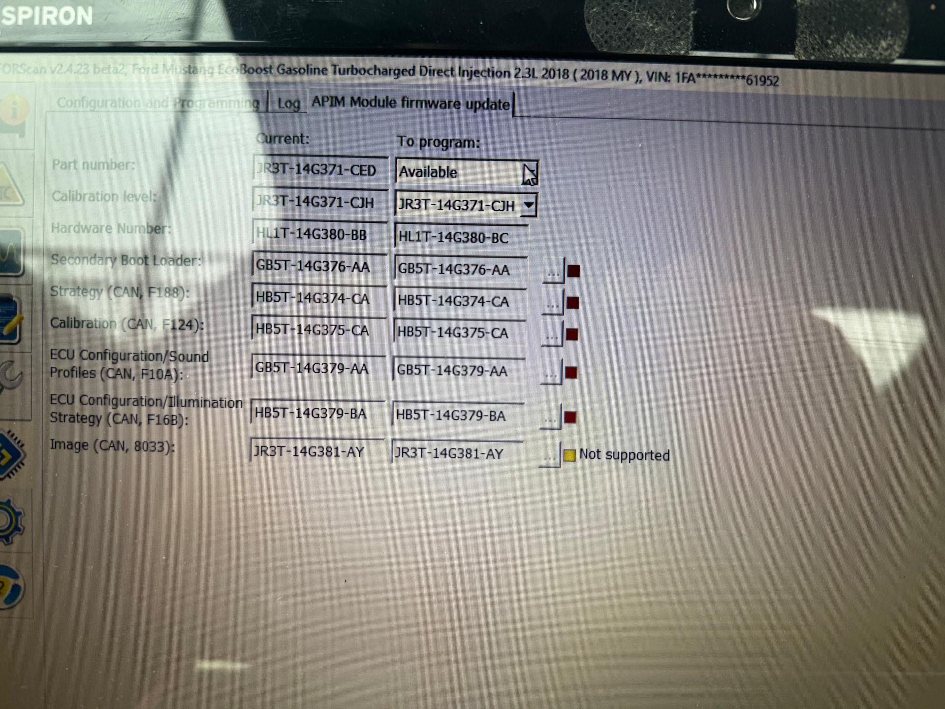

Maybe I need to do something with APIM firmware? This is latest available for my APIM
F150Chief told you this in the 10th post right before yours. He did not mention HS3/HS4 specificlly though why you could not use the K series Calibration.
Side note, this goes to show though why just updating calibrations to the latest one is not always a good idea.
