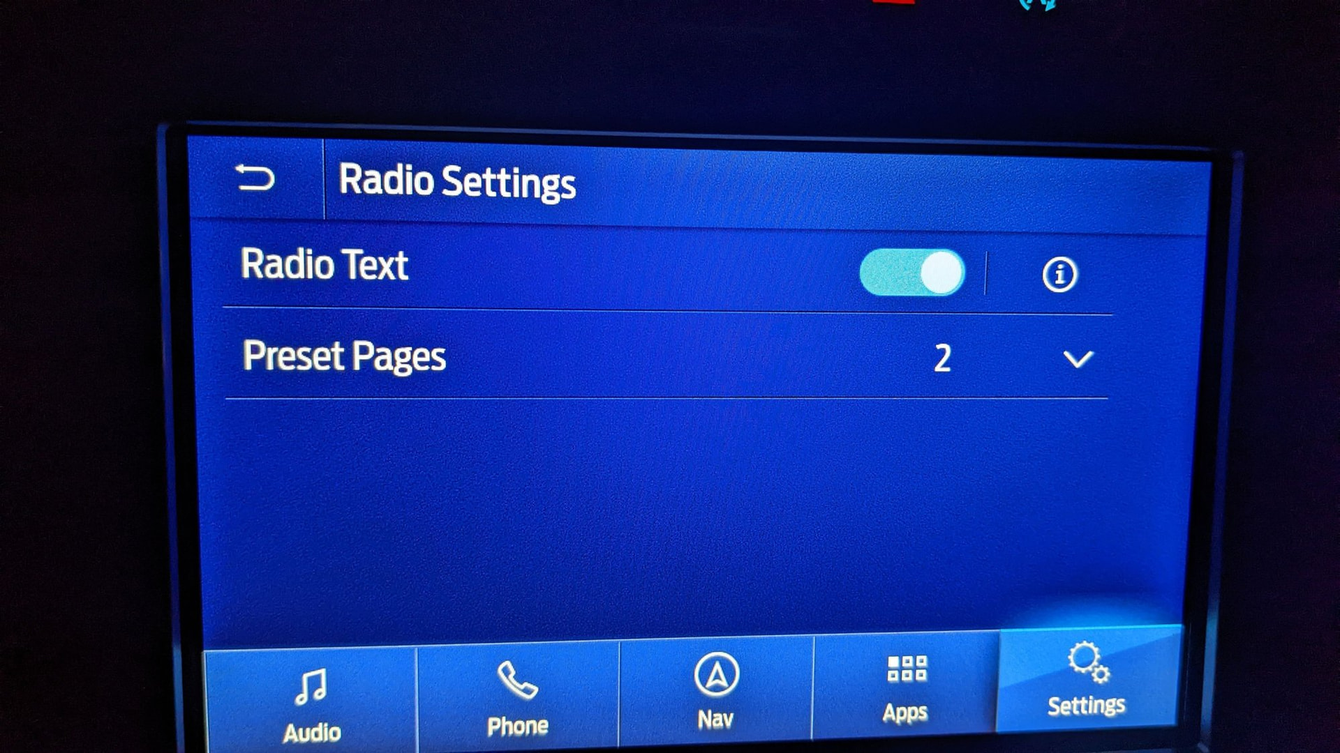

2020 Expedtion only 3 pages of Presets
I just traded in my 2019 F150 which had Sync3.4 the radio and SiriusXM had the ability to add up to 6 pages of 6 or 7 presets. My 2020 Expedtion only has 3 pages with no options available in the settings to add more. When I got the Expedtion it was on an earlier verision of sync but I did not notice which one. I did the automatic update and it updated to 23188.

Changing the number of pages requires making a back end change using ForScan, there’s not an on screen menu item for this.
On My F150 with 34188 there was a screen you could set the number of preset page between 2 and 6 and the steering wheel control arrows would scroll and you didnt need to use M to cycle between them
Your 2019 F150 is likely set up for Mixed Mode Presets, and your Expedition is set up as Autostore. You will need to make asbuilt adjustments in your APIM and ACM asbuilt info to change this, provided the ACM is capable.
