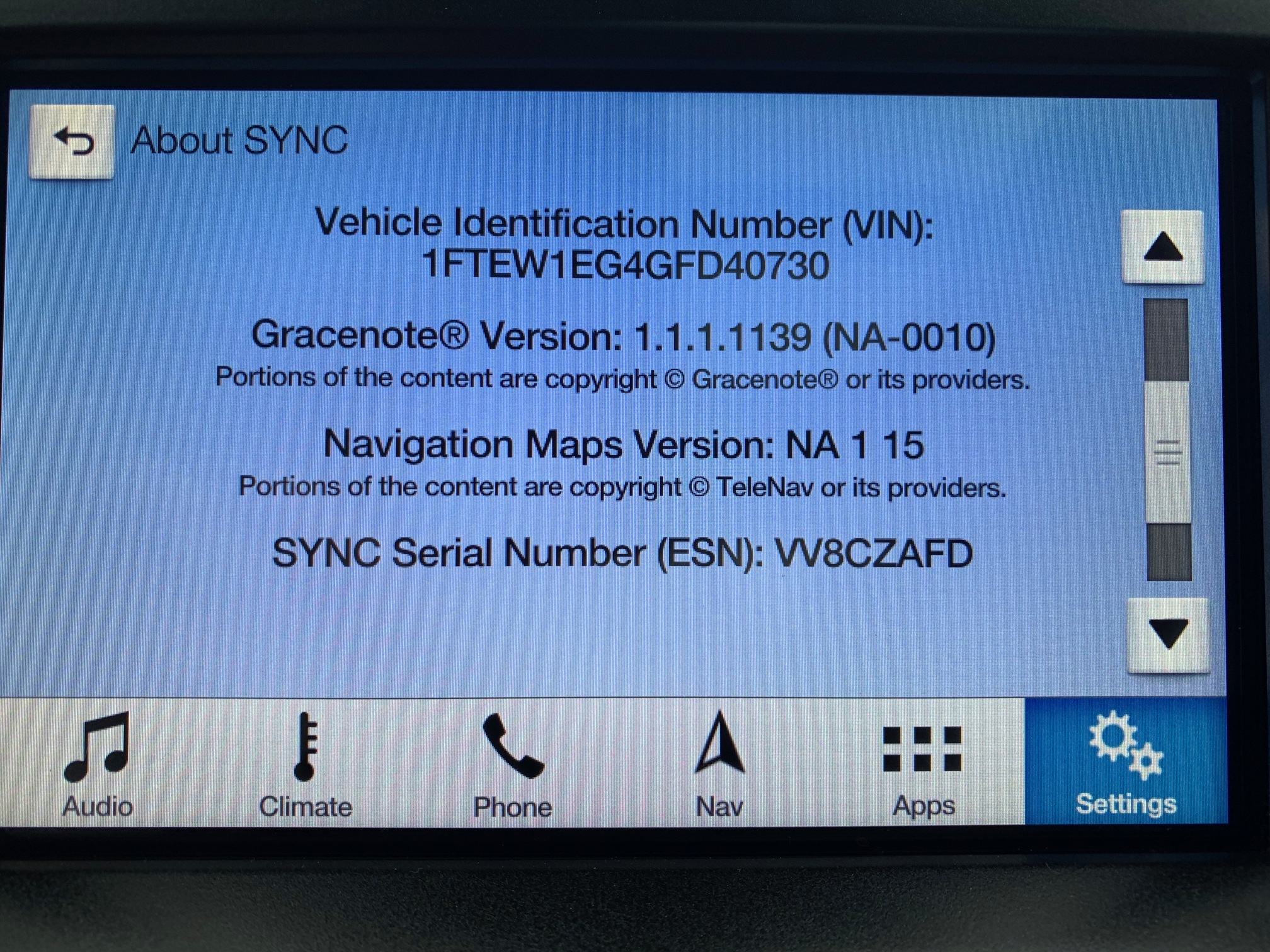

no its a NAV unit from the usa as per built sheet
Hmm interesting, in that case something else is up, the only real reason would be a bad USB but a fail at around 8-13 minutes is usually due to installing maps on non nav units.
