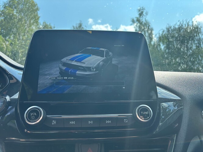

Also here is photo how it looks like:
Stuck on this screen, can’t get it to detect USB no matter what, there is power on USB ports and before update carplay, android auto worked just fine.

Thanks for info! I gave it a try, but unfortunately it didnt work, no reaction, still just getting the “Please Insert USB stick…”
Is there any way to fix it not using USB sticks? Like forcing something by FORScan?
I think it just can’t detect any thumb drive no matter what.
(Though there is power, phone is charging and few hours earlier USB worked perfectly fine)

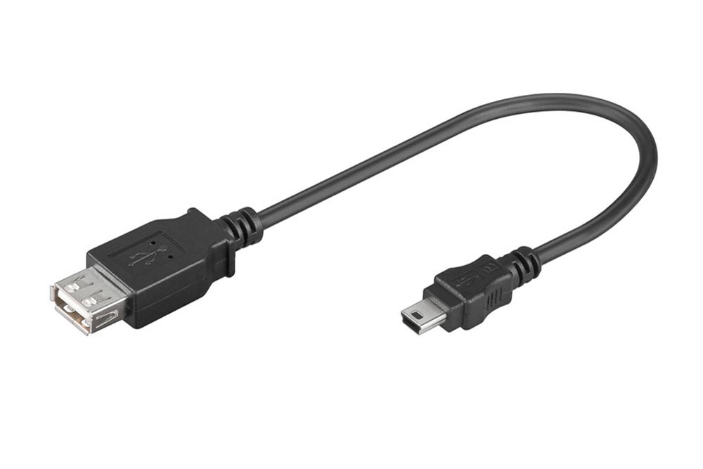

Okay, I finally FIXED it.
So i disassembled the car, got access to APIM
And instead of having car USB wires plugged in, I used this weird adapter
Then plugged my thumb drive into it, and it worked on first try.
After SYNC update was installed everything works perfectly, Carplay is working, phone is charging.
So I have no idea why it didn’t work but there is this hacky way to fix it if anyone would need to.
Congratulations, but you connecting that cable directly to the APIM is basically bypassing the part we said you should replace: the USB HUB.
