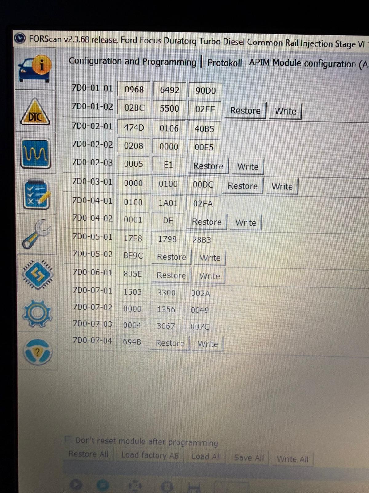

Hi.
Do you have forscan and an adapter?, if so share the APIM’s asbuilt seen through Forscan.
Has the unit even been serviced?.
About the interrogator log, was it created for 2.2 and 3.4 separately?.
Finally, and this is very important. Did you ever see “the mustang screen” with the progress bar and green screen at the end of the process?.
Thanks for the reply! No i did not see “the mustang screen” or the green screen. I have an adapter, need to see if my forscan license is still valid. As far as i know the unit hasnt been serviced.
So, what happened is that you plugged the USB in while on 2.2, you saw “installation in progress” (or something among those lines) and the unit booted into a black screen but with audio still playing ?
If so, have you created the interrogator log with 2.2 as your current Sync3 version in syn3updater?
Oh, I think you can use the free version of forscan for reading the asbuilt… license is required for more sensitive stuff…
Thats exaclty what happened. Yes i created the interrogator with the same settings( 2.2 ). But nothing happens when i plug it into the USB in my car. The screen stays black and backlit. I will look into getting forscan on my laptop rn.

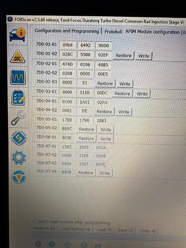

Sure, send a picture o screenshot of it.
Also, since you are on Forscan, share the APIM model read as well.
Hello, it took a while but i figured it out. I hope this is what you asked for.
I also did a “on demand self test” ot the Apim insinde Forscan, but there was no Error.
Yes, that was what I was asking for.
Question: when you start the car, do you briefly see any image on the screen?, the boot screen?.

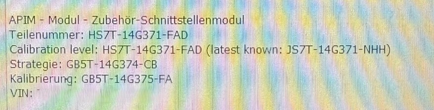

Here is the info about my APIM (i deleted the VIN). Why is there a difference in the latest known Calibration Level?

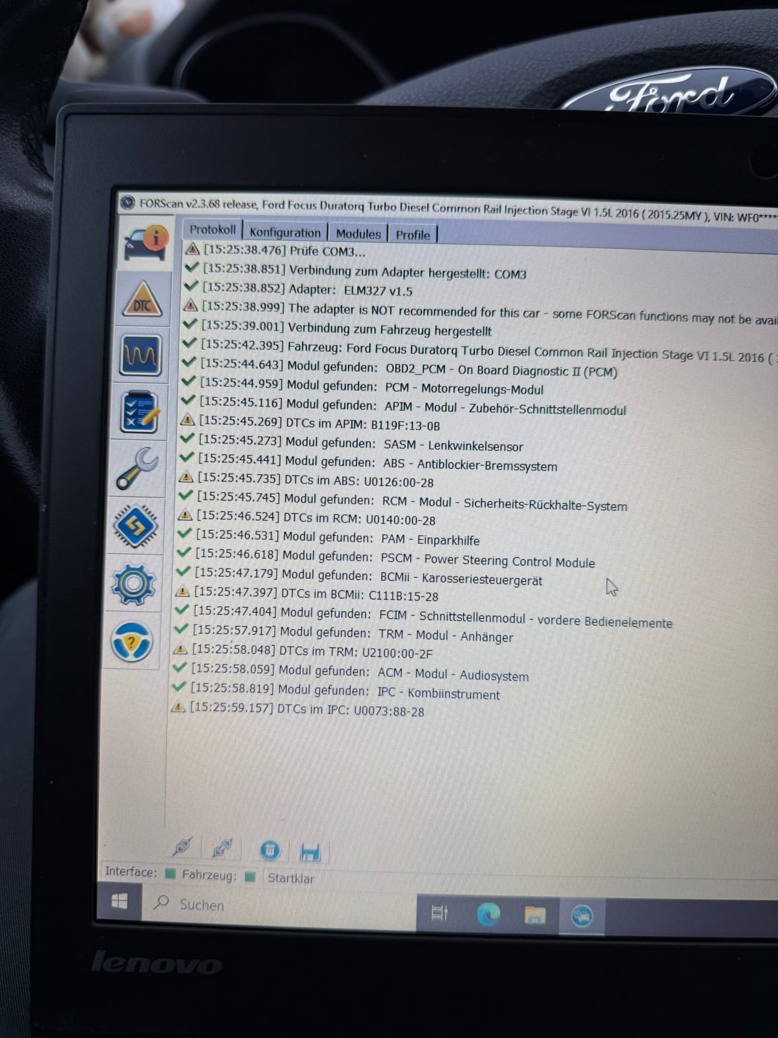

And here are a couple DTCs, maybe something is hinting at my problems.
Thanks alot for your help so far! i would be lost :smiley:
Those codes are all over the place… the APIM one is that you have issues with the GPS antena (open circuit), and the BCM that there are some issues with lights…
