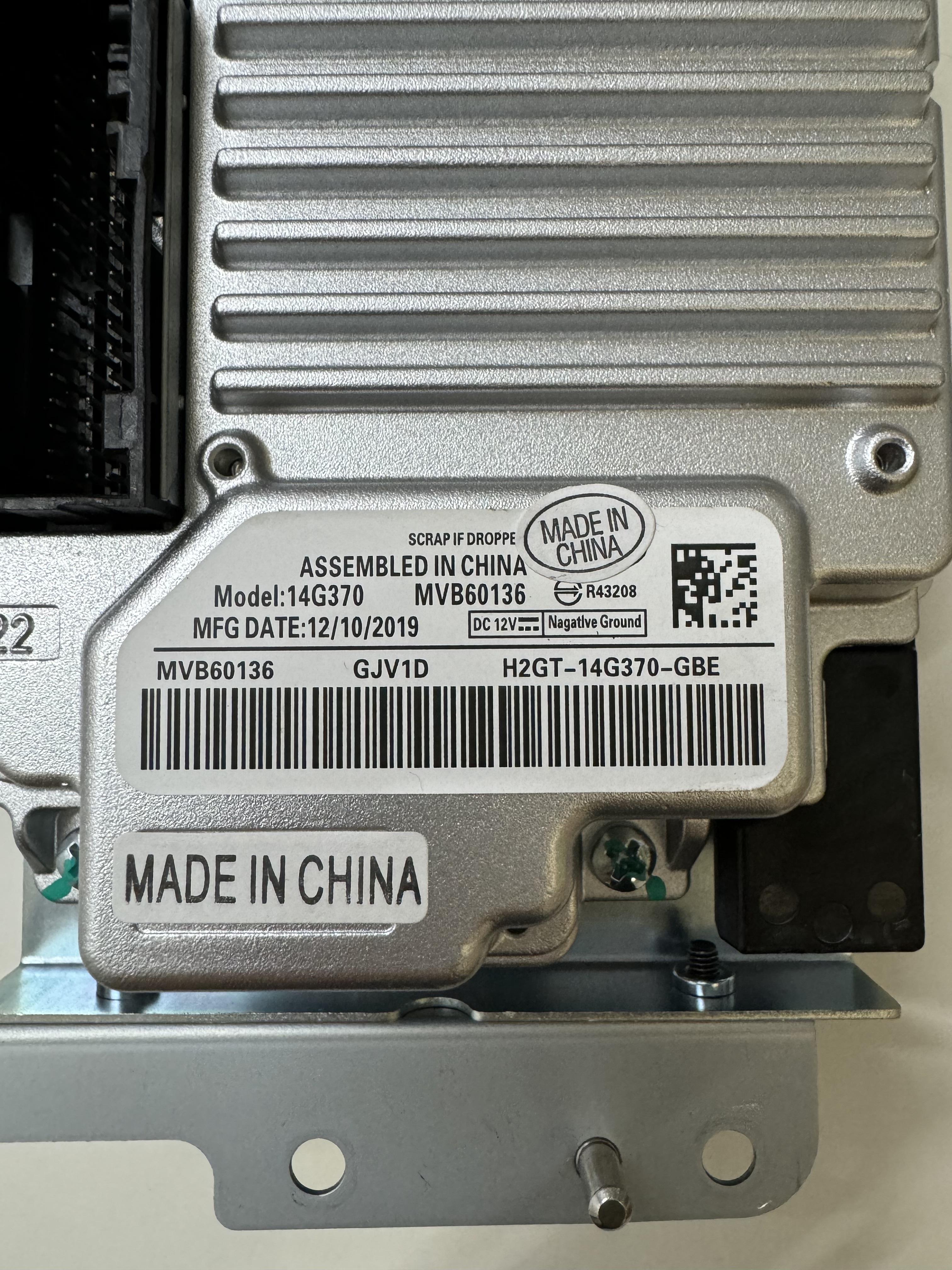

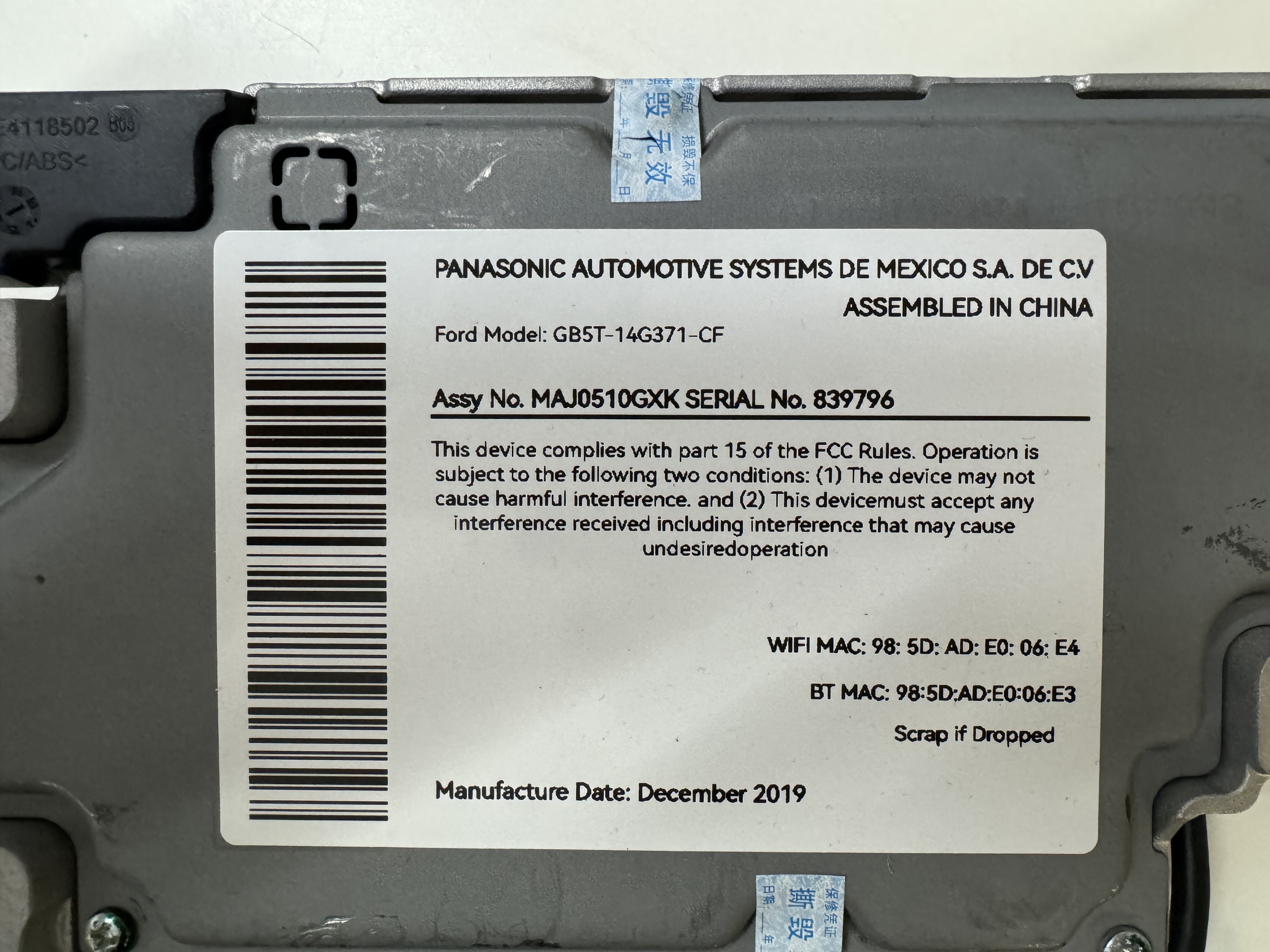

Are you willing to unmount the unit and share a picture of the sticker on its back?
Where did you source the APIM from?, China?

Ok, you didn’t take any pictures while receiving it or installing it right?.
We need to determine if the APIM is MY20 or not, or if it looks genuine.
Once you get the chance, provide the picture.
Also, when the adapter arrives, you will be able to read the APIM’s model as well.

There you go guys. @SaNdMaN @CyanLabs
It says December 2019
That does not look original…
I think you got a counterfeit or cheap China clone…
