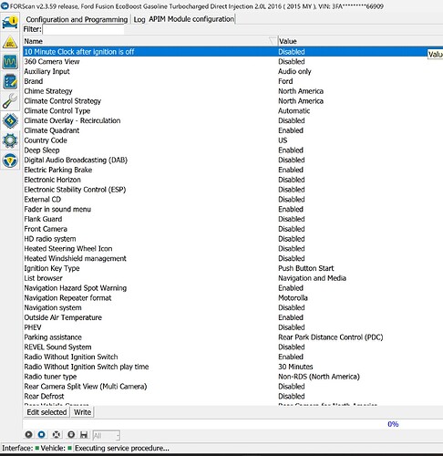

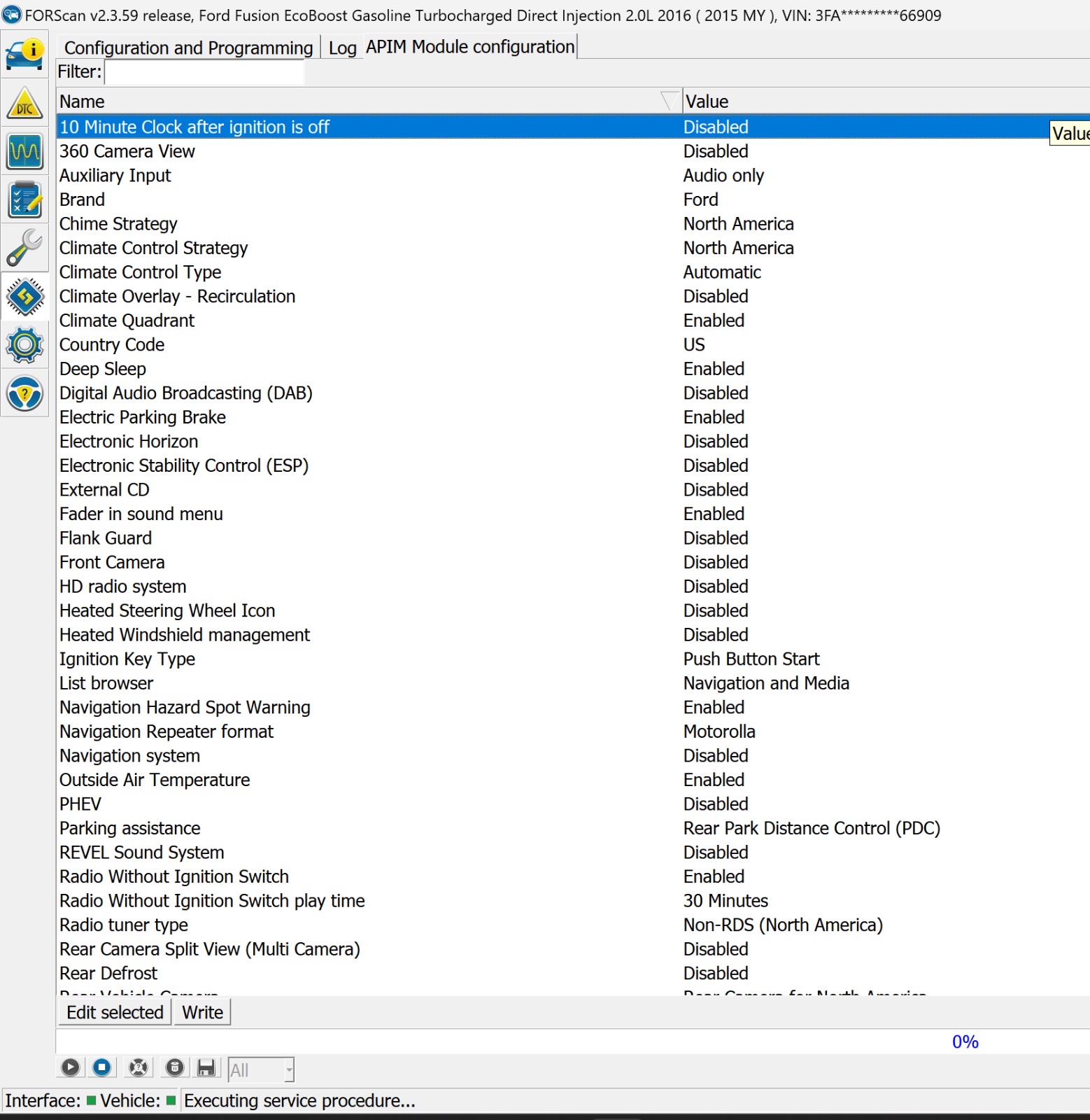

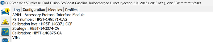

@SaNdMaN so I’ve received my Forscan cable and I am able to read APIM coding.
I can’t do a firmware update with it though. As it’s a cheap cable. I just bought another one that’s supposed to work.
Also it’s showing a DTC on APIM.
Code B108E Display
Additional Fault Symptom 4A
Incorrect Component Installed
That’s what it gives me.
I didn’t find where I can check APIM model though.

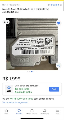

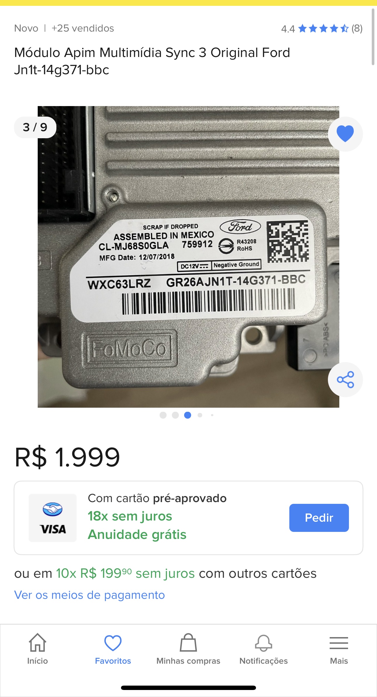

Does this one look genuine and compatible with my car? If so then I’ll buy it if I can’t fix mine…
Yes, that looks genuine. A J series like this would be from 2018.

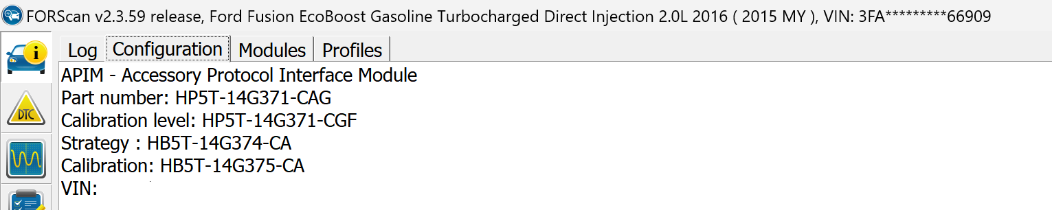

I was able to find out APIM part number.
Am I able to reinstall firmware though Forscan when I get the recommended cable? Even it’s a fake thing?
If it can be read, it can be written, no?
